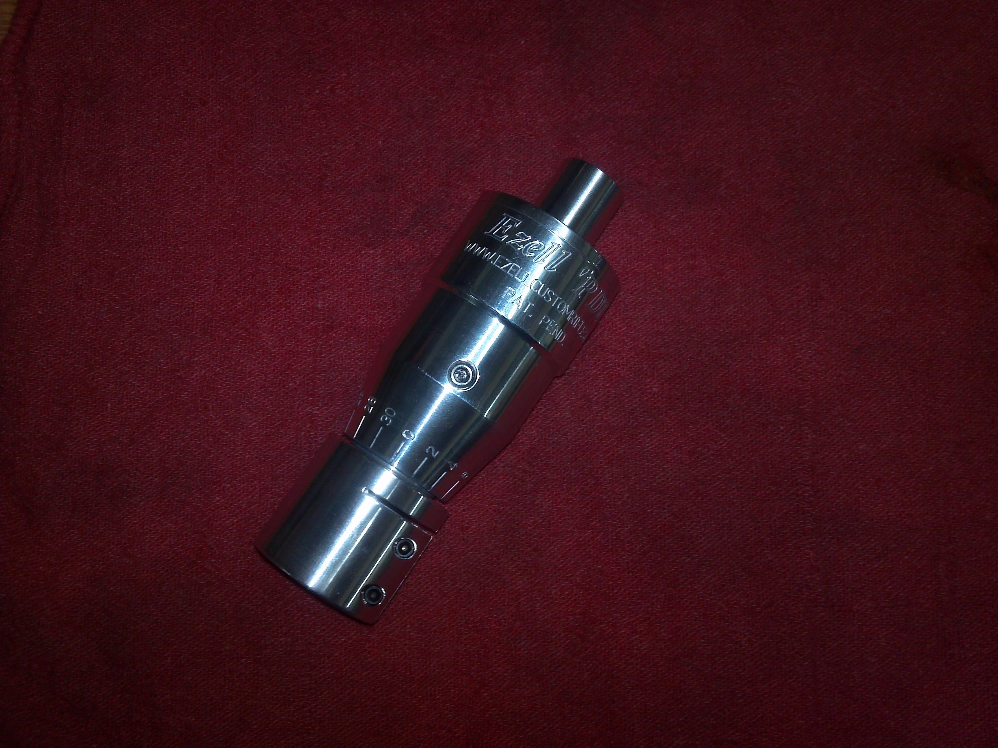

How many of you are using any kind of barrel tuner on your 22lr? I know that some shooting disciplines do not allow tuners or weights but for those that do, how many find them useful? I occasionally shoot in local bench rest matches near home. The clubs that hold these do not have a vintage rifle class. They shoot sporter class which is limited to 8.5 lbs and unlimited class which is well the mega-buck race guns with all the bells and whistles. My old vintage Win and Rem rifles are both too heavy to make the cut for sporter class so I find myself shooting an old factory stock vintage rifle in the unlimited matches. All the guns I see are using Harrell type or Fudd bbl tuners. Everybody claims they are worth the $. I cannot say other than most of them out shoot me. It is not that I shoot bad but I am new to BR and am still learning how to shoot in the wind with flags. The range where these matches are held is notorious for very wild winds. Swirling, gusting, tough to read. I have been reading up on tuners and PRx and have talked to Tony P about it and think it may be worth the trouble to try a tuner on my rifle. I called Mike Ezel and discussed his PDT tuners and decided to order one. In theory it will damp the vertical vibrations in the bbl as the bullet travels down the bore to the muzzle and limit the amplitude of the movement at the muzzle to tighten the groups in the vertical plane. This may also be able to compensate for minor variations in muzzle velocity due to ammo variance. Makes the gun less sensitive to ammo selection. It won't make bad ammo shoot well but it will make the rifle shoot better with any ammo. Wow.
Sounds peachy right? Or is it snake oil? We will see in a few weeks. Any opinions welcome but I really want to hear from those who have tried these devices. Good, Bad, Ugly?
Irish

Thanks Carter. May I ask which tuner you chose to try? I too plan to report the results of the Ezell tuner once I have enough data to determine its worth. I come from a background in harmonic vibration control in steel structures. Last winter I began designing my own tuner for both the 22 as well as my AR15 type rifles. Both were based upon the PRx data. I was hoping to find a tuner that would damp both in the vertical plan as well as the horizontal. Before I got very far, I found Ezell. His tuner used powdered tungsten to aid the damping process. This is similar to a long beam damper that I developed a few years ago. I intuitively see it as having potential. Rather than guess about it or use intuition, I figured I would try it. Will post results here in a few weeks.
