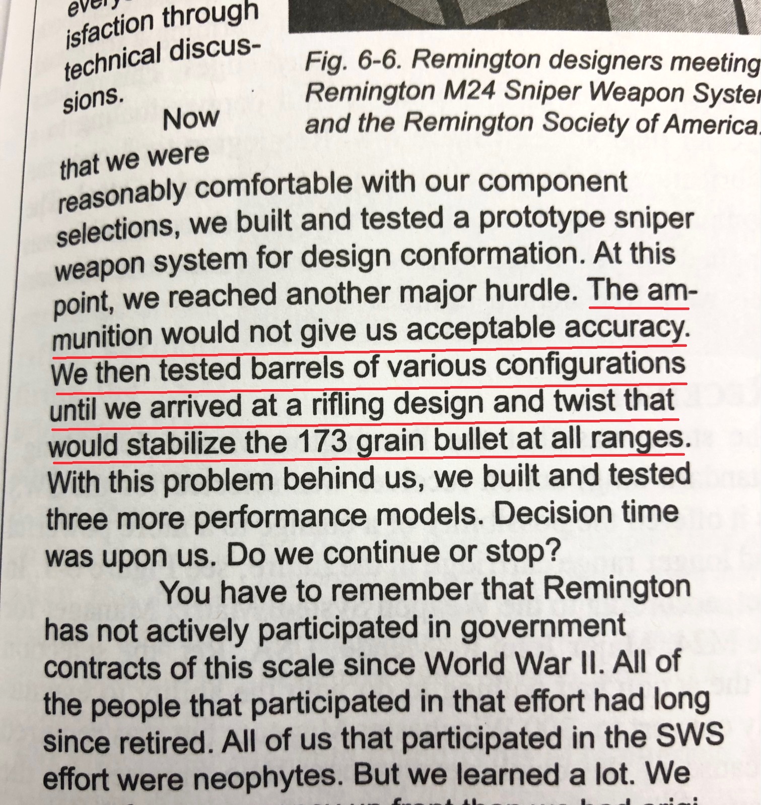

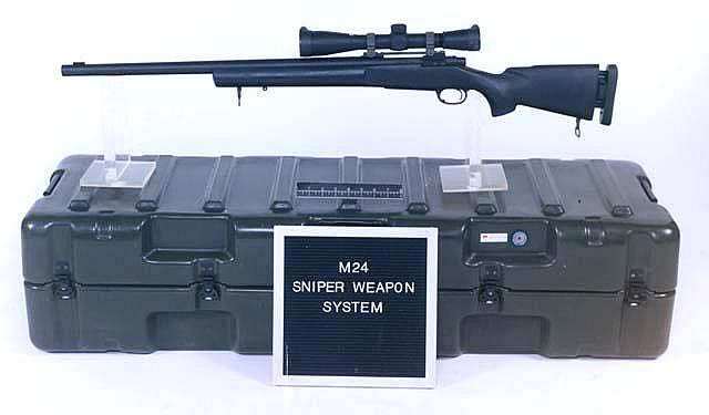

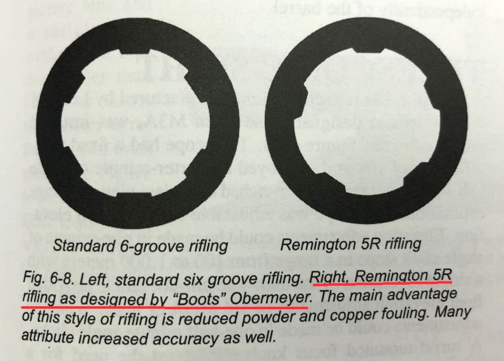

Attached is the history of the development of the M24's barrel circa April 1986 when the US Army's 'Market Research' statement was released, to the the July 1988 era, when Remington formally won the award. The twist rate was determined by formal testing back in 1986 of different barrels and twist rates, and Remington couldn't meet the Army's accuracy spec at first - but they settled on 1/11.25 w/ 5R rifling - which finally met the Army's accuracy requirements as outlined in the Market Research/RFI statement. It is also true that Boots developed the 5R rifling, and Mike Rock made the barrels for the 6 Initial Test Rifles and the 19 "First Article Test Rifles" circa 1987. I think Remington made all of the 'production' M24 barrels after the contract was awarded in July 1988. The Army received the first production 100 M24s on October 25, 1988.
Anyhow, hopefully the attached documents will explain some of that early history and the first 25 US Army trial M24s. Source of attached pics & info: Collecting the American Sniper Rifle 1945 to 2000, (2014), by Joe Poyer. (There are various errors in this book, but the section on the M24 history is from the Remington archives and interviews, and do not appear to have any errors that I can detect). Random last pic is likely from the 1988-89 era.
