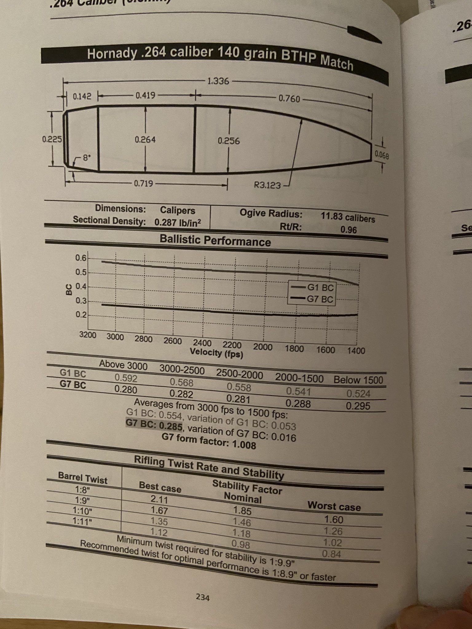

Hey folks!
So, I'm looking at a semi confusing scenario right now. I just took my first precision class and we spent a good bit of time on data gathering and ensuring we had quality data.
We zeroed, went over a Chrono, and went straight to 1,000 yards for trying. I was shooting a Hornady 140 bthp, and we slid my g7 bc down to .255 from .285 to get the data to line up. We confirmed at 1,000 and in and I was waterline at all distances.
I walked out to 1350 and made solid impacts there.
The next day, we had a bit of time and I took a poke at the 1 mile target. Took 10 rounds to get on, and then hit 5 in a row. The odd thing, is that I was hitting 2 mils high of trued data.
So, looking back at all the data after class, i cannot get my data to line up for both what I observed at 1,000 and in with perfect data, and what I observed at 1 mile. I'm either perfect at 1,000 and then give too much adjustment at 1 mile, or I'm good at 1 mile and I will impact low everywhere else. I've played with the BC, and then played with MV, and can't get them to line up.
I've used AB mobile to confirm data to 1,000, and used 4dof and changed the drop scale to 1.06 to line up with the 1,000 yard data. Both calculators give too much dope for 1 mile.
Has anyone see this before?

Agreed, the change in BC is large. But, it didn't worry me too bad as it is a 1.06 change in the Hornady app for the same output, which is within their scope of adjustment. But then neither would give me the impact I saw at a mile.
I know you can use Dsf in the kestrel, and it was .93 at Mach .854. does that seem reasonable?
I was maxed out on the scope. I had like 18 Mils dialed and held the last 7. The scope went to 19.5 but I went back down to 18.
I have tall target tested this scope but only to about 10 mils, and everything did look good.

There are two things that would I would suspect the first one being your BC from what I read about the changes you made it sound like you were running 1BC which is only an average and may not work at all distances you need to try running a custom curve or using an app that will allow you to build your own I like the Shooter app it lets me do that, Also not all scope track true the Shooter app also has a scope correction factor that allows you to true you’re dope when dialing up the scope if it does not measure correctly doing a tall target test can give you an idea of the accuracy of your scope tracking as well try running these multiple BC’s from Bryan Litz his book ballistic performance of rifle bullets volume three see if that helps first then check your scopes tracking
At this point I'd need to see your complete set of inputs for both days.

I was able to recreate the same exact data by adjusting MV. I have a feeling my ammo was baking in the sun before chrono, and that's why I had to true so badly. I've shown every scenario below, from recorded impacts, to trued data, and my attempt at rebuilding the data without using very large BC changes or DSF curves.
Original MV and BC: 2674 fps, G7 .255 adjusted. DSF at Mach .854 of .93
Adjusted MV that matches above data set: 2630 fps, G7 .285 non adjsuted, no DSF truing
Environmentals:
25.17 inhg
80.5 degrees F
40N
DOF: 135 degrees
7300 Density Altitude
Recorded Data, confirmed impacts
283 - 1.0
365 - 1.7
415 - 2.1
543 - 3.3
625 - 4.2
1,000 - 9.2
1348 - 15.0
1743 - 24.7
Data at 2674 g7 of .255, no DSF applied
283 - 1.0
365 - 1.7
415 - 2.1
543 - 3.3
625 - 4.2
1,000 - 9.2
1348 - 15.9
1743 - 26.9
Data at 2674 g7 of .255 DSF applied
283 - 1.0
365 - 1.7
415 - 2.1
543 - 3.3
625 - 4.2
1,000 - 9.1
1348 - 14.9
1743 - 24.7
Data at 2630 FPS, g7 .285. Theory that ammo was very hot when chronoed.
283 - 1.0
365 - 1.7
415 - 2.1
543 - 3.4
625 - 4.2
1,000 - 8.9
1348 - 15.0
1743 - 24.8
