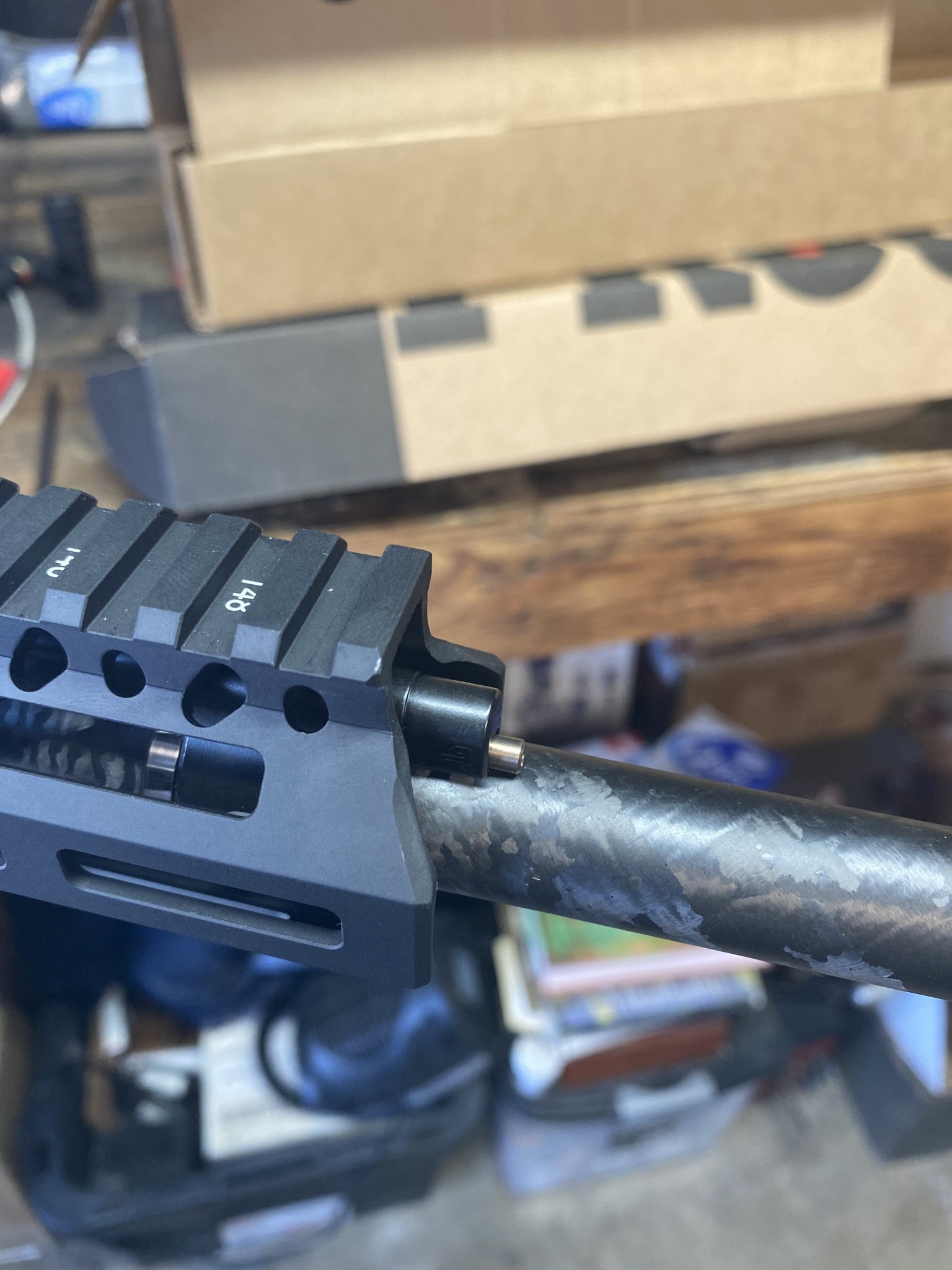

Thinking about putting together one of my ARs in 6 arc using an 18” proof carbon barrel. The rail I have is a BCM mcmr mlok which is pretty slim, I doubt theres any problem fitting the barrel in there but what about an adjustable gas block? I just got my flow 762 approved yesterday but usually run adjustables on all my rifles. I also have a JP SCS with standard weights for it.

I'm running a 20" Proof carbon under the 15" MCMR with an Aero adjustable block. You may need to take some material off the threads on MLOK attachments depending on where it is on the handguard/barrel.

That’s not a big deal I have to do the same on my Christensen with a carbon barrel and slim handguard. That’s been my coyote gun for a few years now.
