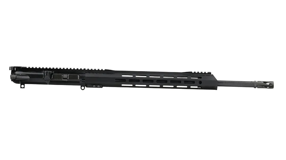

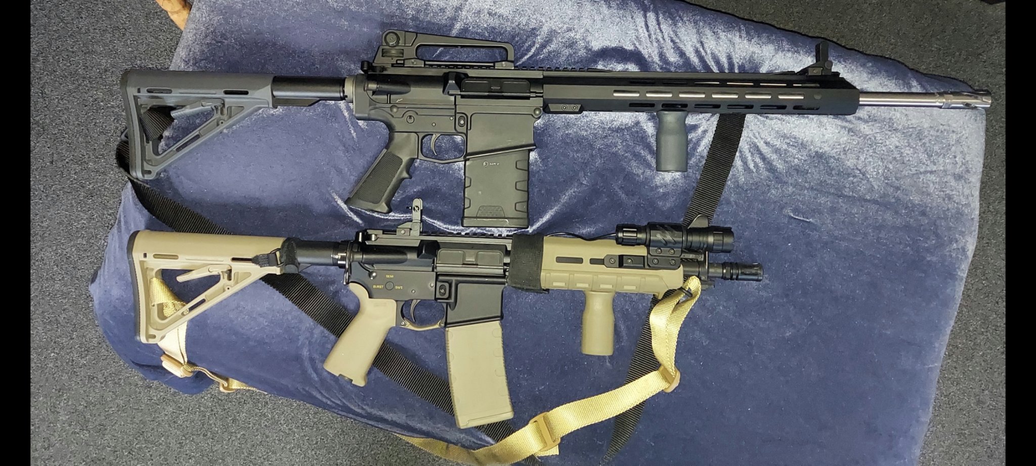

BCA builds an upper with a nitrated steel barrel ( 20" ) in 7.62x51.
This rifle will be assembled as a U.S Navy MK 11 type Mod 0 clone.
Has any of you assembled an AR10 rifle using this upper? Trash or Treasure.

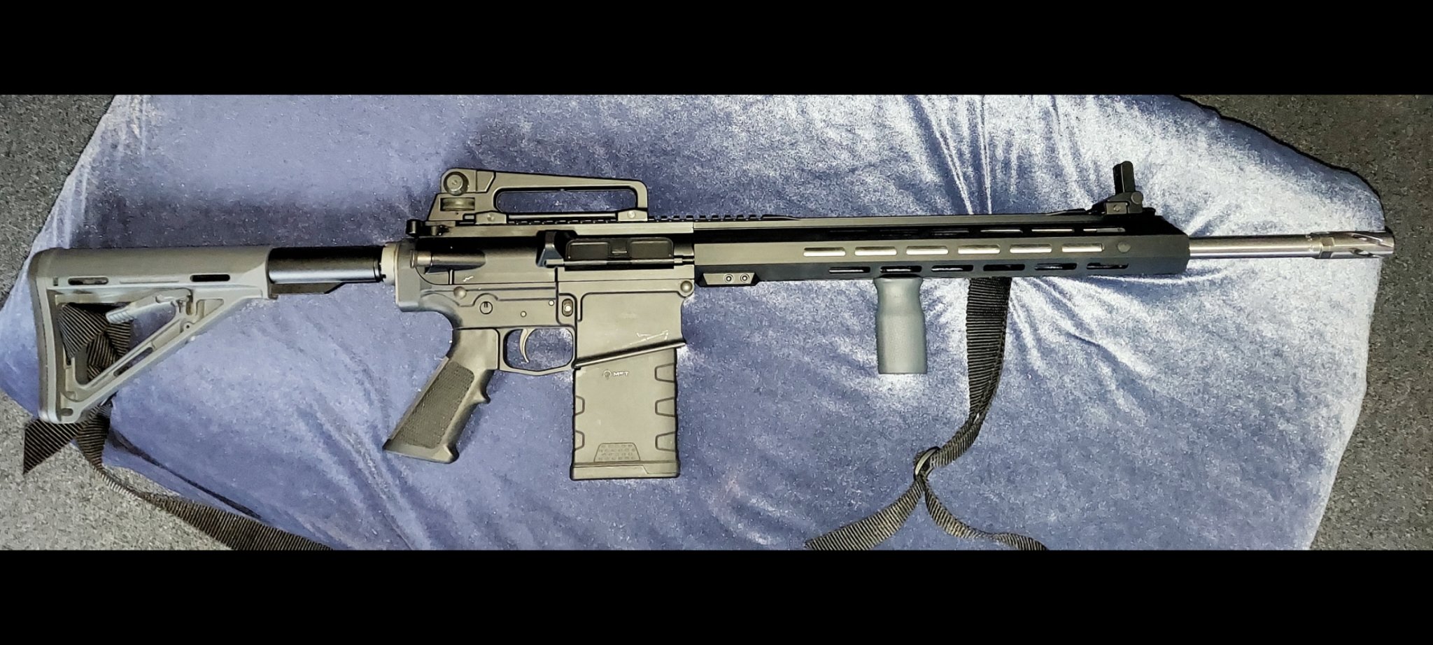

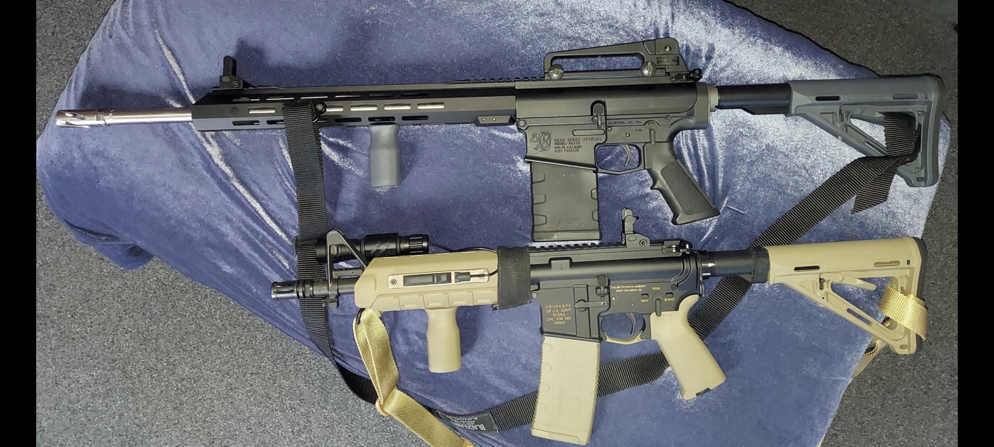

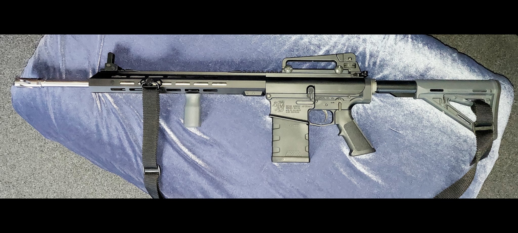

I took the rifle to the range for the first time. I had four types of M80 ball to try out.
1st was 20 rounds of Pakistani 1990 made ball, 2nd LC 1998 Ball, 3rd reloads of WC846 with147 grains M80 Ball USA made, CCI #34 primers
and the 4th 2023 Federal M80 Ball type for Police.
I brought clamp on open sights and several scopes from 4 power t o12 power.
The initial test was the open sights at 200 meters. The front sight is too tall for 7.62x51 and the rounds fired impacted at 100 meters with no adjustments left.
The first scope was a Burris fixed 12 power with a quick release mount for the Picatinny upper receiver mount. The scopes windage would not respond to any adjustment and wandered horizontally. The rifle did seem to want to shoot accurately.
The bore was cleaned after every fire shots to help break in the nitrated steel 20" heavy barrel.
AR550 target at 200 meters.
15 shots with Burris scope that was replaced.
The last scope tried was an ELCAN M145 scope with the 7.62x51 reticle. Several rounds were fired to adjust zero followed by 25 rounds on target. All shot fired were from the prone position, no sling.
I run a shooting club where we shoot from 200 meters out to 1,000 yards. This month will be our yearly Turkey -Shoot at 385 meters.

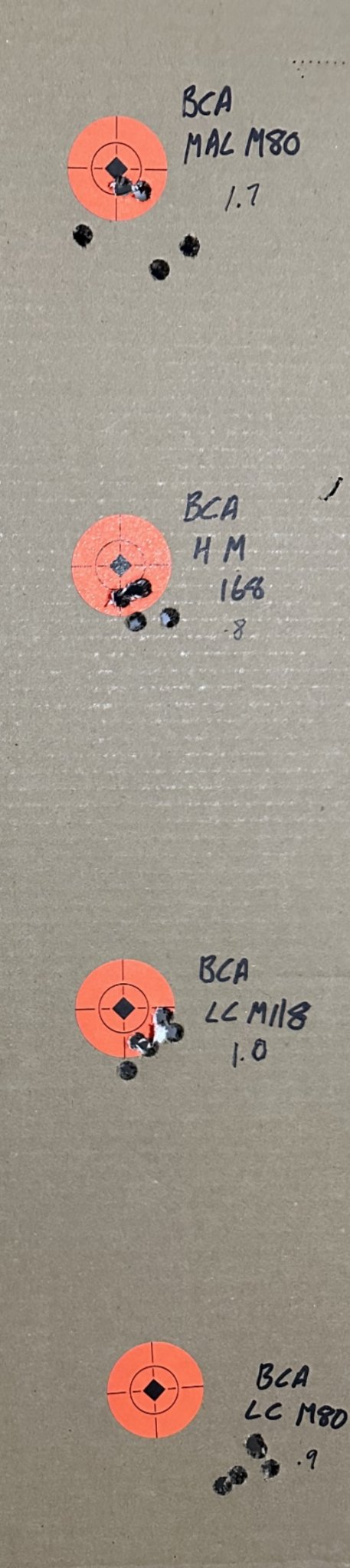

I took the rifle over to the firing line and was able to hit the turkey 8/10 shots with the wind blowing two shots off to the right.
The final target using all of the types of M80 ball. You can see the tight groups of the brighter dings where a total of 25 rounds were fired.
I did not try the M118 type loads yet as I wanted to make sure the rifle cycled as it should. There was not one FTF or FTE.
Magazines tested were USA made steel 20 round, PMAG 20 round and HEXMAG 20 round. The steel mags notch for the mag catch is slightly too low preventing the bolt from stripping off the first round of ammo.
The two plastic mags worked flawlessly.
Once the barrel is broken in I think it will be a good shooter with quality ammo and better sights / glass.
I was only expecting MOM ( Minute of Man ).

I shot my BCA AR10 today, looking to see which ammo it prefers. My testing has shown me that most of the MilSurp M80 Ball is worse than TulAmmo for accuracy. Zero malfunctions. It likes Hornady Match and Lake City manufactured M80 Ball and M118 BTHP.

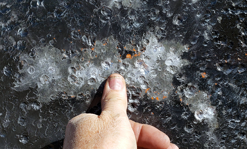

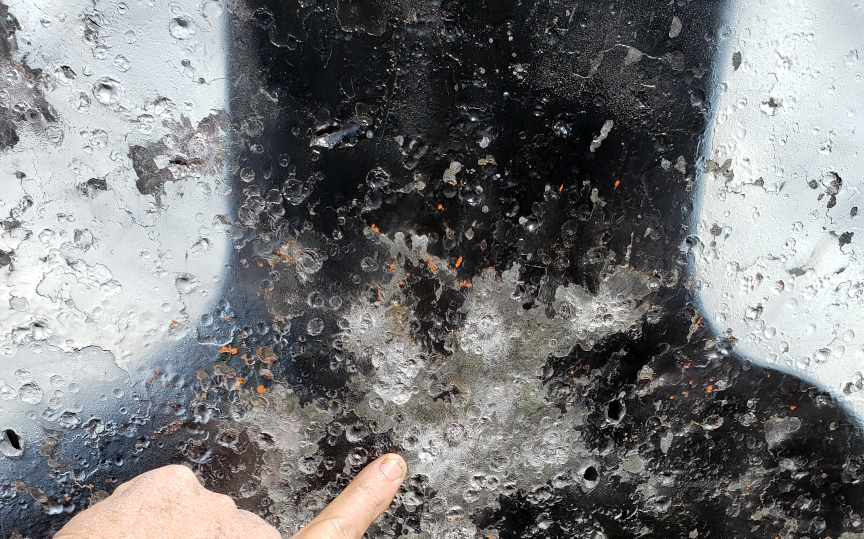

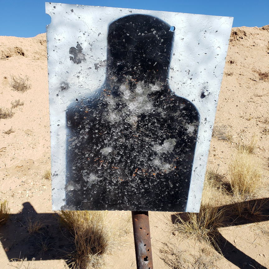

Well I'm a little late to the party.... But I have one of these built with a stainless steel 20 inch barrel. AR-10/AR-308.
I've had mine assembled now for just under a week. I've put approximately 200 rounds downrange at various distances. 50 yd all the way out to 600 so far. And it's my personal opinion based off of my experiences with my own that they are very accurate. Built beautifully right here in the USA. And so far I've not had a single failure to feed failure to eject or anything of the sort.
Mine weighs 11.2 lb in its current configuration as shown in the image.
Definitely not trash. So many people talk shit about bca. Well I'm telling you right now they are right up there with the rest of them as far as quality and dependability.
Upon close inspection.. with the upper and the lower that I put it on.. there are almost no tooling or machine marks to be found.
And for the price.... I am truly amazed. My upper and lower cost $565 including shipping.
Again I'm a little late to the party with this one.. but that's my opinion based off of my own experience.
The attached images show the BCA and PSA 10.5 in ar-15.
The 308 is a monster!

Can you talk me through how you sighted it to hit out to 600 and what size the target was?
What I’m seeing there intrigues me for your sight set-up.
There's nothing special about it. I had the rifle on a rest that allowed me to sit. A friend of mine had a spotting scope of some sort. The target was 48 in by 48 in neon orange. Behind that was I don't know 20 or 30 ft I'll just natural hillside that had been dug out for gravel.
I was getting close without his help but then it was getting kind of agitating he started walking me in and that's that. There's no crazy special firearm voodoo. If he weren't there helping me I don't know how long it would have taken.
Once he walked me in.. then I started hitting it on my own.
Now when I tell you that I hit that Target at 600 yards I'm not even going to say that I was sub MOA or anything like that. Not at those distances. Not without a scope.
Let's just say if there was an entire platoon of individuals down there I probably would have hit every one of them more or less accidentally than intentionally. 😂
I do have a 1-8x28 SFP LPVO is that I I'm going to put on it the next time I go out with it. And I'm going to go back to that same spot.
Is there a way to post videos on this particular website/forum? I have a couple of cameras I wouldn't mind setting up and if I can share the experience on here I'll be glad to do so. If not.. I'll just leave my YouTube channel info here.
But yeah there's your answer. It's not Kentucky windage. It's hillbilly windage. 😂😂
