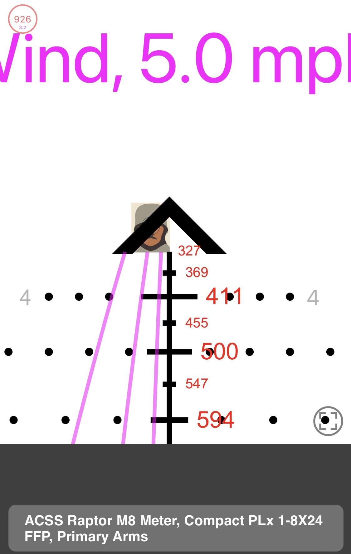

Expound please! Just curious as sometimes I don't know what I don't know. I like the chevron on the 1-8, didn't like it as much on an MVPO.
If it works for you, that’s great.
Basically it boils down to this:
- The “infinitely small” aiming point can also be infinitely ambiguous in practice. Unless you take the time to make sure you’re using the exact point. It’s easy to align quickly in windage, but not as much with elevation.
- In the 200-300 yard/meter range, especially with some wind, it can really start to obscure targets. Or be an ambiguous aiming point off the side of the chevron slope.
The chevron came about to be an easily identified reticle when using the bindon aiming concept with 4x in one eye. But that’s been proven to be horribly ineffective past bad breath distances unless you take the time to let your brain identify the magnified target instead of your non-optic eye image. But if doing that, it defeats the point of BAC and you no longer need a large aiming point.
The parallax when using the target image with your left eye and just reticle image with your right when there is a disparity in magnification gets off target fast. And without needing to use the bindon aiming concept anymore with the proliferation of red dots and LPVOs, the need for such a large and prominent aiming point on the reticle is also not needed. You can go back to using more precise aiming points that don’t occlude as much of the target. Crosshairs (4 or 3) bring one’s eye to the precise aiming point much faster than a chevron, for most anyway. I realize some will always prefer the chevron.
If you notice, all the newer military optics stopped using the chevron. The USMC TA31 RCO ditched the chevron. 6x machine gun ACOGs started to ditch it too. VCOG, Sig LPVOs, all gone.
