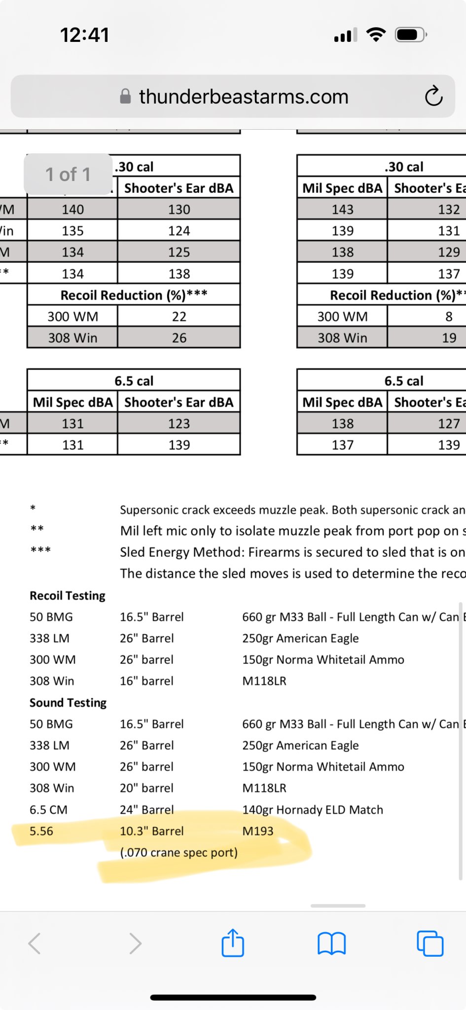

A bit off topic, but what’s always confused me is with 556, why is the Ultra 7 the quietest of all current TBAC cans? (Shooter’s ear)
Not much quieter, but even if they’re all dead even it’d be weird. PDF attached or go to the link.
There must be some typos on that sheet or the 5.56 is a sbr gas gun... They have a 6.5 Ultra 5 listed at 138 SE dba and 30 cal Magnus listed at 139 SE dba. I own both of these cans and have shot them both on 223 bolt guns and they are dramatically different(Magnus being much much better).
Reactions: carbonbased
The 5.56 is an sbr with a .070 port
