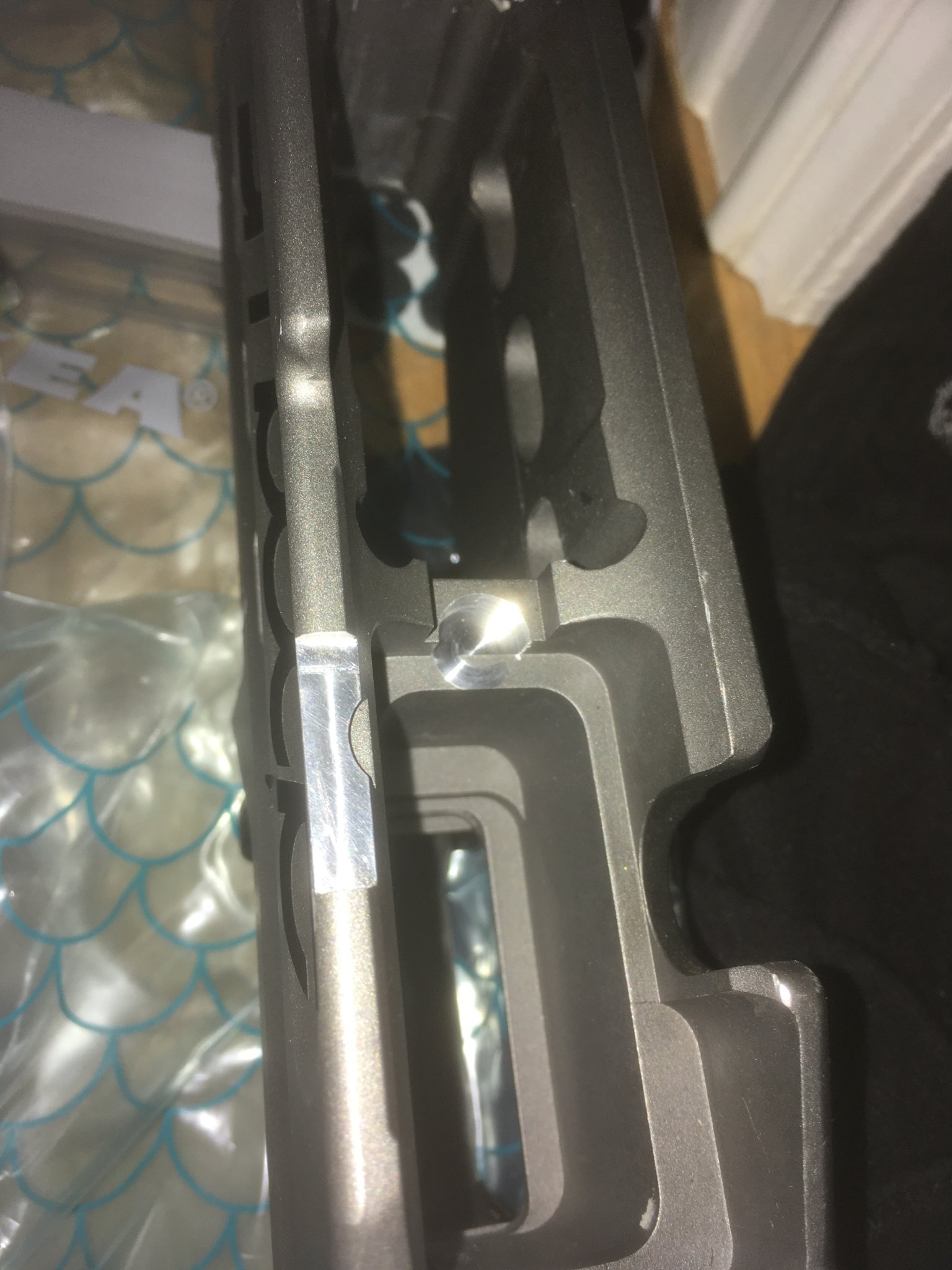

I just bought a used mpa that the seller neglected to say was bedded. I have not received the action that is going in that stock. How likely am I to have to redo the bedding and how much of a pain is it?
It is a rem700 action
Do you know what action it was bedded for?
Will ask tomorrow. He also modified the side and drilled a hole as seen in pic below.
I will be using this on an impact precision that is on the way.
