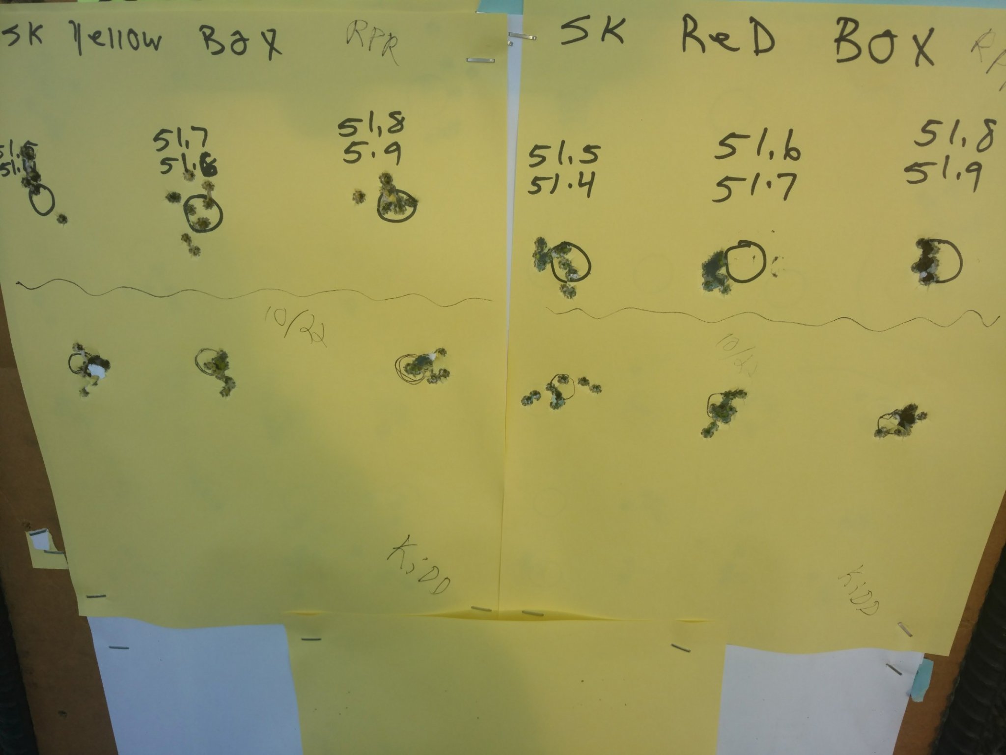

Finally figured out how to post pics, had to down load a photo sizer..
These are groups from e.r. shaw barrel
And underneath is kidd barrel on my 10/22 it was kind of windy hope this help

What had happened was i was getting good groups with sk red box and yellow so I weighed them to see uf there was a difference, and not as much as I thought.
