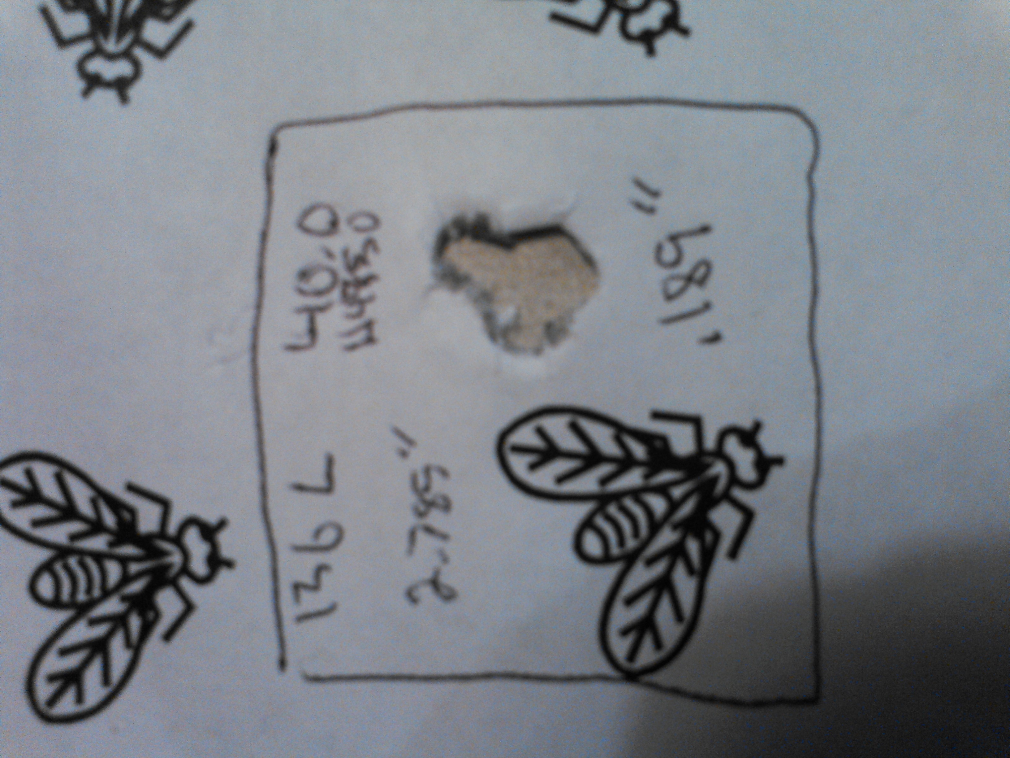

Maybe. I'm open to the possibility. Maybe stock design that I'm not used to. I will say I have much more consistent results with other rifles, even ones that weight half of this one in the same cartridge. I did relieve the barrel channel a little more and also found the bolt handle was touching the stock, so I relieved that area also. See if that helps.
Is there something in particular you see I might be doing in regards to shooting just from these results? This was shooting off a br front rest and rear bag.

But in analyzing your shooting, the first and third pics show significant horizontal stringing. This could be a number of things including NPOA, trigger control, shoulder position. The fact that you are also showing vertical "flyers" indicates you may have some positional issues with the stock in your shoulder or breathing. Again, have someone else shoot the stock for you and see there results.

When I don't shoot groups like what is pictured above, I can only blame myself.
Well after relieving some area around the barrel and the bolt, changing the torque to 65 and 45 (was using 65 and 60), and paying better attention to technique, flyers were eliminated. This is 61.8 grains of RL17 under a 215 Berger Hybrid running 2925. I would say there is no need to bed :) Not sure what made the difference, I think a little of both the clearance and paying better attention to technique (firmer hold and constant pressure on the shoulder). On a group similar to this with another load I had one shot with less pressure on the recoil pad that was about 1/2 high from the rest of the group, so I could definitely tell that caused a vertical flyer. Thanks for all the advice, even though my original question never got addressed, except for partially by Chad. BTW, this was a LRI group buy Remington 700 chambering job, so hats off to LRI for a wicked accurate chambering.
5 Rounds:
5 Rounds:
What cartridge?
