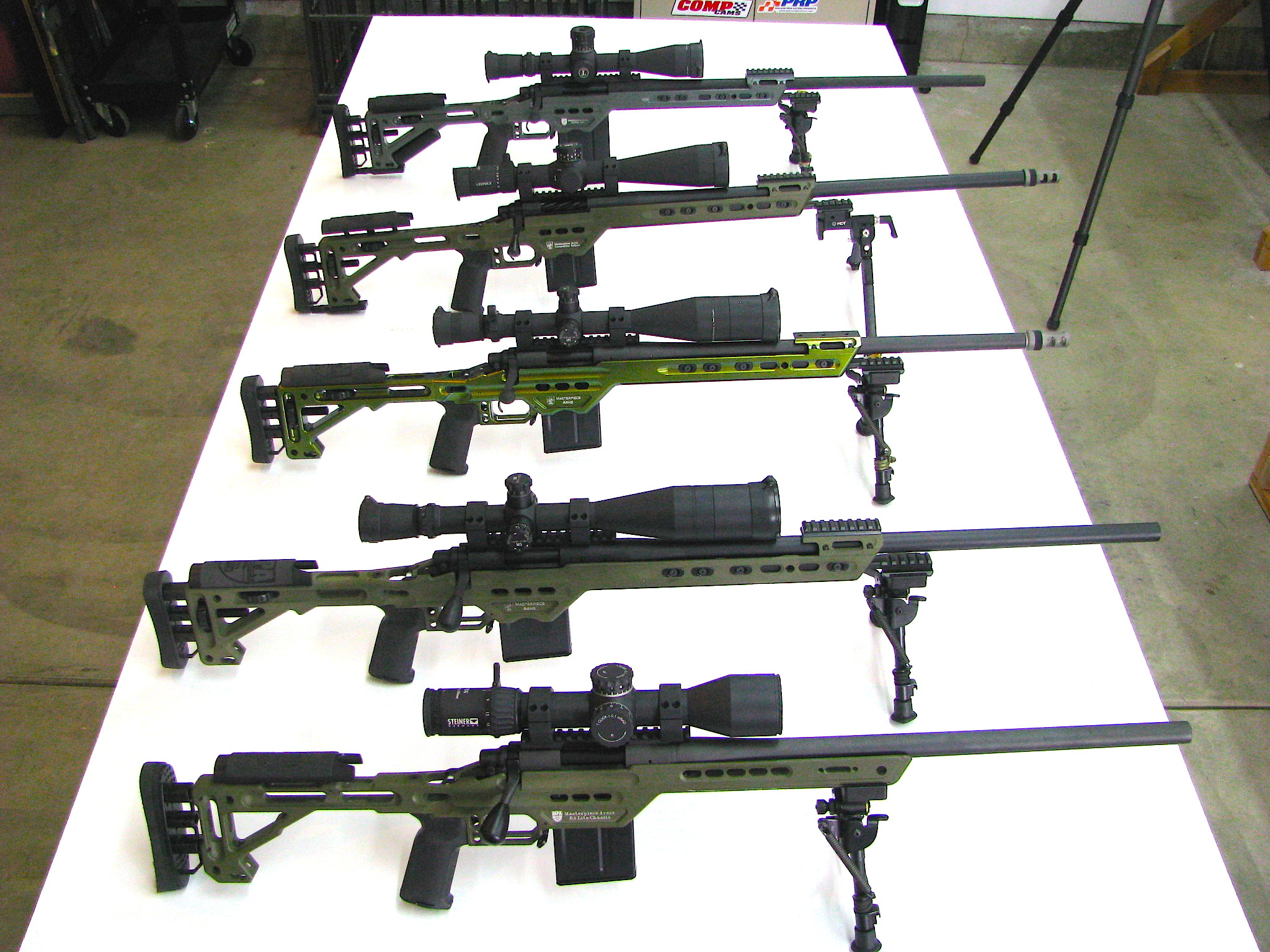

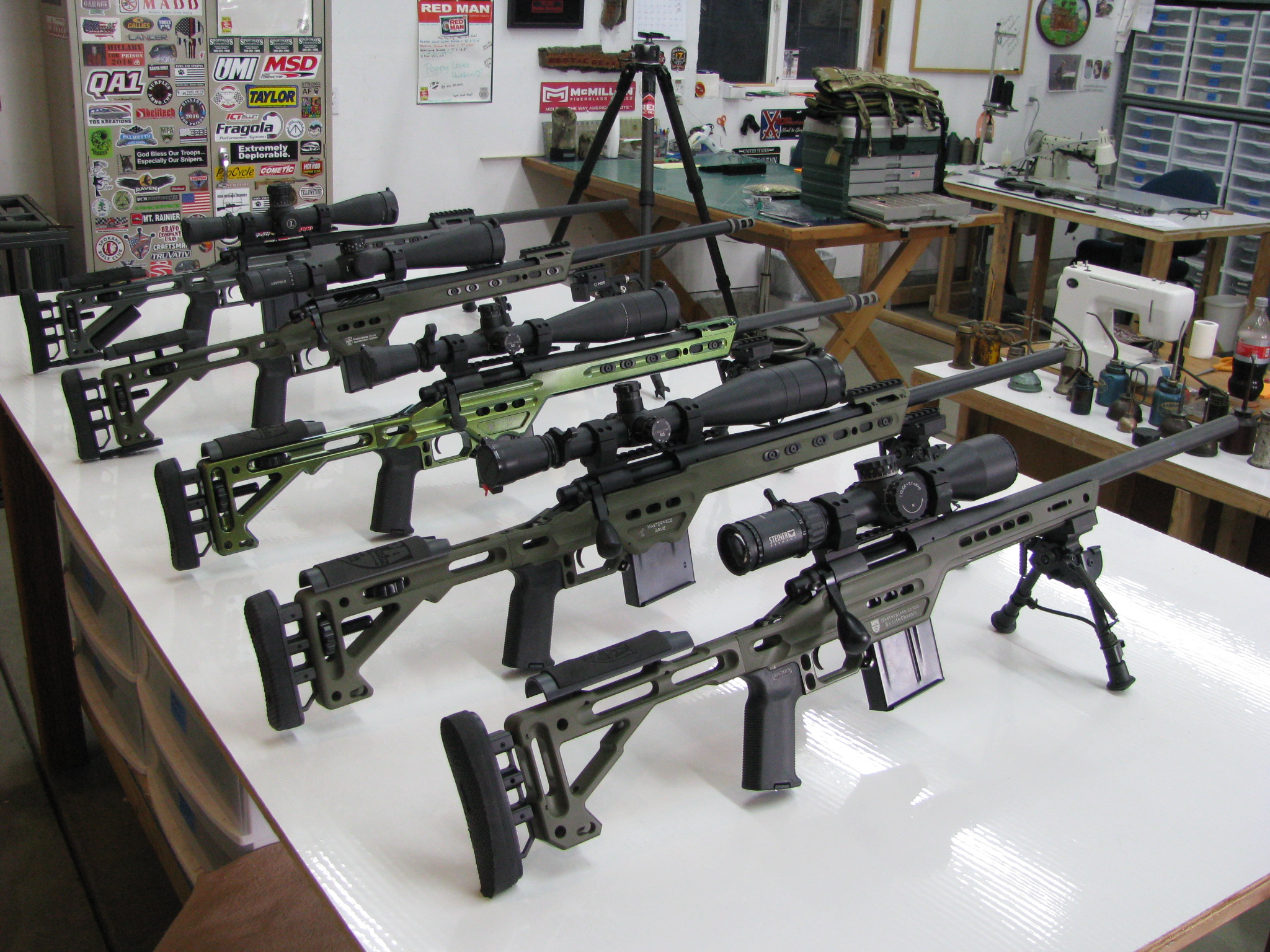

Just send it.

I'd simply like to match the performance of my current rifles, which are bedded in McMillan stocks. Just so happens those rifles shoot really well.
And btw, people I've talked to who say they needed to bed their chassis (MPA or otherwise) did so not because they were grouping .23 MOA instead of .12, they did it because their rifles wouldn't hold zero and wandered, or because there was considerable stress induced into the action. Not saying the chassis was to blame. But just like that podcast from MPA explained, it could just be a nature of the beast when working with certain combinations of products.
In any event, I've got a chassis ordered :)
Reactions: 47guy
