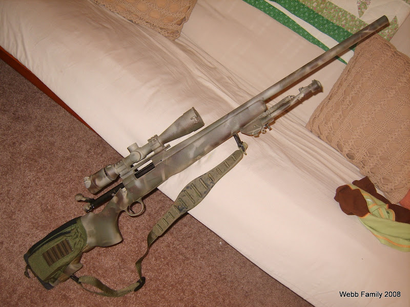

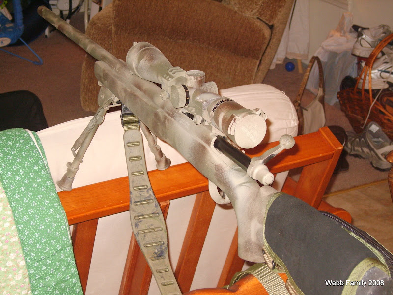

been wanting to put together a paper-punch n hunt 308 for a while. when i found that i wasn't gonna have to pay in on taxes i sold my old cheap rem 770 243 and let it fly.
This site has helped a lot with many of my choices on this.
It started with a good ebay deal on the scope then...
remington 700 sps varmint 308
EGW HD 20 MOA rail
Burris tactical rings (low)
Bell & Carlson A3 light tactical stock
Grove Tec flush cups
Tab sling
old pivot bipod i've had
USO rail mount anti cant
The scope is a Nikon Monarch 4-16x42 mil dot w/sunshade
(if i had found this site before i got the scope i would have got something that 1/10 mil adjust but oh well maybe later)
last is a little rattle can work and TA DA.
I shot it with the factory stock a few times and got a couple 1" groups shooting off a dog food bag. hopefully sunday i'll get to go re zero and see what happens.
BEFORE
AFTER
the uso anti cant won't fold in with the cover on it. Dang it. i'll just leave the cover off.
of course i have more i want to do to it thanks to you bunch of... never mind. if had never found this site i would consider this thing done.
once i get it zeroed again i've got to stretch it out and try some 500yd plus shots. i've never shot past 500. i'm getting gitty thinkin about it.
thanks to all here for the great info.

i've done a couple like this and they've turned out lookin pretty good.
1 tape off everything you don't want painted (like scope numbers) prep with rubbing alcohol or min spirts and a scotch bright pad.
2 spray entire gun with base color (in this instance tan).
3 cut some various thickness card board strips. Shoe box card board works great cause it's heavy enough not to blow away from the spraying but easy to cut.
4 toss card board over gun in random pattern and spray next color of choice spuradically in different places on the gun. rotate cun and repeat.
5 pick up next next color and repeat step 4
when ur done stick the card board strips in a bag for next time.

That rifle is SICK!!!! you should mail it to me and i can take care of it. lol
That is a great looking machine you have made there. Mad props to you
Re: been wanting this for a long time, pics
One of the rare, impressive spray jobs ive seen... im pretty anal about what i like when it comes to camo, but yours does it for me
Realllly nice looking rig mate

it's just the krylon ultra flat camo tan, brown, and green from lowes, i think wally world has it too. As long you scuff and clean everyhting it seems to hold up great.
i got to fire off 7 shots yesterday. and got a 1.25" 4 shot and 3 shot group. I was not as steady as i could have been; I need to practice a bit but i'm happy with the rifle. When i get to go by myself with no rush sometime this week i'll get some group pics in here.
