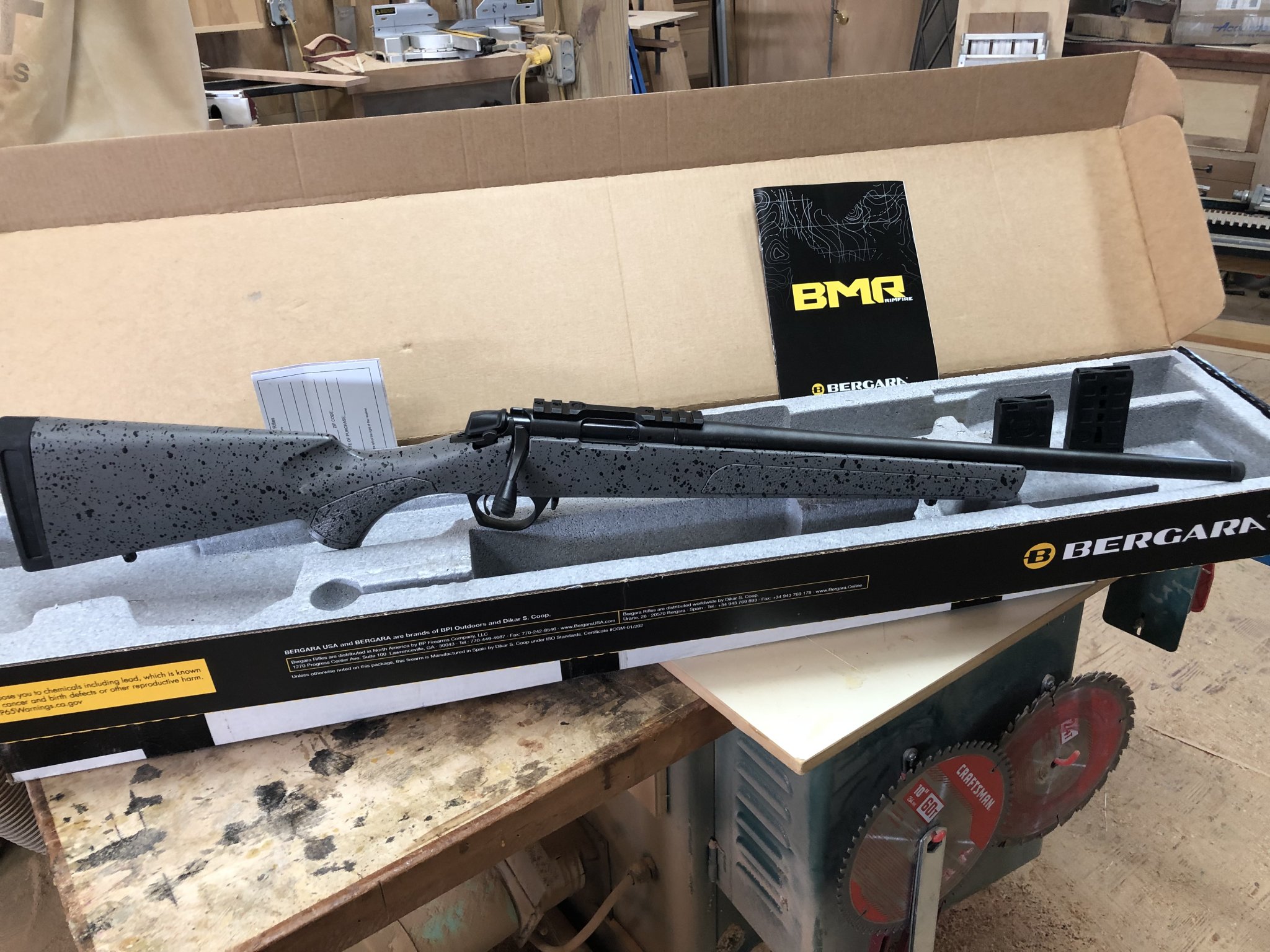

Well mine is out of the box. Need to see if it can find a home on the range or in the safe for the grandkids 🤪
