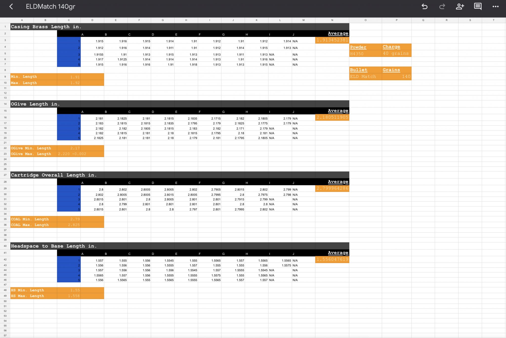

New to reloading rifle ammo and just wanted to verify something. My question pertains to full length resizing brass with my Hornady Custom set of (2) dies. I have a Bergara HMR 6.5 CM and my son has a Ruger Precision 6.5 CM. I have measured the headspace for both rifles from our fired brass and plan to bump them back 2-3/000 from the corresponding measurements. So is it necessary to keep the fired brass from each gun separate prior to reloading? Or, since I'm full length resizing and bumping the shoulder back is that not necessary? Thanks.
If the headspace measure on the brass from both rifles is similar then you might be able to mix the brass. I would take some other measurements first along the body and neck of the cases.
I know a guy who loads and sizes the same for a .260 bolt and a .260 semi. The chambers are real close, so he’s not stressing the brass too much. It helps that he’s found a load that works in both equally well. In his case, it’s only a minor compromise. It is really a case by case decision (pun intended).
I have the same issue here; my cases are at 1.562 avg before sizing, once fired brass. I run them through the die to 1.557 using the Wilson gauge and Lyman ammo checker they’re good. Then I run them in my chamber with ease the bolt locks. Now my problem is it does not meet Sammy specs and I bumped the shoulder about .05” wondering what’s the correct headspace for the 6.5 creedmoor… thanks
Your fired cases are 1.562. Bump them back to 1.560. Saami is for the lowest common denominator. You have actual measurements, use them.
Reactions: Garvey and lash
I failed to mention that this brass was fired out of a different chamber. I have a tikka t3x tac a1 and read somewhere that this rifle has a headspace around 1.557; I will need to collect fired brass from my chamber and start over. But thank you for the advice sir
What happens if I do push back headspace to 0.007”?
Once? Not much. Don’t make a habit of it. Just like bending a paper clip repeatedly, metal can only take so much fatigue so try to minimize it.
Instead of sizing down to try and meet an arbitrary gauge see if you can chamber it. If you can chamber it you have sized down far enough.
I see thank you. I figured if I sized it down once then it’s should be fine. Also I heard annexing at the neck will held hold it strength
Annealing.
Whole big can of worms kind of discussions on that but, yes, you should be annealing.
Brass gets brittle with use. All of that sizing down 0.007" and expanding back into the chamber upon combustion of the main charge works that brass and it gets work hardened. Brittle. It will break like the aforementioned paper clip (or any piece of metal). Flex it back and forth enough times and magically you have 2 pieces.
Annealing relieves some, if not all, of that hardness if done properly.
As @spife7980 said, if you resize "big" once, it's not a huge thing. When I was younger and made less money, I would pick up every piece of brass I could scrounge. I reloaded then because I was poor and free brass was very welcome. I would full length resize so that brass would fit my chamber. After that next firing, it would be fireformed to fit my chamber and then I would only bump the shoulder back about 0.002".
Reactions: Ozzie101 and lash
Your case may grow .005” more during firing than if you sized -.002”
Also, your bullet sits .005” closer to the lands when you close the bolt. That might cause a flier.
The reason I pushed back 0.007” because 1.562 would not chamber the brass, after I resized to an avg of 1.557 the brass chambers with ease. Im Running a tikka t3x tac a1 dmr, the unsized brass were not shot by my rifle so I saw on another thread if the brass doesn’t fit in the rifles chamber i would need to sized down 1 brass until it does and don’t use that 1 brass. Then try it on a 2nd brass, chamber it. well it works. Also saw another person reloading with this rifle saying after brass expansion his brass came out to 1.558 avg. I’m keeping COAL at 2.800 with 40gr of h4350, a 140gr eldm, and cci br2. Brass OAL ranges from 1.910 - 1.920. I noted Everything down. Will keep you folks updated. If I could type still 😅
Reactions: lash
While headspace is the primary concern the two chambers may be different in the area of the cartridge base which is not always resized well and could create chambering issues. It is best to keep the brass segregated by rifle and not intermix the brass from each rifle.

This is my current data for my Tikka T3x Tac A1, first batch loads. Do not use this data For your own rifle.
N/A’s are scrapped due to not meeting specs for either one of these categories.
