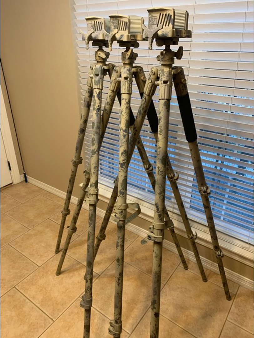

Innorel 344 from Amazon runs around $275. It’s probably the cheapest thing that’s usably stable. Innorel Rt90c will be more stable, but heavier and more expensive. Sometimes they come up used on Amazon, and you can save a decent amount. You’ll also need some type of ball head. Sunwayfoto IB-30, also Amazon, for about $150. Or innorel 52mm ball head may be closer to $100.
Bog Death Grips for something like $150 each on sale, the ball head adapters as mentioned, the full kit was something like $95 each. Some Krylon...

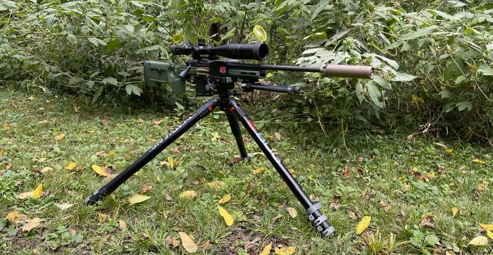

I went with a Death Grip. Never tried a ball head yet though. I figure I can always adjust a leg to level it.
New myself to the precision world, so still learning, and nothing has been painted yet. Not sure I even will either.
That adjusting the leg is exactly WHY I wanted the ball head. If you are doing some active shooting, like you do when predator hunting...the ability to pan that rifle and maintain level is imperative, especially when the action is hot.
The factory setup from BOG requires that the tripod be set up precisely level, and then you have no adjustment for vertical. The factory head only allows you to spin the rifle.
The ball head modification allows you to have a pretty stable support and have full range of motion while supported.
EDIT: Plus the ball head adapter and the ones used by @STI_1911_Guy save some weight.
EDIT EDIT: The main reason I like the grip over the arca rail or similar is that I do not have to purchase and figure out how to mount some fucking rail or whatever to each of my many rifles. Might be me just being extra annoyingly engineering OCD but I only clamp the rifle at the chamber, never the magazine. The adapter as mentioned previously allows me to take that clamp off and mount my Swarovski spotter or my little home made plywood table that will hold my Swarovski EL's AND my Spotter. I thought that was cool but it's not actually very useful.
Where do you get them? BOG doesn't even have them on their page. I'm guessing it's from a different company...
