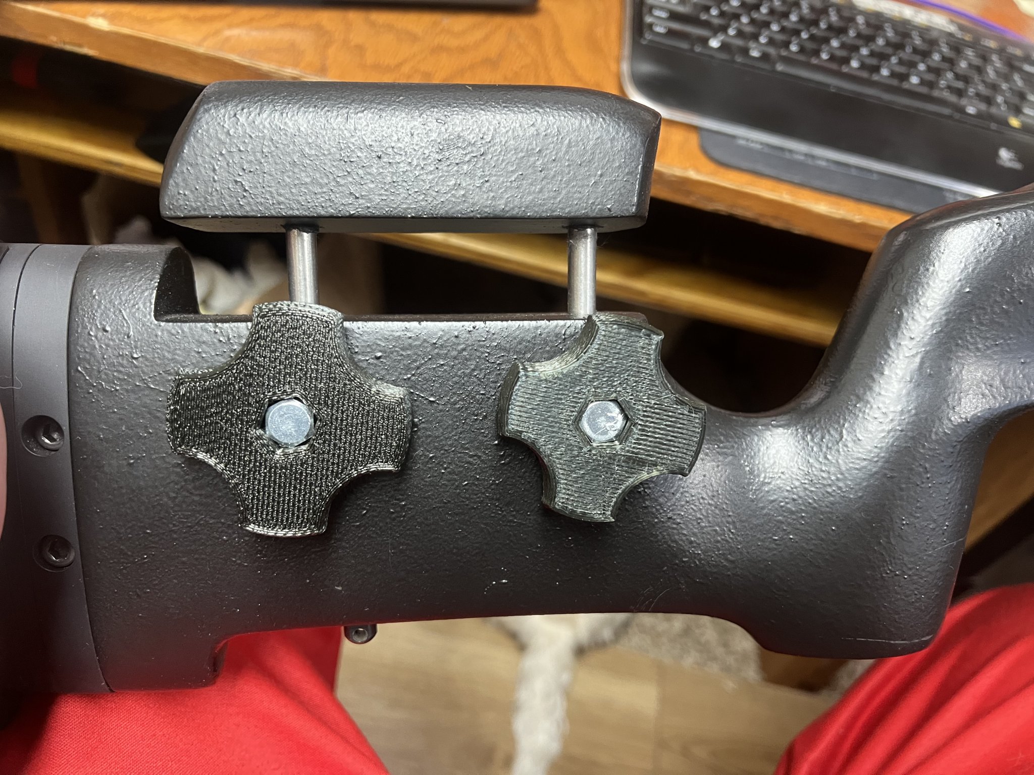

i've got a bell and carlson stock i like (https://www.bellandcarlson.com/index.cfm?fuseaction=category.display&category_ID=1053) but the problem is it's got hex or allen key bolts holding the cheek piece in place and if the cheekpiece is up, i cannot remove the bolt. in order to adjust the cheekpiece i'd have to use an allen key, any recommendations for a different type fastener that could be adjusted without a tool? like a thumbscrew?

You need to figure out the thread size and pitch then buy some sort of threaded knob with the same exact thread.

it's not just the pitch of the thumb screws (the bolts are 1/4-20). this specific stock has tapered bushings that are locked in place with the flat head cap screw that i want to replace. i was thinking about 3d printing a tapered piece to replace the taper of the cap screw, but it occurred to me i could possibly just get a different bushing that's taller so it sticks out .125 proud of the hole then a typical thumb screw from McMaster would lock it into place

i'll likely order some knobs from McMaster and model the tapered bushing i need in Fusion360 then 3d print it
I ended up 3d printing these knobs and used some nuts as spacers
Works quite well actually
