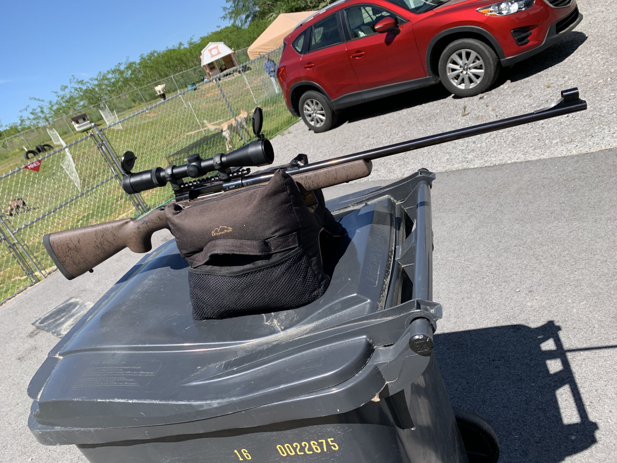

My rifle is in a B&C. I had it inletted for DBM by CDI Precision, and added sling cups to the side of it myself. The gun shoots well below half moa. I've been tempted by Manners and McMillian many times, but its hard to justify when what I have works so darn good. I wish it had adjustable cheek and LOP. Those features are the only reason i'd ever feel the need to change.

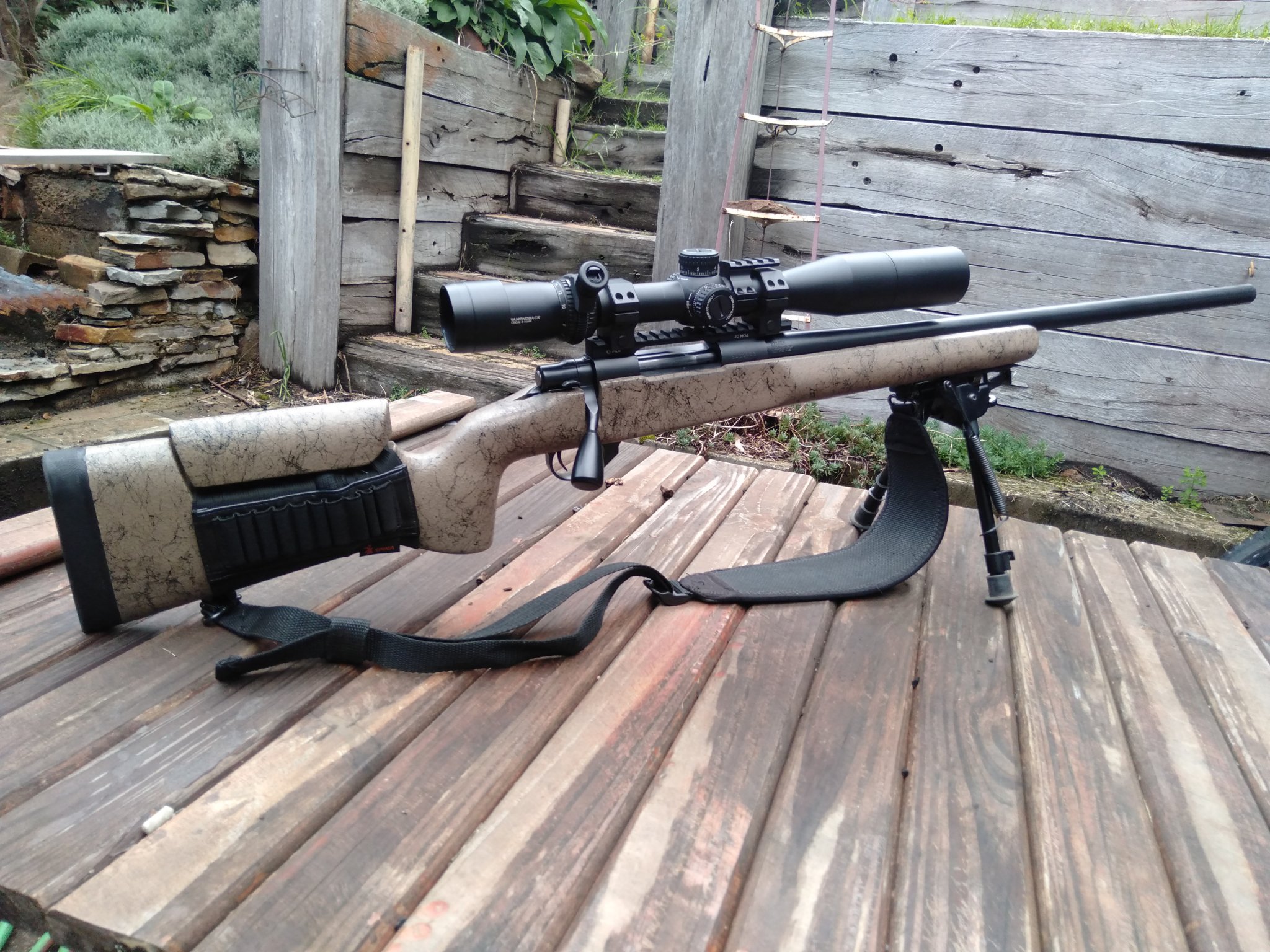

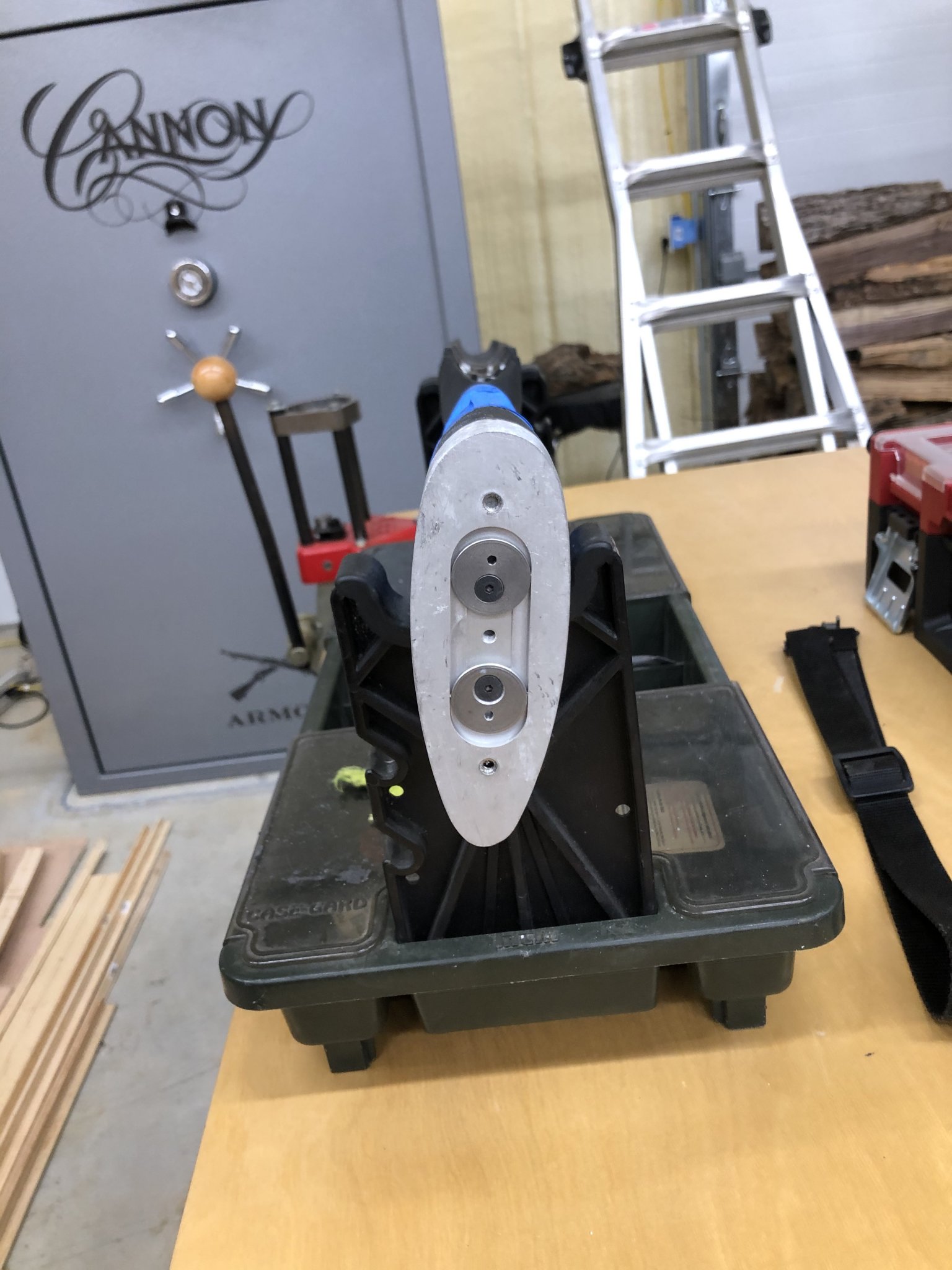

Could just add a sps2 right off the bat. Just did one this week on a hs
Reactions: Jake200

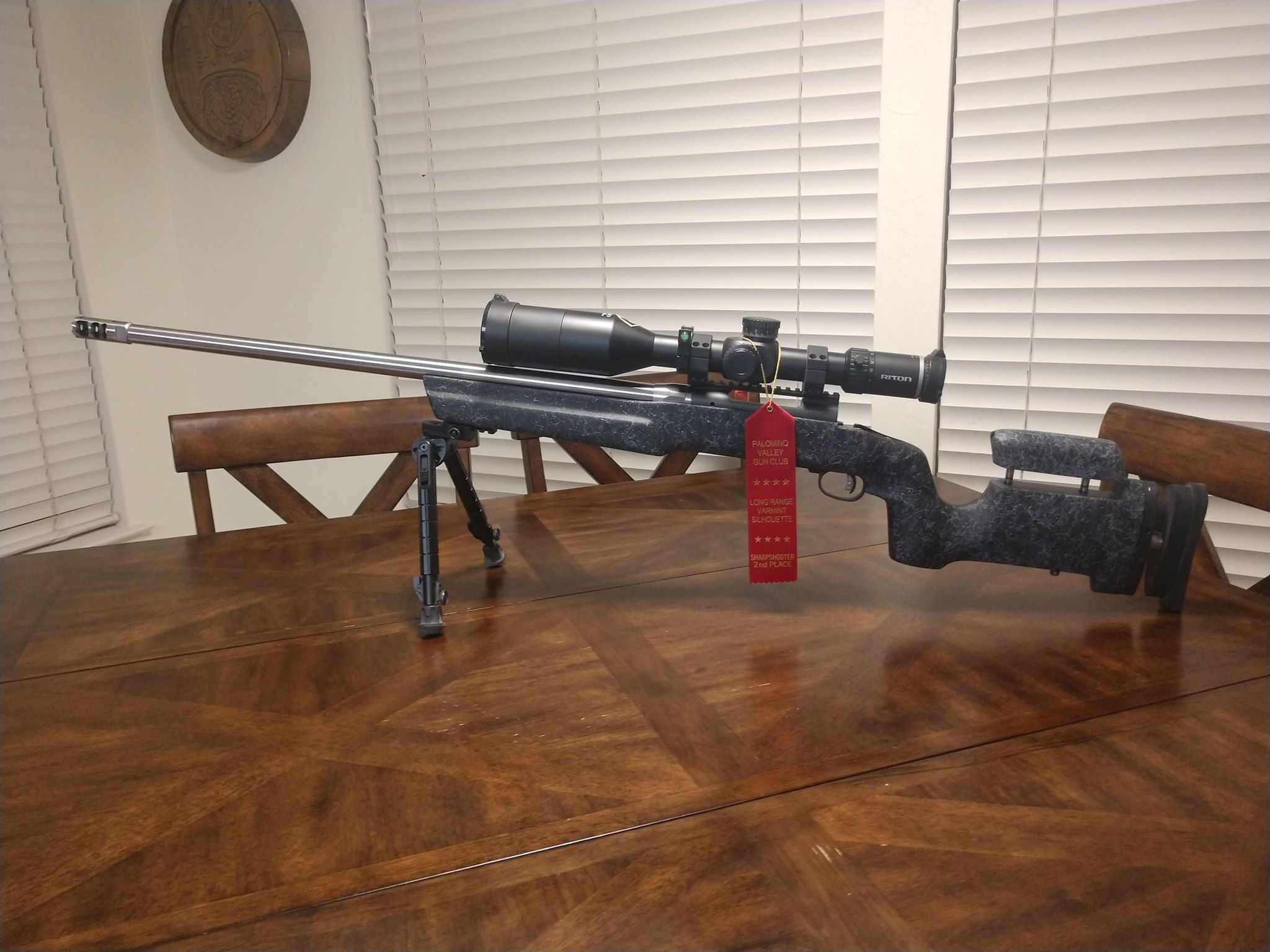

I have a BC on both my hunting Tikkas. I really like the feel of them. If I was going for more of the long range set up I would look at the KRG bravo.
I looked at the Bravo and it is all I would need in adjustability. The only thing would be AI mags in that I have a .223 and I believe mags are pretty hard to come by in that caliber.
I have the Target/Competition stock but on a Howa 1500 that I use for a bit of everything and quite like it. Prone is no worries with a Tab Gear style rear bag.
Like others have said if you want to run a DBM that will be an extra cost but I am using the internal mag with floorplate still with no worries and didn't need to do any mods.
