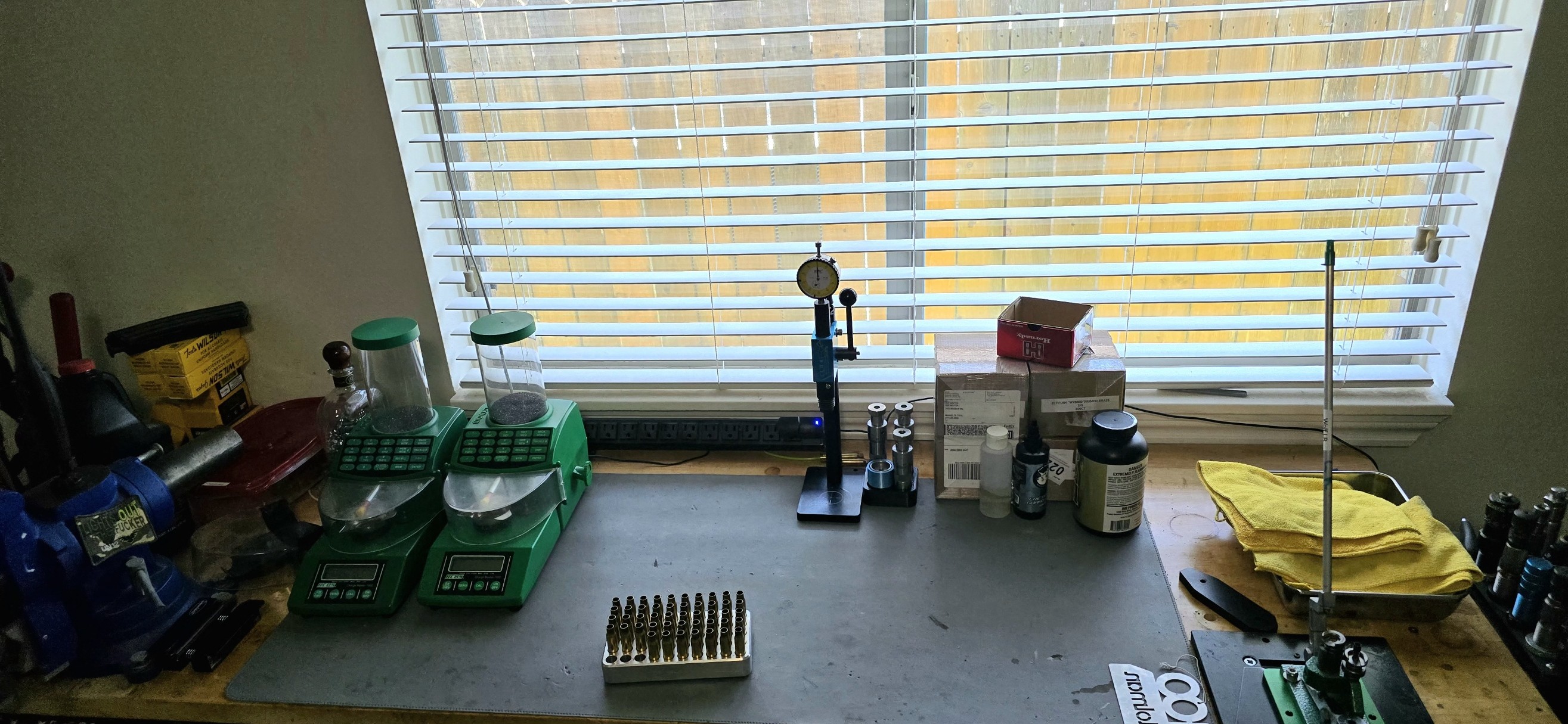

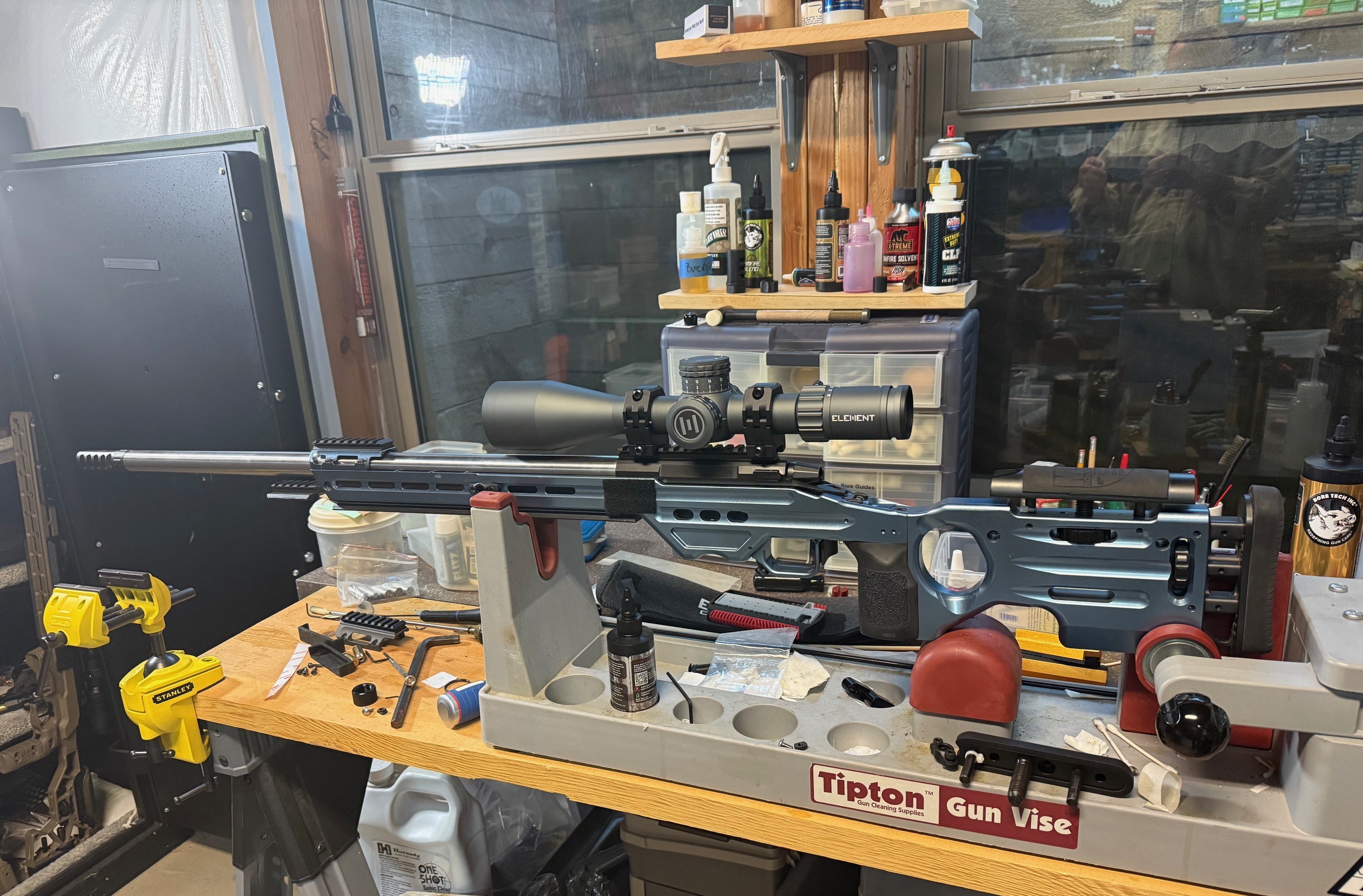

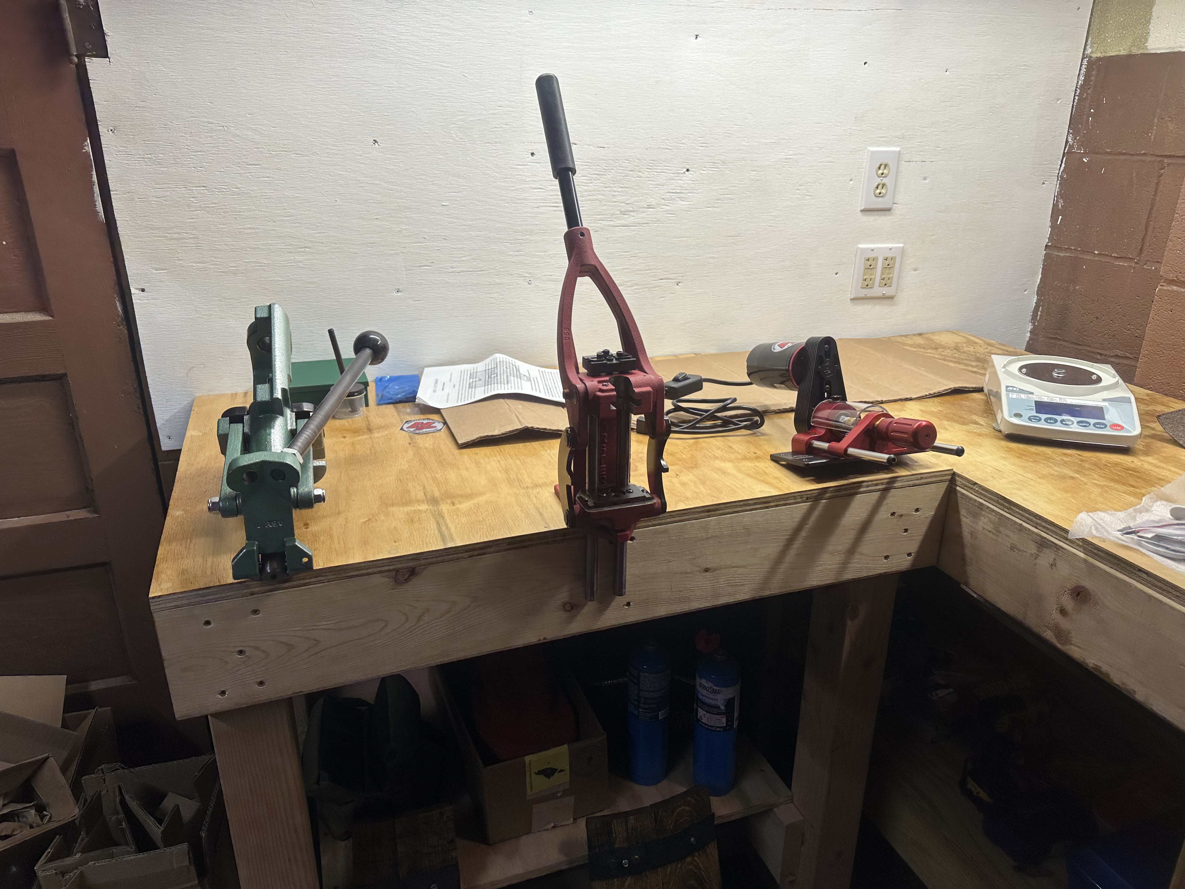

Im new to reloading and finally working on getting my bench setup. I want to make the best use of my space as this is where I’ll setup new rifles and do all my cleaning. The left wall with outlets is all wood and sturdy so I can mount whatever to it, along the back of the long bench there’s an 8-9” gap due to the pillar so I can build shelving of some sort to take up that empty space as well.
I have a rock chucker I’m planning on only setting up with my ugly priming tool, a Forster coax for everything else and a Henderson trimmer. I want to keep all that stuff on the short bench but I’m not sure if I should hard mount all, none, or somewhere inbetween using something like inline fab stuff. One thing is I’d like to get the rock chucker on a riser and leave the other 2 flat. I can put the scale on the long bench where press movement won’t affect it since I didn’t mount the 2 benches together. Recommendations would be appreciated

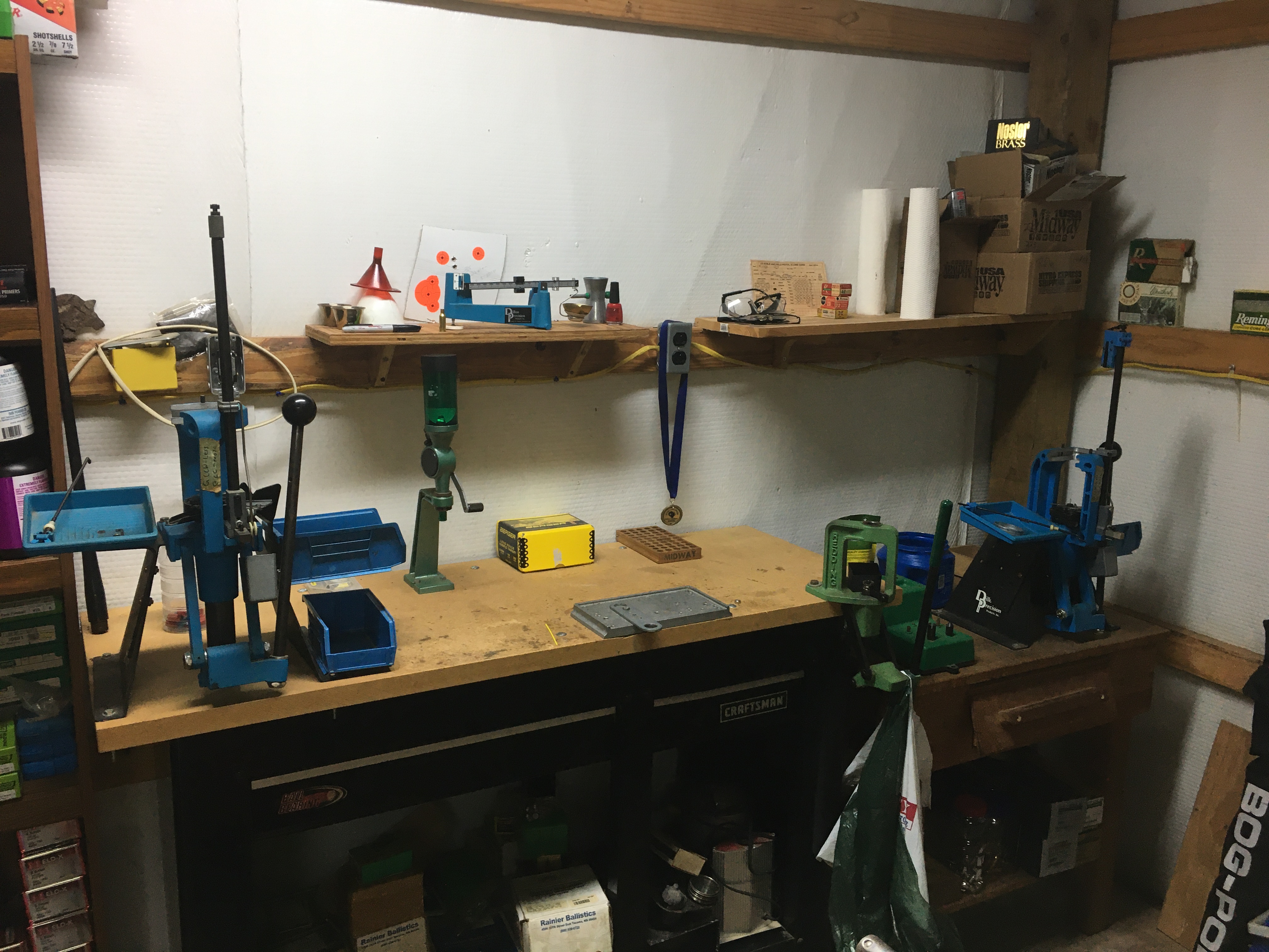

After retiring and downsizing to a smaller home, I don't have much space and have a workbench in my garage about the size of the short section of your bench. My bench sits on base kitchen cabinets with wall cabinets above for storage. And next to the bench is full length storage cabinets (floor to ceiling). Because I have such limited workspace, nothing is permanent on the workbench as I also need to use the bench for other uses other related to shooting. So, cabinets contain brass prep tools as I only do brass prep on the garage bench. Loading tools and supplied are stored in a room where I store all my loading equipment and supplies (e.g. powders, primers, scales, arbor press and seating dies) as this is where I can control the interior climate). I have an old used heavy executive desk that I do my loading at sitting in a very comfortable chair, which I can sit in as I do for other personal functions (like what I'm doing right now on my desktop computer ;)). Since I'm in Arizona and my garage is not a good place to keep these things there where temps in there can get over 100°F in the summer.
I hope this simply gives you some things to think about. :giggle:
PS: I can't tell in your picture if you're using fluorescent or LED lighting. If you're using that scale there, I hope you're using LED lighting and not fluorescent. . .???
I work left to right
With the chuck on the right as I am limited in space / half of your bench as well.

You're off to a good start and giving it some forethought....
If it were me, I'd bolt on some bench extensions to the back of your bench that would fill in the gaps around the column and increase the bench surface area... I'd keep any shelving higher up off the bench. Definitely agree with the GOOD lighting!
It will eventually change over time as you find what works for you, so don't get too deep before you figure out what works best for you and your processes....

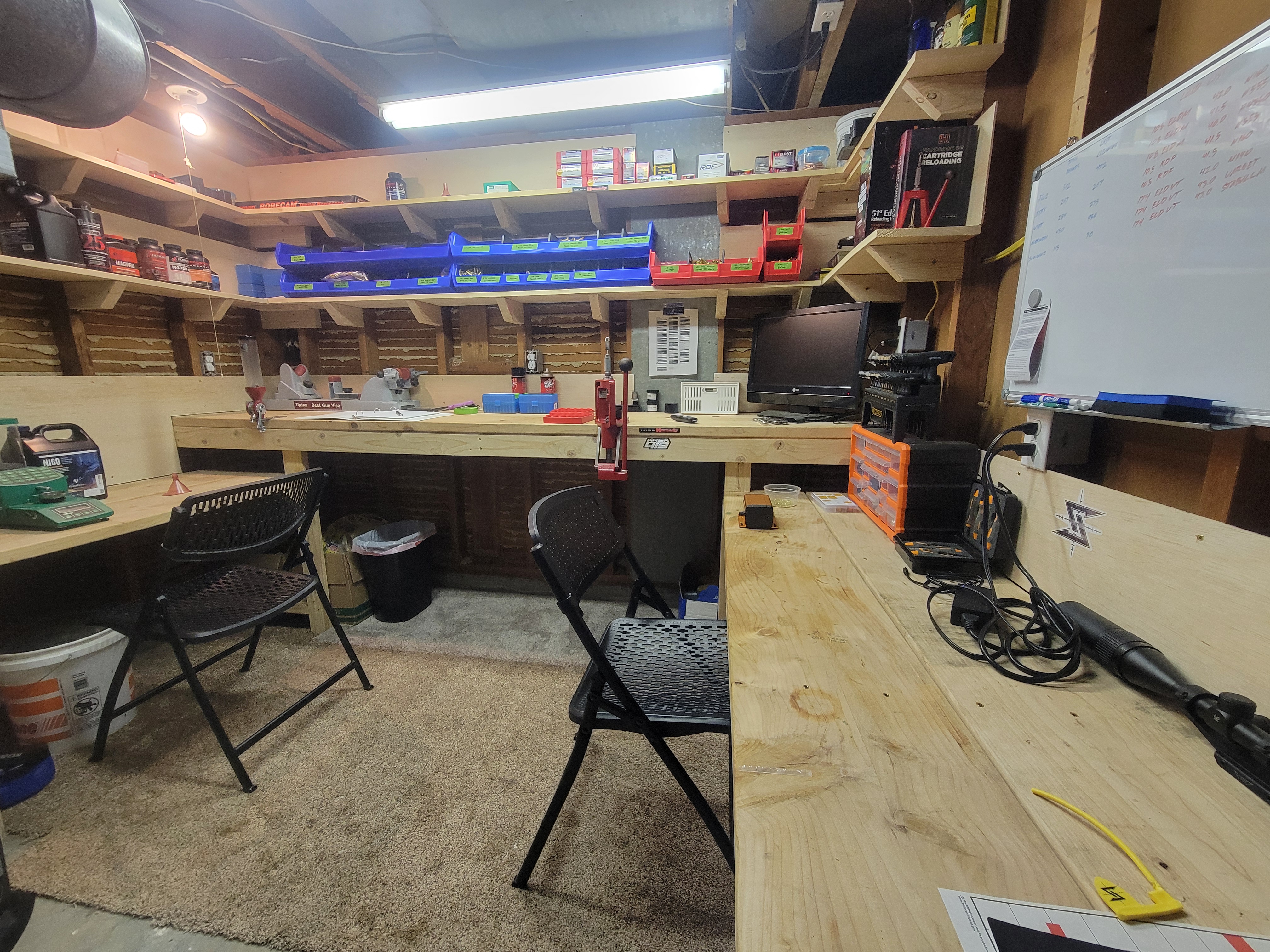

Here's my setup. I have a little spot in the basement behind the furnace that I cleared out and built a custom bench. All three benches are attached to the walls and are very stout. I could jump up and down on them with no problems if I had the overhead clearance. I also ran a couple of new circuits adding lighting and several outlets. The bare bulb on the left was all that was there originally along with a flimsy workbench along the back wall that would flex every time I pulled the press handle.
I find it more comfortable to be able to sit and work for the most part than to stand on concrete even with the carpet remnants I have laid out so I designed the left and right benches to be the right height for me to sit down. The left hand bench is for powder and priming. The right is where I do most of my case prep, work on and clean guns, mount scopes, etc. The center section is a good height for me to stand and work on something or to sit and operate the press.

I have plenty of storage space and room to build more shelving and such so I think I’ll be alright there, out of the picture is a 4 tier shelf and under the benches are shelved I just have to get all my building tools cleaned up from putting all this together. I’ll keep the annealer and other big things that don’t need to be out all the time under the bench.
Reactions: Zebulon

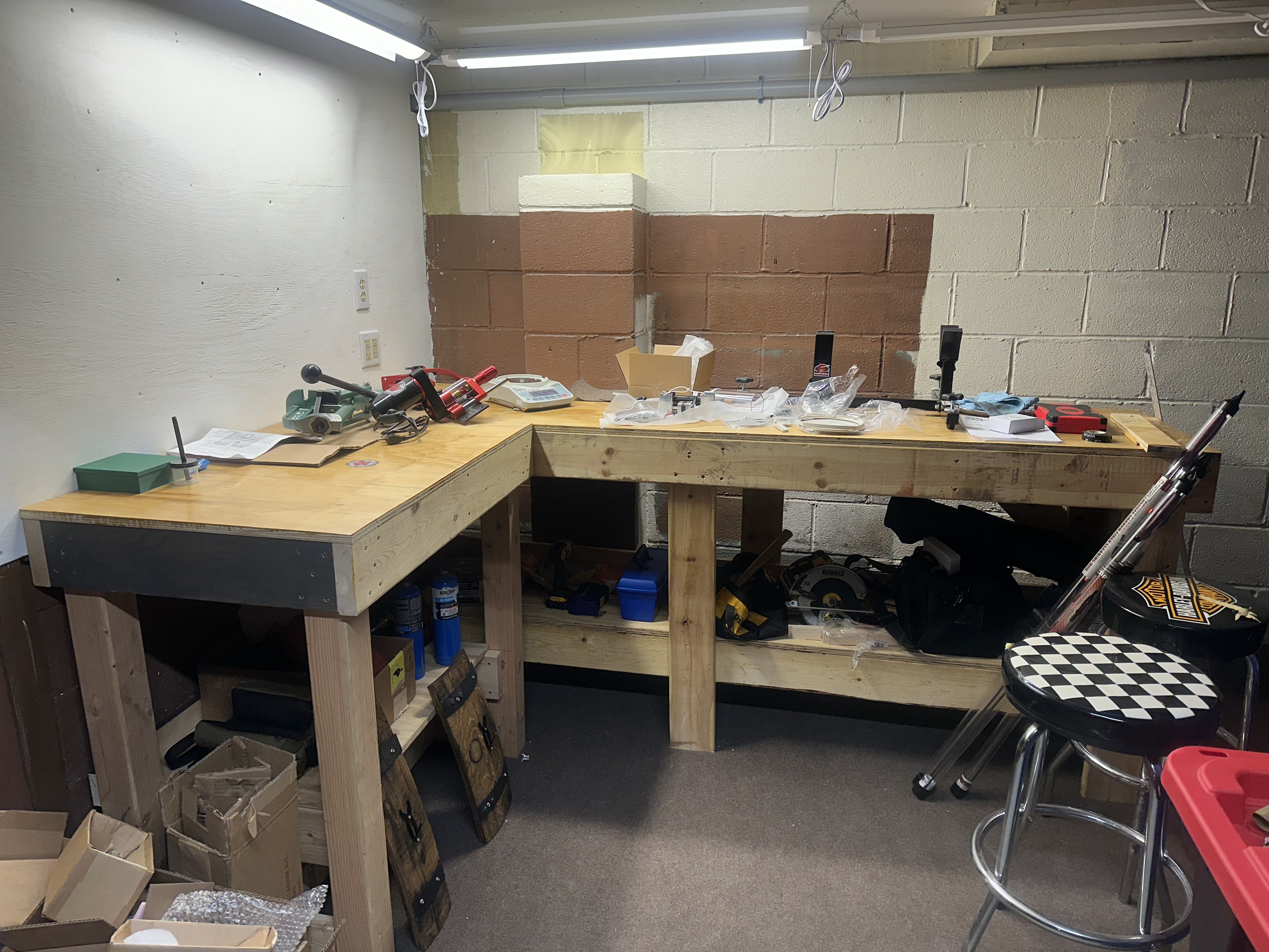

I mentioned in the original post about building something useful to take up that space, since that side is gonna be cleaning/working on things I’ll likely store tools and cleaning supplies there. I have 3 bright LED lights above the bench, one of them isn’t turned on in the picture. Plus another to my back in the picture, it’s very well lit.

I agree with press on the rightmost of the work space if you're right-handed. I'd mount it right over the side post/support for stability.
I work on 2 different 4'x4' benches. I use 3 of 4 sides of each of them. One thing you might consider is moving the bench out away from teh wall so you could work on 3 sides of it; but I realize it's much narrower than my 4'x4' benches, so that may not work.
I never considered moving my benches around, I could move the shorter bench away from the wall enough to get behind it and work but I think it’d make a portion of my longer bench unusable.
I’m leaning toward getting inline fab QD plates for both presses and my Henderson trimmer. I really only need to use one of those at a time so swapping them out through the process wouldn’t be a big deal, then my bench could be obstruction free when I desire
My only thought is remember that whatever is against the wall can only be reached to, but not worked from
If you move your long bench away from the wall, you double the length that you can work along it

OP, I would move the press to the ends of the bench. With it in the middle you are blocking a lot of workspace. That's how I have mine and all my presses on on Inline Fabrication mounts. If it's not in use, it gets put up.
^^^What WE Said. ^^^.
@Bacarrat we must be brothers from a different family. I use the RCBS multiplate. Tools go on when I need them and get put away when done.
If you’re using QC mounts why’s it matter where you put it? In that first picture I was just showing potential placement if I hard mounted all 3 but I think I’m just going to put one dock on the table and put everything on QC mounts
The mount still in the way, since it sits a little above the bench. Unless you router it flush to the bench top. Even then it will require a little stick out.
I was going to use a router so it’s flush, I did see it stick out a bit for the wing nuts. I’d probably put it off center toward the right that way I have room and bench space on both sides. If I put it too far right it seems the long bench would interfere with arm movement

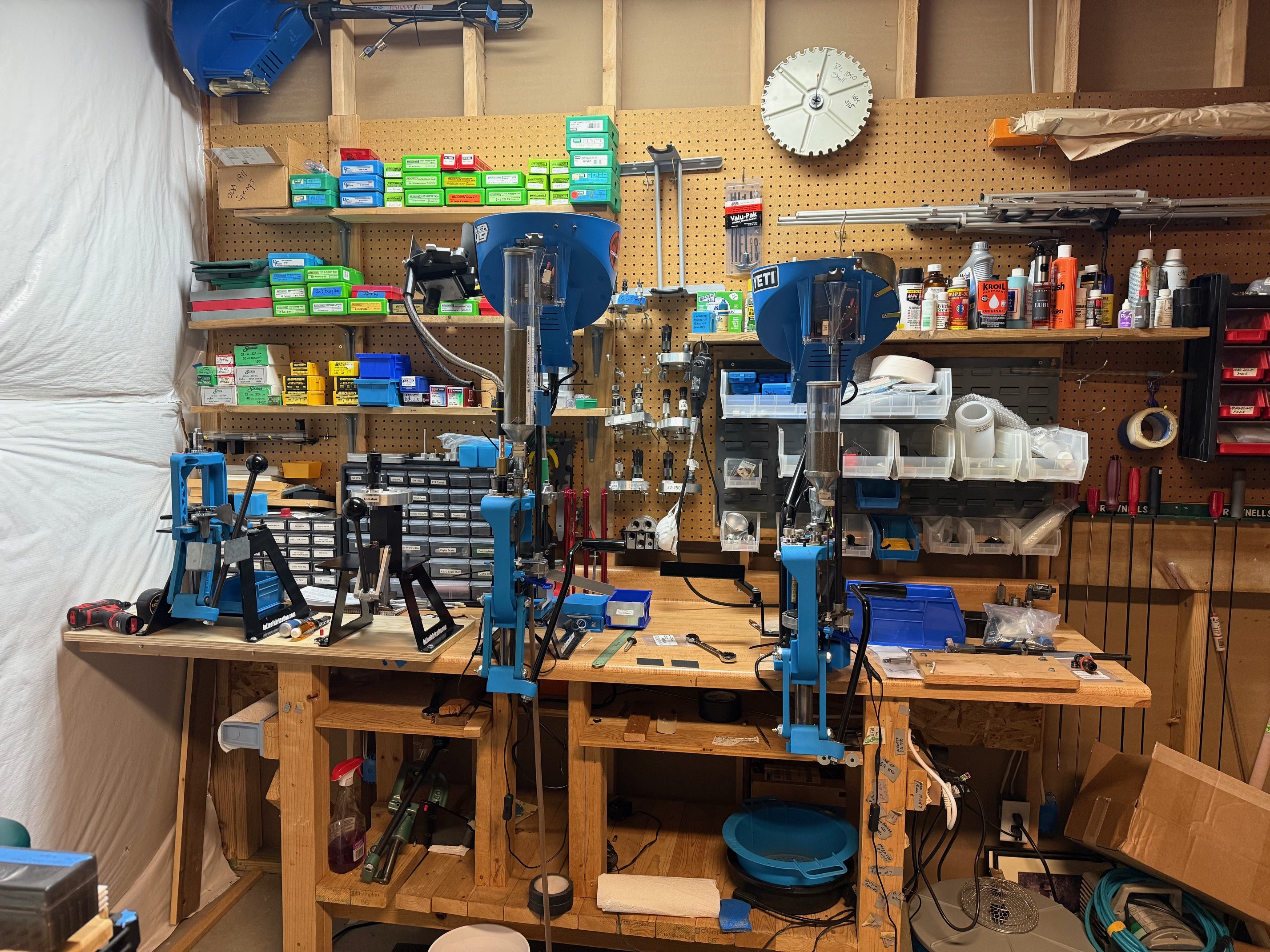

Here is how I set mine up. I also run a CoAx and Henderson trimmer. The trimmer doesn't need a mount plate since the factory plate the Henderson perfectly matches up with the Inline Fab plate. Not shown is the Redding Big Boss, Lee Prep Station and AMP Annealer. All tools, bullets, cases are in a toolbox under the bench. All surplus stuff stays in the garage. That's about the most cluttered I have my bench.
