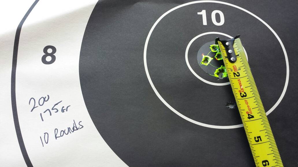

uploadfromtaptalk1403477416427.jpg All the advice paid off....Im no sub moa shooter but at least I cured the vertical stringing. ....thanks a million guys !
Sent from my SPH-L720 using Tapatalk
