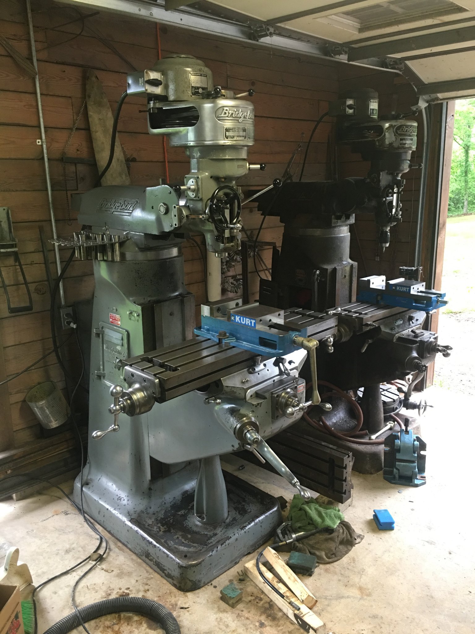

    I had $2k into a beat up old 600 pound 1963 Rockwell 21-100 from 2004 to 2015.
    Then I got a 2000 pound mint condition 1969 Bridgeport for $12k.
    It turns out for gunsmithing, the little mill was just as good. All I got that was an improvement was the DRO and auto feed. I could have tacked those on the Rockwell.
    I have 2 1967 Bridgeport Mills, gave $750 for 1 and $950 for the second one. Both are great machines. You can usually find good deals on them at auction or word of mouth. Only thing is, you have to have a 3 phase converter.

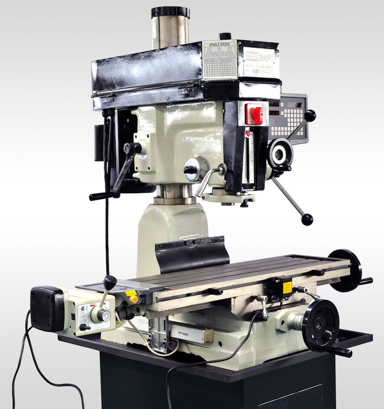

    The benchtop mill I've got is a 650lb Bolton ZA45PD 9.5" x 31.5" I picked up locally from a little old lady off craigslist for $1500. Only used on Sundays... It came with a stand, DRO, power feed, endmills, drill bits, angle plates, 3 sets of parallels, R8 and er20 collets, facemills, T-nut clamping kit, several 1-2-3 blocks etc. It was close to a $4000 in retail investment for the original owner.
    It has done everything I've needed of it and seems to cut true/square to the limits I've expected. I do like that it does not take much real estate in my garage and if I need a full-sized mill, I have a couple friends with full-sized knee mills who can be bribed with alcohol.
