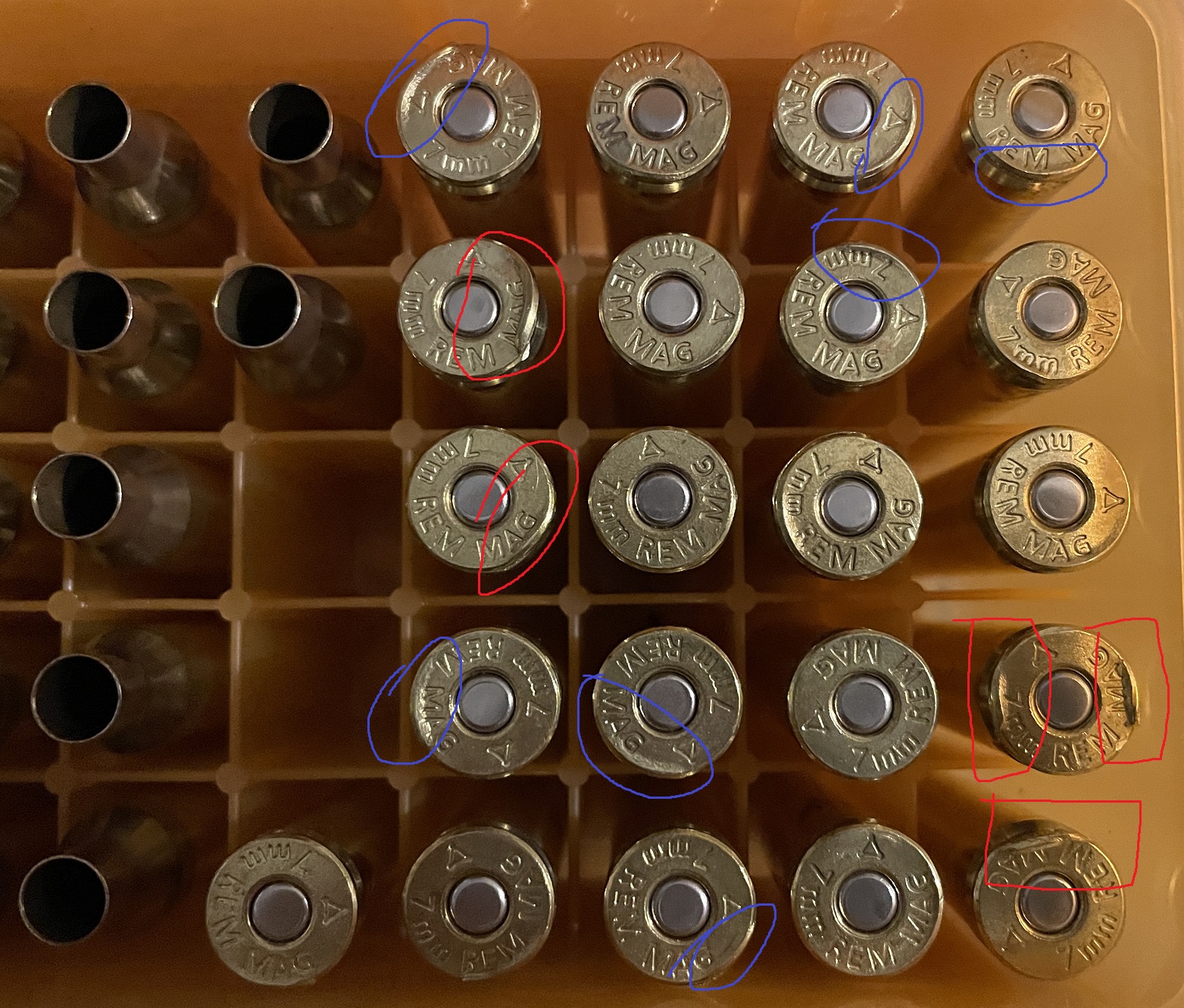

Got 3 boxes of "once fired" 7mm RM ADG brass for really cheap.
Anyways, in one of the boxes, about half of the brass had bent bases / rims. Enough that the brass cannot sit flat against a flat surface and I realize I'm going to have to toss these. Just wanted to confirm that this was most likely caused by an over pressure round right? I imagine if it was an extractor issue I would also see this on the other brass.
Also, starting with minimum loads, I'm guessing the "non bent" brass is still safe to use? Or should I just toss the entire box that used these loads / powders?

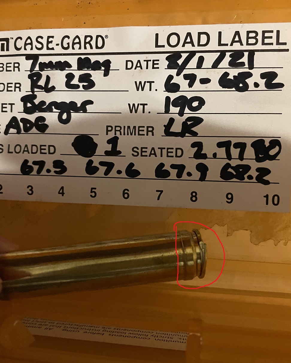

1st picture - "more bent" ones circled in red, "less bent" in blue, "barely bent" not circled.
2nd picture - bottom right casing in the first picture from a different angle. load data inside was there when I got the brass. Seems like it may have been a bit much to me.
It was early this morning when I posted that sorry mine are dented in not out it looks like it was stuck in chamber pretty good and look at that bottom of case above rim that’s not good I wouldn’t load any that have that case bulge
Are they bulged above the belt or is the brass right above the belt almost even with the belt? Can't tell from the picture. If so, the ones with the wonky rim probably got stuck in the chamber from the bulge and the guy had to extract them by smacking the bolt handle back.
This is pretty common with belted magnums that are loaded way too hot or the brass was fired more than the seller said it was. That area above the belt gets enlarged where a full length resizing die can't reach and keeps pushing the brass downward toward the belt every time it's resized.
exactly what I thought. one hell of an extractor that withheld that.

Thanks for the replies everyone. Seems like the general consensus is what I'm thinking - this box is probably no good - at least not worth gambling my safety or the rifle with. Was kind of expecting this as an answer, but being relatively new to reloading, I wanted to see if there was "something else" I just didn't know about with large-ish magnums, a particular extractor issue that isn't ammo related per se, etc. first. OTOH, I'm a bit surprised the (decently busy) B&M store, with modern day liability and all, would take a chance selling these.
And yes, also what everyone else said - what an extractor. With that being said, I've only seen someone hammer on their bolt once before and the case rim was no where near this damaged afterwards. They proceeded to stop shooting those rounds as well - in this case, why the original owner would shoot 20+ rounds through the gun after their first "get the hammer out" + "majorly bent rim" is beyond me...
There was no bulge directly above the belt on any of the cases I looked at in any of the 3 boxes. Granted, they could have used the Willis collet die or something else that pressed the case in above the belt, who knows.
And yes, I absolutely suspect this brass was fired more than once.
