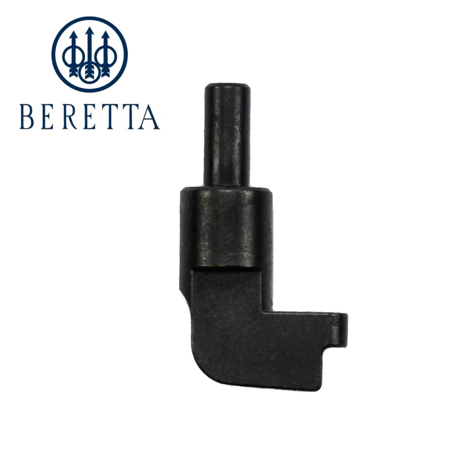

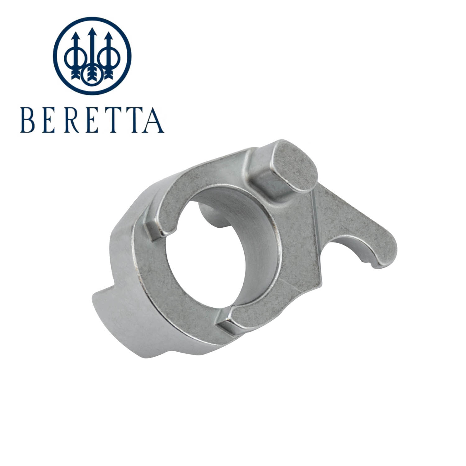

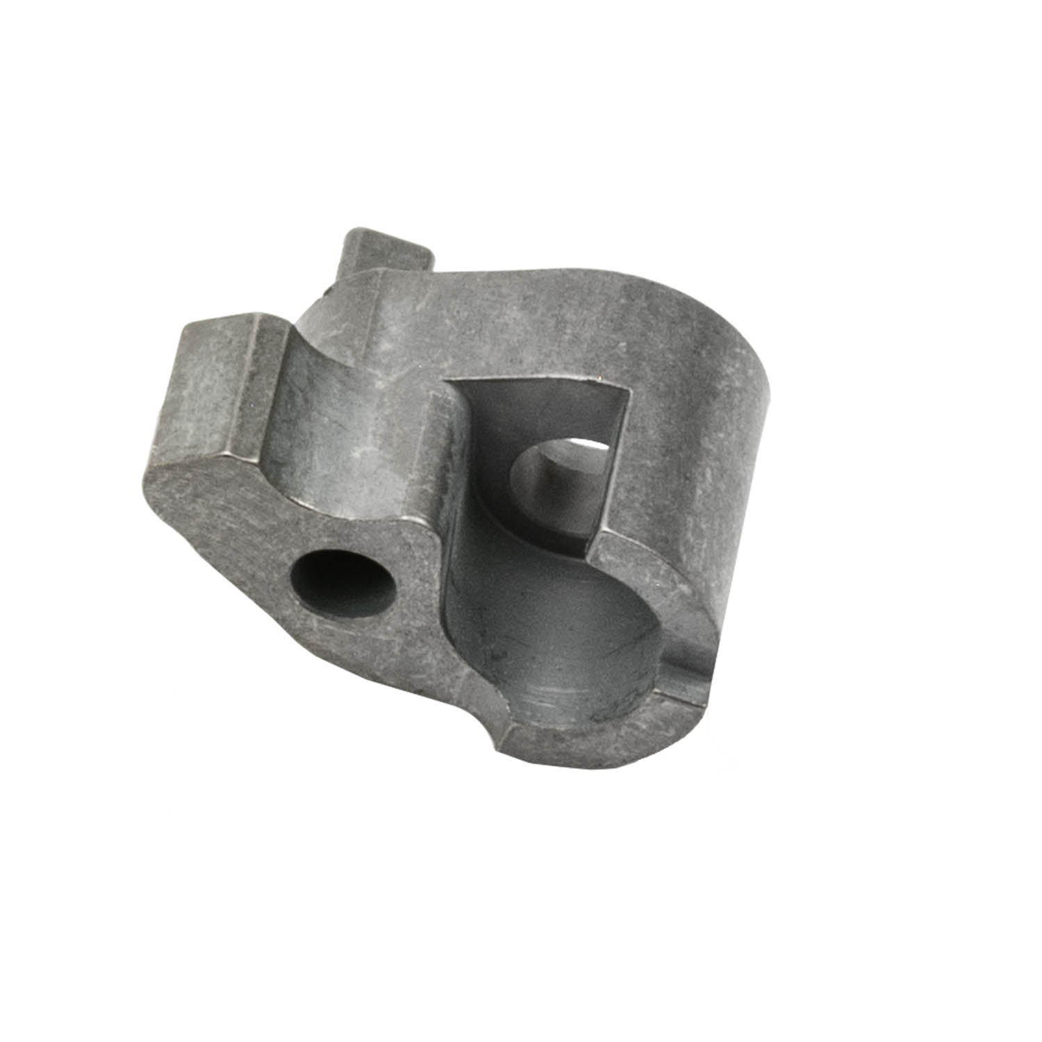

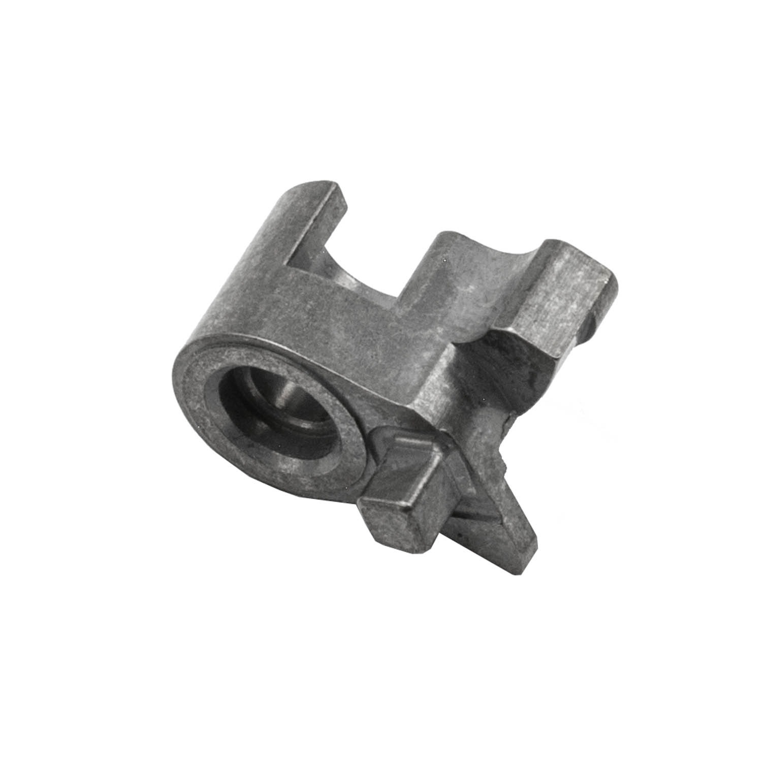

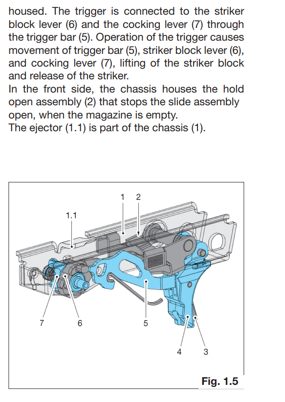

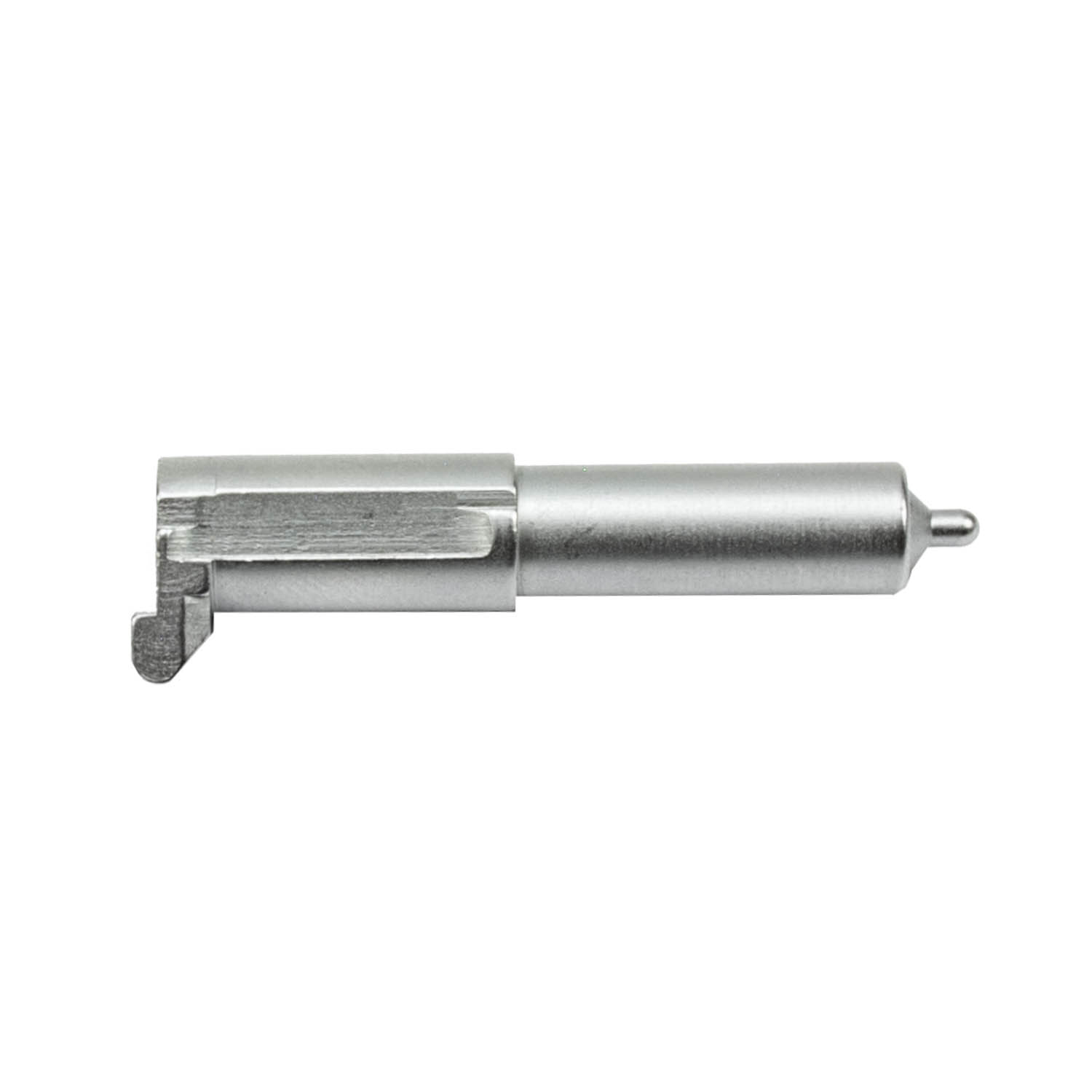

Most likely the contact points between your trigger bar, striker block lever, cocking lever and striker block and striker has issues whether it's too much slop from material removed trying to improve the sliding friction or geometry. Potentially messed with the trigger bar spring length too and striker sear lug.
Trigger bar
Cocking lever (there are multiple types)
Striker block lever
Striker block -
Striker

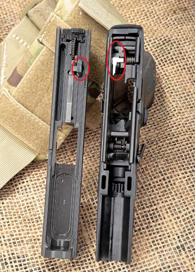

Remove recoil spring and barrel. Put slide back on and look through ejection port, pull trigger to rear slowly and you can get a very vague idea of what is happening with how much trigger movement. That'll be your initial starting point. My guess is your striker block is not moving up and out of the way to release the striker to spring forward, meanwhile your cocking lever continues to drive the striker rearwards as you press the trigger. However, since the striker has reached its travel limit, the only movement left is slide movement as you continue to pull the trigger to the rear.
Trigger bar
Striker block lever
Striker block -
Striker

That makes a lot of sense. Thank you for the big write up. So what would be out of spec to cause this? Replace the striker block?
It could be any single one of the parts or combination of parts I mentioned. I'd take a look and see if any of the parts inside look like the factory parts. If they look similar, then look for where someone used a file or stone to grind down material at the contact areas where the parts are supposed to interface. That would look like shiny polished metal.
In a striker fired pistol - all the parts that are commonly replaced or modified for a trigger job are
- Trigger bar (In other pistols, the trigger bar usually has multiple functions, one which includes functioning as a striker block lever, this is a separate part for the APX)
- Sear (the equivalent is the Cocking lever)
- Striker Block
- Striker
- Springs (trigger return, sear, striker)
- Trigger shoe (with some form of overtravel stop)

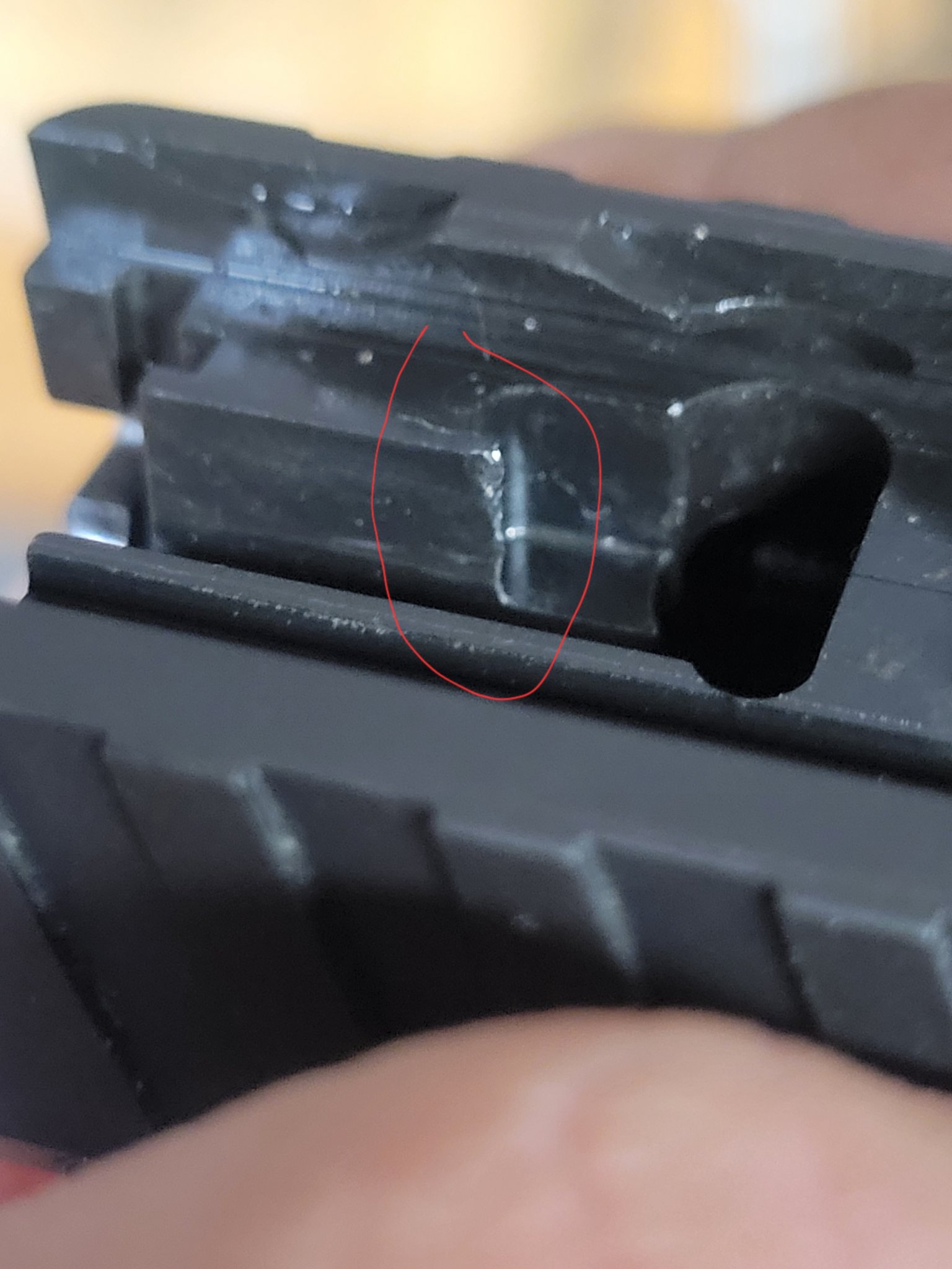

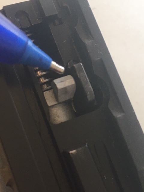

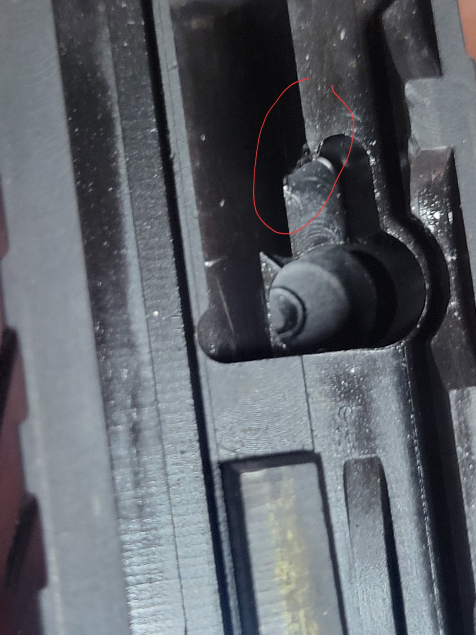

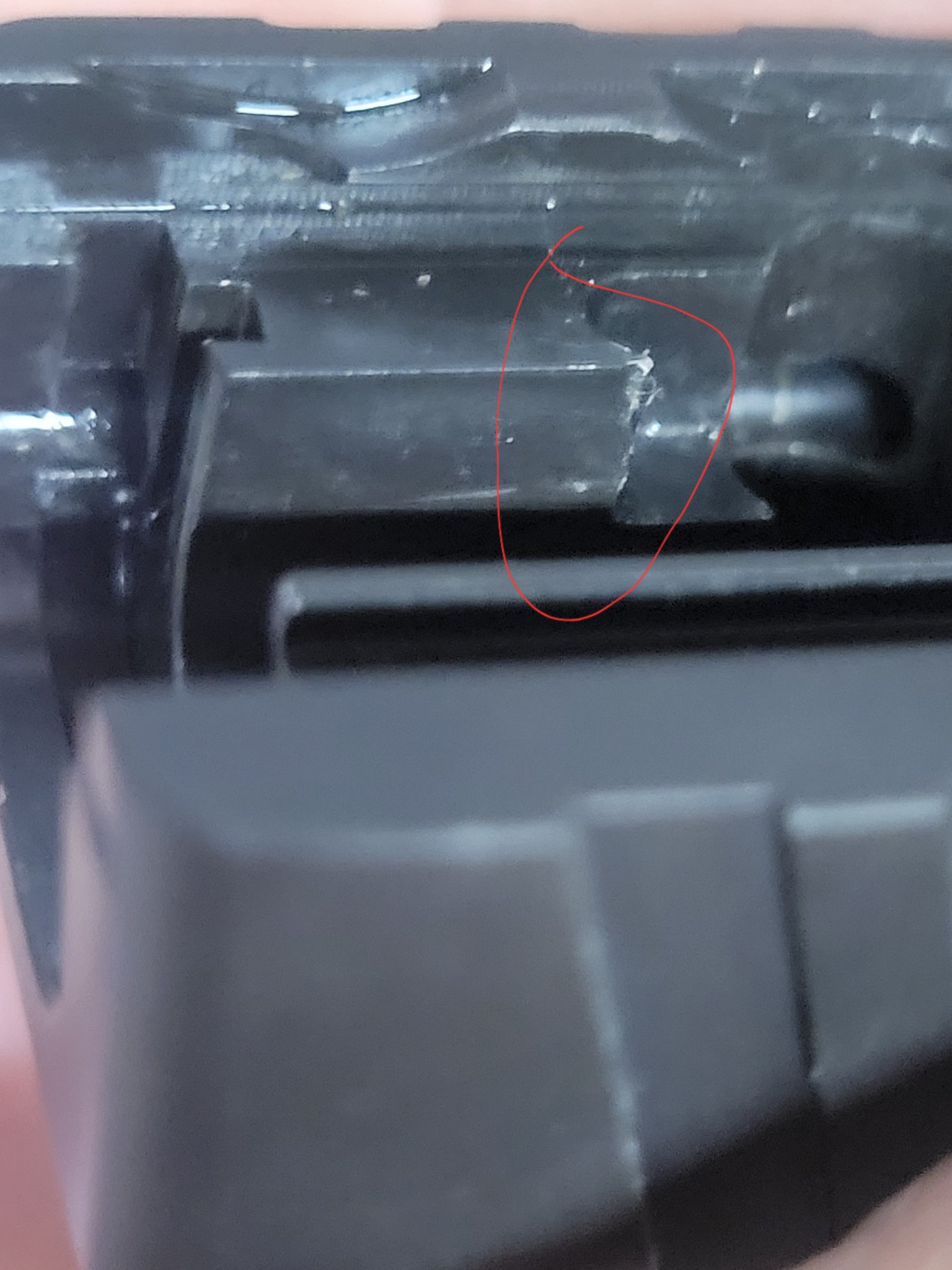

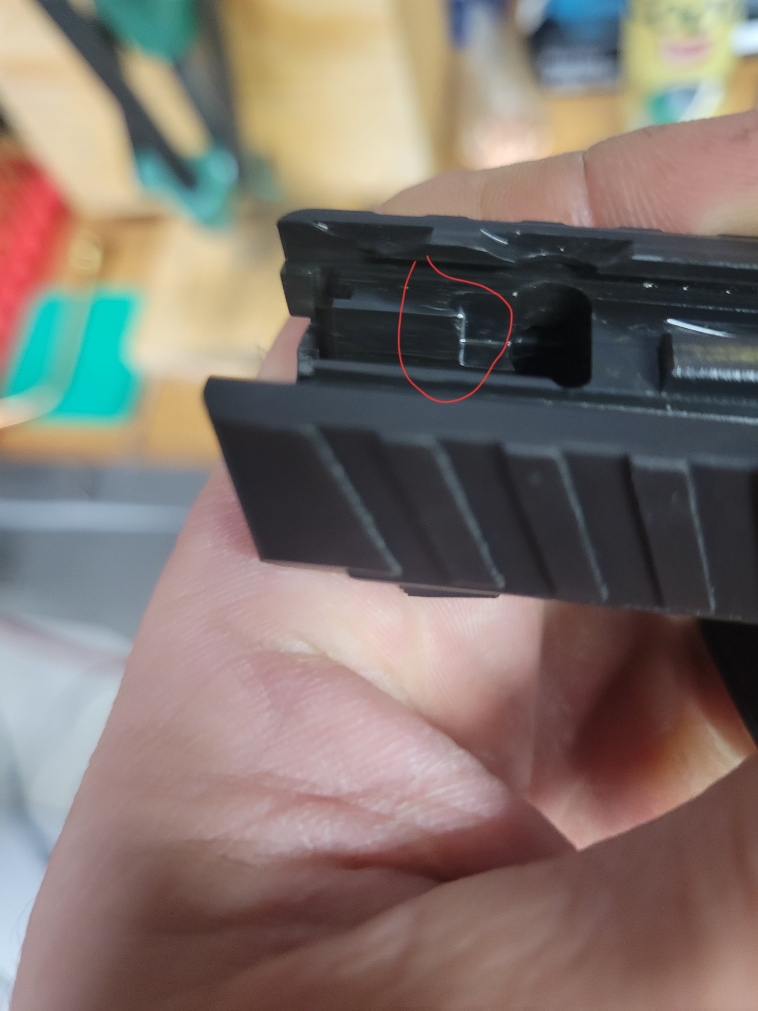

Playing with it a little more and looking into opening at the back it appears when I pull the trigger the striker isn't able to move freely like it should, it hangs up on the slide and that's what cocks the slide. It took the slide off and if I put some pressure to the right side, I can get the back of the striker to hang up on the edge of the cut out for the striker block. (see below) It seems if I took a file and rounded off the back edge of the striker it would prevent it from hanging up. Before I do that though, I want to hear what you guys think. Also, it shouldn't have to be done with drop in parts. Any ideas?
If it was supposed to be a drop in part and not a semi-drop in, then there should not be any fitting required. If it's semi-drop in, it requires fitting. Contact the manufacturer.

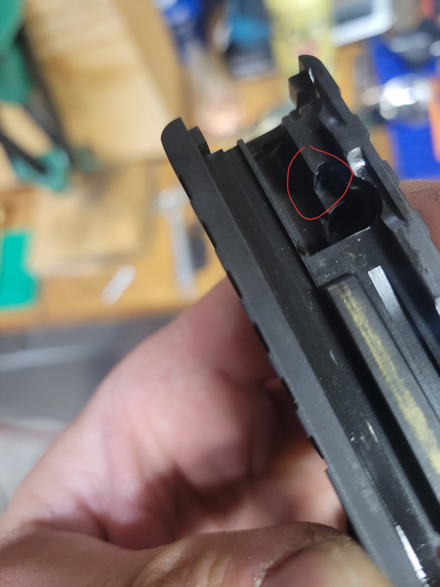

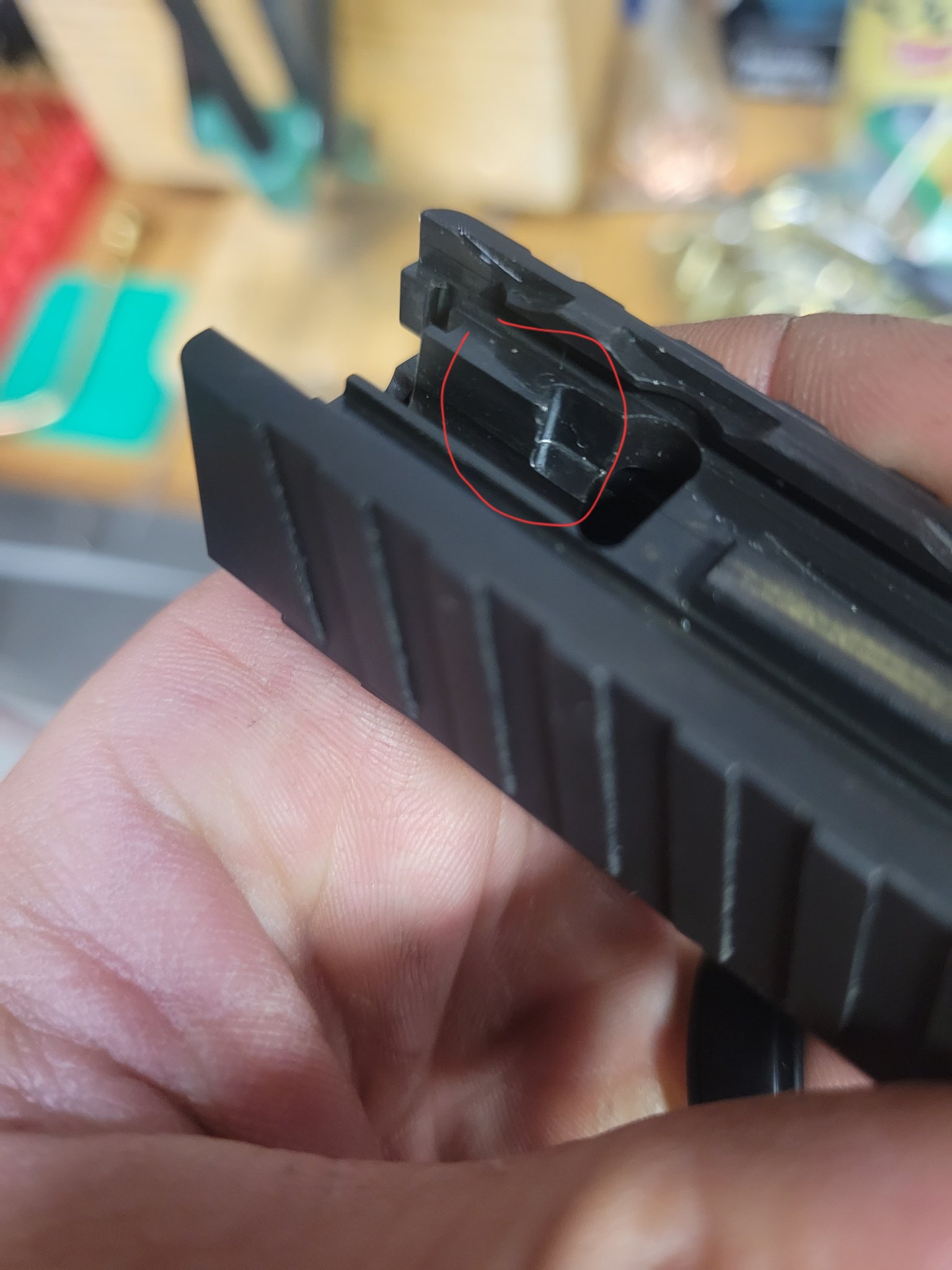

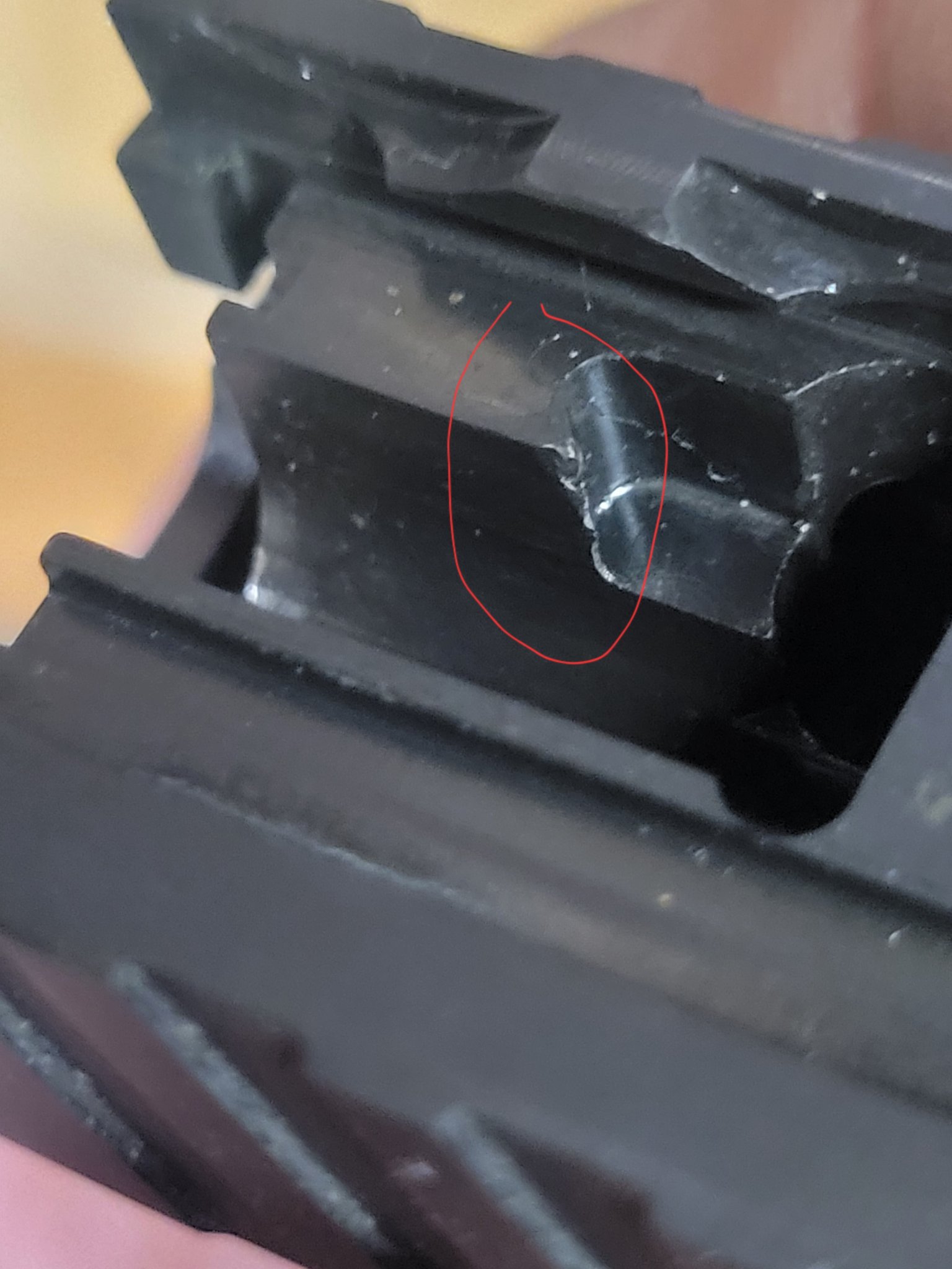

I know this is an old thread but I purchased a new Beretta apx a1 carry and The damage on the slide housing for striker block after firing a few times seems relevant. Ive contacted beretta and am waiting for a response. It fires fine currently but for how long.?

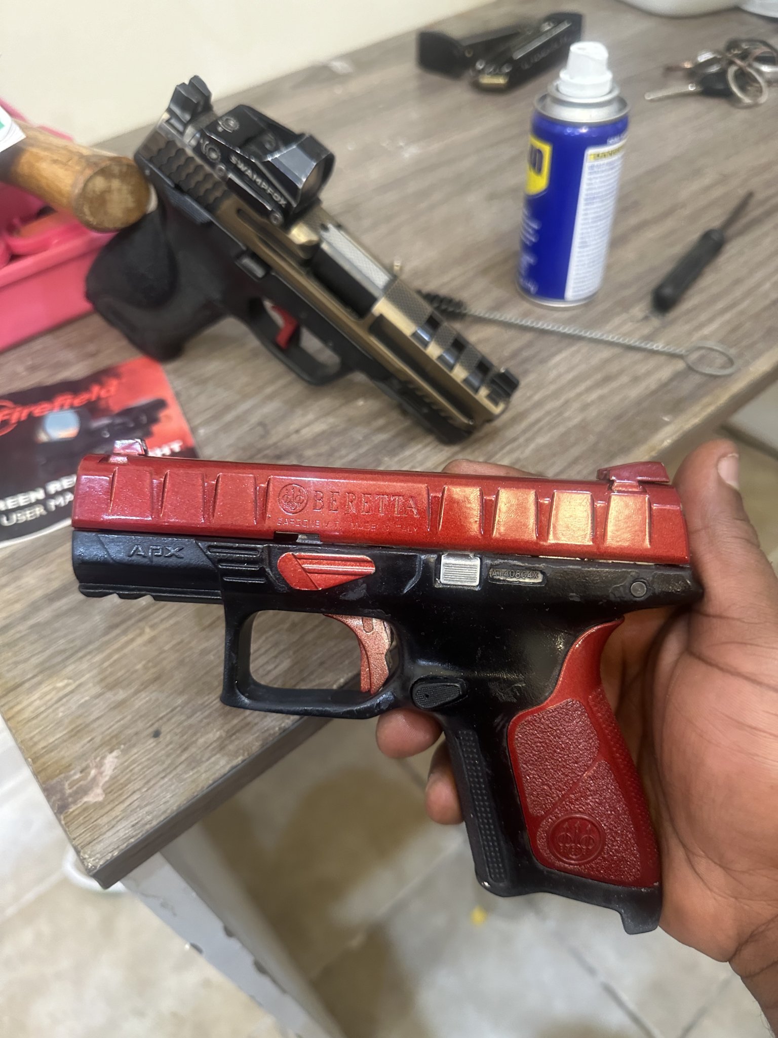

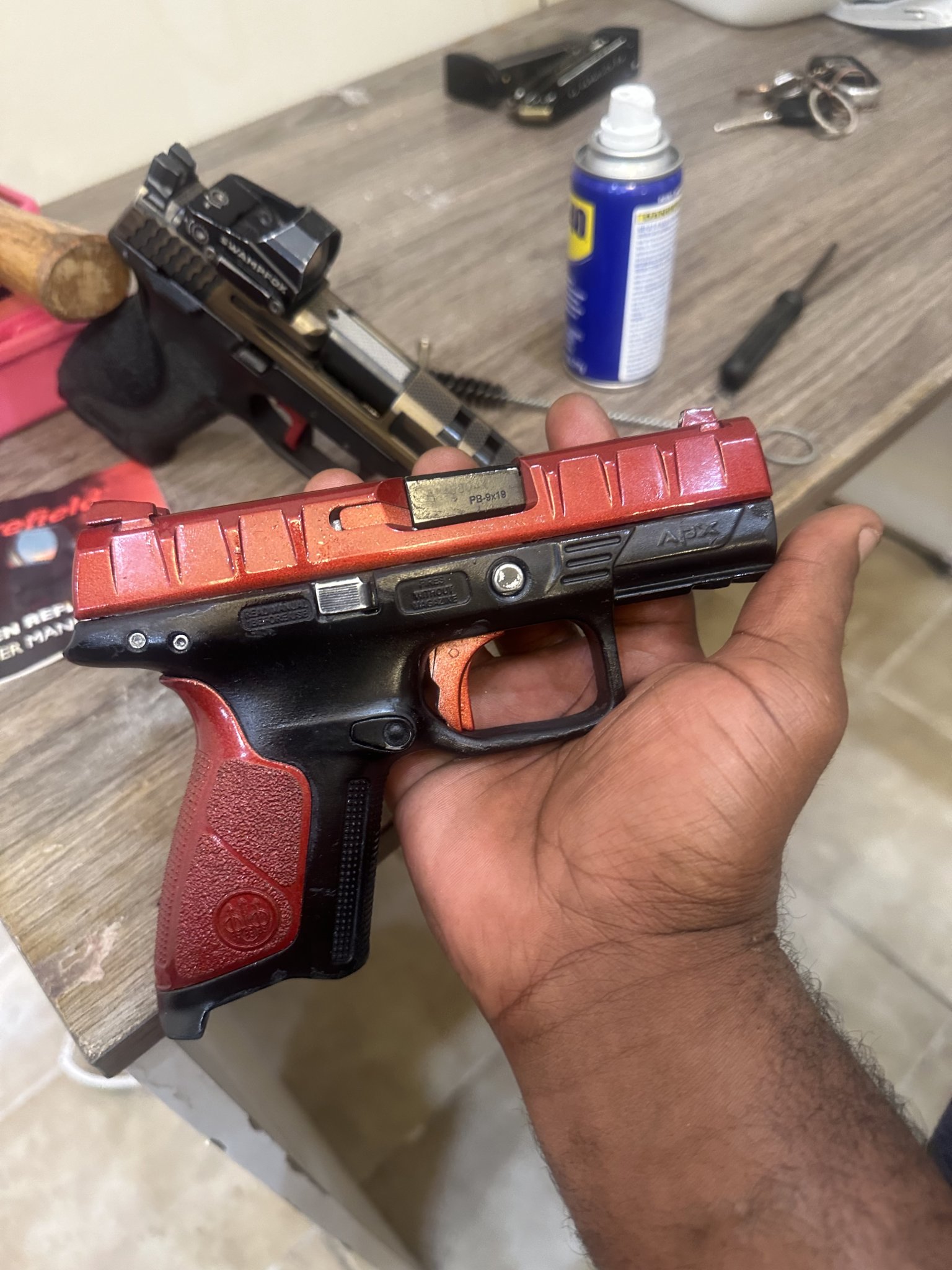

"I have a problem with my Beretta APX Centurion. I haven't shot the pistol in maybe a year. When I brought it to the range, it would fire, but after chambering the next round, the trigger gets stuck in the rear position, requiring manual repositioning. Even after lubrication and reassembling all parts, the trigger still sticks to the rear after each shot. I need advice on how to diagnose and fix this issue."
Have you totally cleaned out all the old gunk from the gun? After sitting that long old oils tends to dry and get either glued in place or supper sticky. Try some parts cleaner and re-oil.
