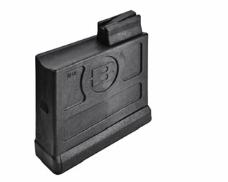

Bergara 22lr magazine pic
Magazine pic

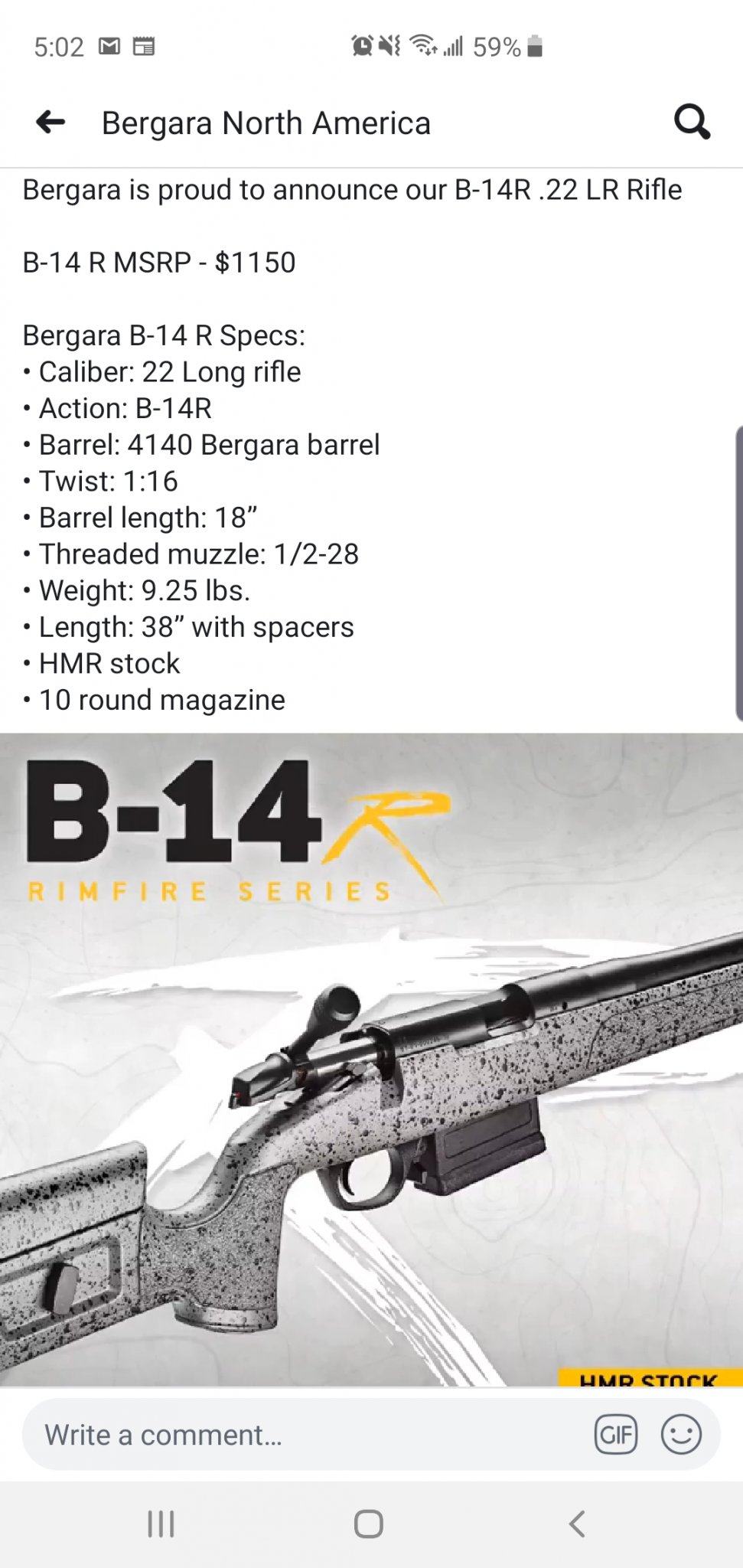

Press Release:
Bergara is proud to announce our B-14R .22 LR Rifle
The Bergara B-14 R .22 LR is the latest offering in their ever-popular B-14 series of rifles. Ben Fleming VP of Sales for Bergara states. “Our team has been working on a very accurate full size .22 precision trainer for several years now with a goal to help set the bar with the .22 shooters. With this gun, we are confident that it will help long-range .22 shooting grow for years to come.” Dakota Russell, Nat...ional Sales Manager for Bergara added, “Our customers have been requesting a gun like this for some time, and with the growing NRL22 and PRS .22 competition matches the timing was right to introduce a rifle of this nature.”
This rifle is designed as a true rimfire "trainer" is that it works within the dimensions of a REM700 platform, allowing shooters to have a similar size and feel to their centerfire rifle, or even set up as a clone to their centerfire to train with. It, therefore, fits REM700 compatible stocks, bases, and triggers.
This being the case, it gives a perfect platform to allow any shooter the ability to customize their rifle with all kinds of compatible accessories already on the market. The magazine is a single stack .22LR mag that is built within the same dimensions as a standard short action AICS mag.
With the growing popularity of long-range shooting, this gun allows shooters to practice their disciplines at a more affordable price and in areas where longer ranges may not be available.
Bergara is known for its extremely accurate barrels and rifles. With this new model, the .22LR shooter is sure to be pleased with Bergara’s latest offering.
Bergara B-14 R Specs:
• MSRP - $1150
• Caliber: 22 Long rifle
• Action: B-14R
• Barrel: 4140 Bergara barrel
• Twist: 1:16
• Barrel length: 18”
• Threaded muzzle: 1/2-28
• Weight: 9.25 lbs.
• Length: 38” with spacers
• HMR stock
• 10 round magazine
• Scope mounts: 6-48 screws, Rem 700 compatible

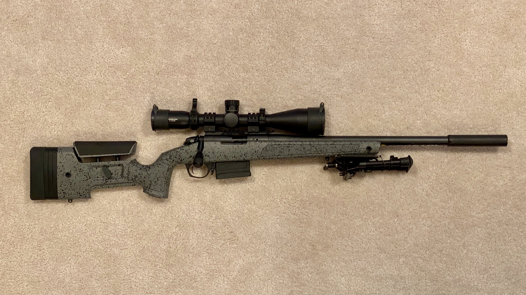

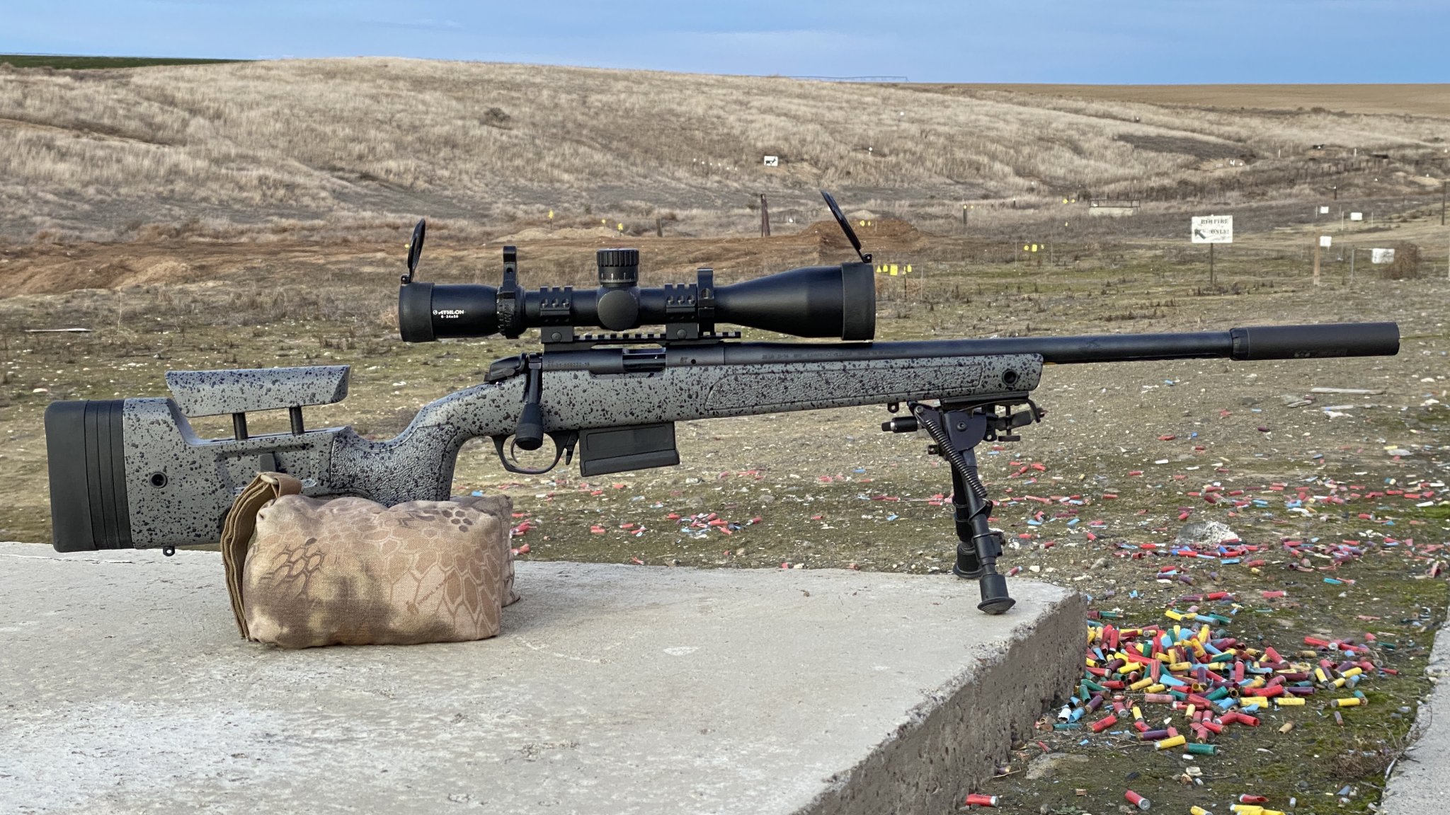

Here’s a mini review (still need to do some videos and additional ammo testing):
Finally got my rifle this past week. I threw some Harris bipods and my Athlon Midas Tac 6-24x50 on it since it focuses from 10 yards to infinity and started plinking around with some cheap CCI Blazer ammo. So far I really really like this rifle.
The bolt feels much better and smoother than the other rimfire bolts I have played with in the past and I think the bolt has even gotten a little smoother now that I’ve shot a few hundred rounds through it. One strange thing I noticed is that the bolt lift is actually LIGHTER once the firing pin has been released, which is nice. Typically, the bolt lift on rifles is HEAVIER once the firing pin has been released because the bolt lift is what cocks the trigger.
This is the first 22 I’ve had with a match chamber. Due to lack of experience with match chambers I didn’t realize that the bolt actually pushes the round into the rifling. Since this is supposed to be better for accuracy I’m ok with it, but it does make the bolt closure feel pretty heavy since you are forcing the round into the barrel as it closes, which can cause you to accidentally shift the rifle when shooting off positional barricades where you aren’t as stable.
A lot of people have been asking about controlled round feeding on the 22s so I decided to check it out for myself. As the case leaves the fee lips of the mag, it pops up into the bolt face and is then directed into the chamber. However, as the round enters the chamber, it makes contact with the top of the chamber, so it still has the potential to be slightly deformed before going into the rifling. I may try to add a video if I can figure it out. (It’s slow-mo, so it’s pretty long)
I originally planned on replacing the trigger right away, but after using the factory trigger during break in, I’ve decided to just leave it alone for now. Bergara claims the lightest weight the trigger can be set to is right around 2.5lbs, which is what mine was set at out of the box, so I never bothered to adjust anything. I would prefer a trigger weight around 14-16 ounces like my TriggerTech Diamonds in my match rifles, but since this trigger breaks very cleanly and doesn’t have any creep, it feels pretty dang good even though it’s 2.5 times heavier than my other triggers. I may switch it out further down the road, but it really is a pretty dang good trigger.
Another thing I planned on doing right away was to replace the stock with a KRG Bravo or an MDT ACC chassis to match my two PRS rifles. Unfortunately the ACC chassis are really expensive so I can’t afford to buy another one. After using the HMR stock on the bergara I’ve decided to stick with it for the time being. It is a really nice stock and has plenty of adjustability for me. I also like that it is heavier than the KRG Bravo which is nice for training purposes since my ACC is pretty heavy. The vertical grip is comfortable and has a perfect shelf for thumb placement by the tang. Unfortunately, there isn’t very much room between the bipods and the magwell for a bag. The bipods and mag tend to interfere with the bag (game changer, tactical udder, etc.) when shooting off barricades. I may end up adding an Area 419 Arca rail or something similar to the forend to get more room for a bag and to allow me to use my Ckye pod and my Warne Skyline bipod, both of which attach to Arca rails.

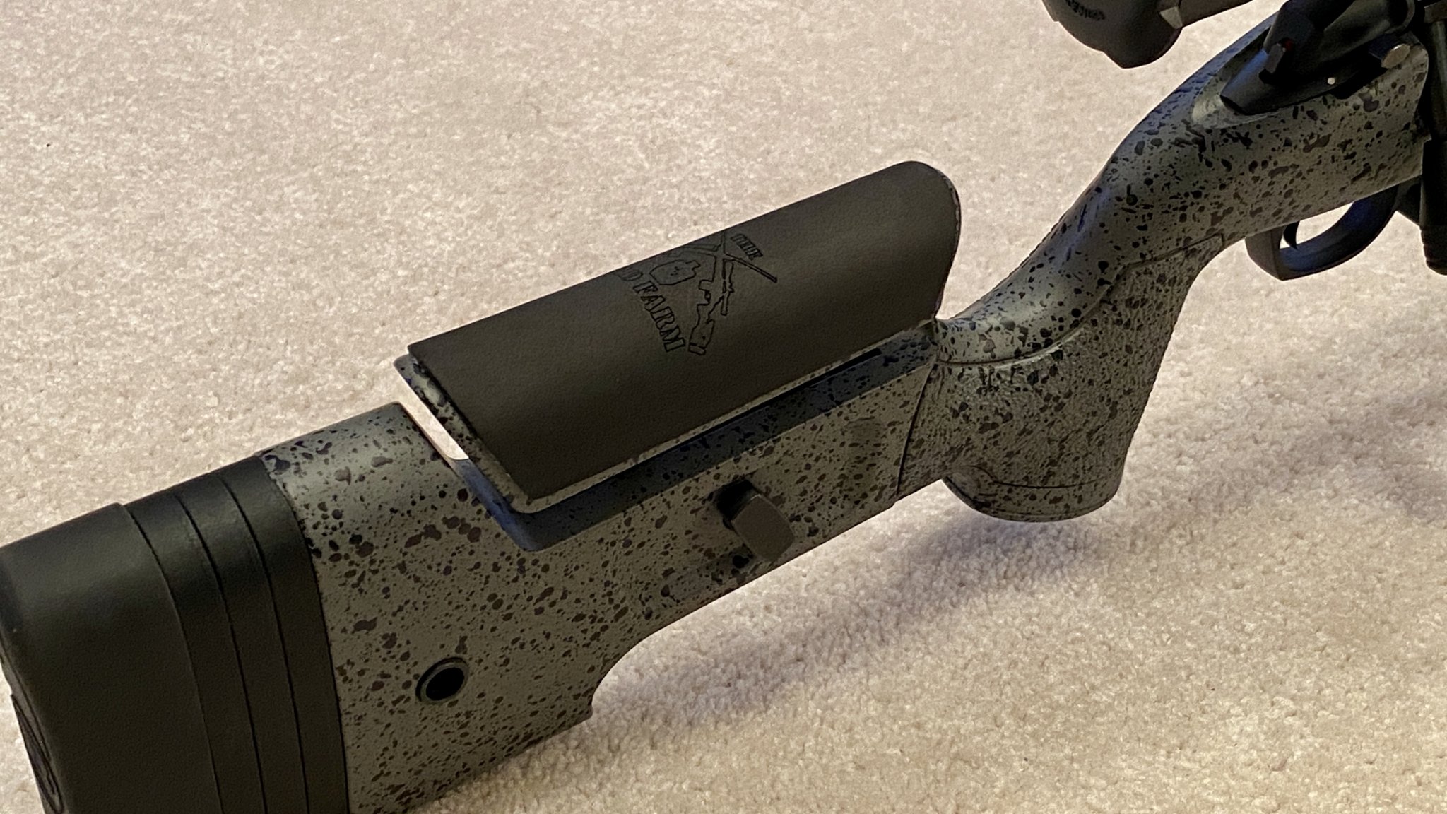

The one gripe I have with this stock (and most other stocks/chassis for that matter) is that the cheek piece is very hard and gets uncomfortable after a lot of shooting. Since I am a Cheapskate, I used the little laser attachment for my 3D printer and designed a pad that fits the HMR’s cheek piece and added a logo to it while I was at it. It is surprising how big of a difference a little foam makes. It makes the rifle feel much nicer and it’s more comfortable when doing high volume shooting.
Lastly, I did notice that the safety lever is really stiff when you try to put it on “safe” with the bolt closed. It actually kind of hurts your thumb. And yet, it switches to “fire” very smoothly and easily. I think the lever may be interfering with something when the bolt is closed, because if you operate the safety lever with the bolt open, it moves smoothly and easily in both directions. This may just be an issue with my specific rifle. It would be interesting to know if this is an issue for other people too.
Sorry I don’t have any pictures of groups at 50 and 100 yards right now. I’m still waiting on some higher end ammo to show up this coming week. I did, however try a few types of ammo that were available off the shelf at my local sporting goods store. So far, I have tried CCI Blazer, CCI Standard Velocity, Norma Match, Norma Subsonic, and RWS Target Rifle. Surprisingly, they seems to all shoot very very similar. If I had to choose, I would say the super cheap CCI Blazer and the RWS Target Rifle seem to be slightly better than the others. I actually took the Blazers out to 400 yards, but obviously the group size at that range isn’t so hot. I needed to dial 20.8 MILS but maxed out at 20 MILS with a 30 MOA Seekins Precision base and my Athlon Midas Tac 6-24x50, which has 25 MILS of overall travel. I kind of wish I had bought the 40 MOA EGW base instead, but I don’t think I’ll shoot 400 yards very often, so it shouldn’t matter. I plan on testing some SK, Lapua, and Eley ammo soon as well to see what the higher end ammo can do.
I apologize if this post is way too long, but I figured some of you may appreciate it. When I was looking for reviews earlier on I could find any in-depth reviews, so I just had to find out for my self. I will try to post up some accuracy tests soon too, since that is was people tend to want to see most.
I’ll include some pictures of my rifle with and without the cheek piece. I may do some videos soon too.
