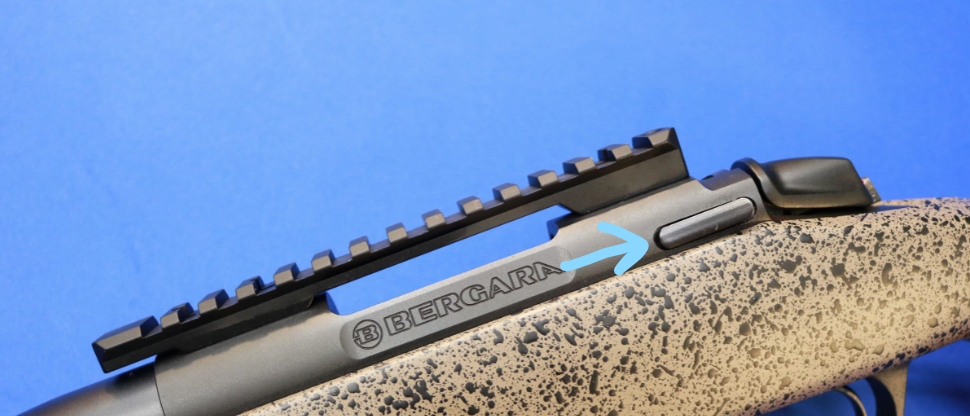

Do you mean taking the whole bolt out to use the Hornady OAL gauge? It's this button on the left side:
Open the bolt, hold that down, and it will slide right out back.
No, he means the extractor and ejector like he said and was talking about. Not the side bolt release.
