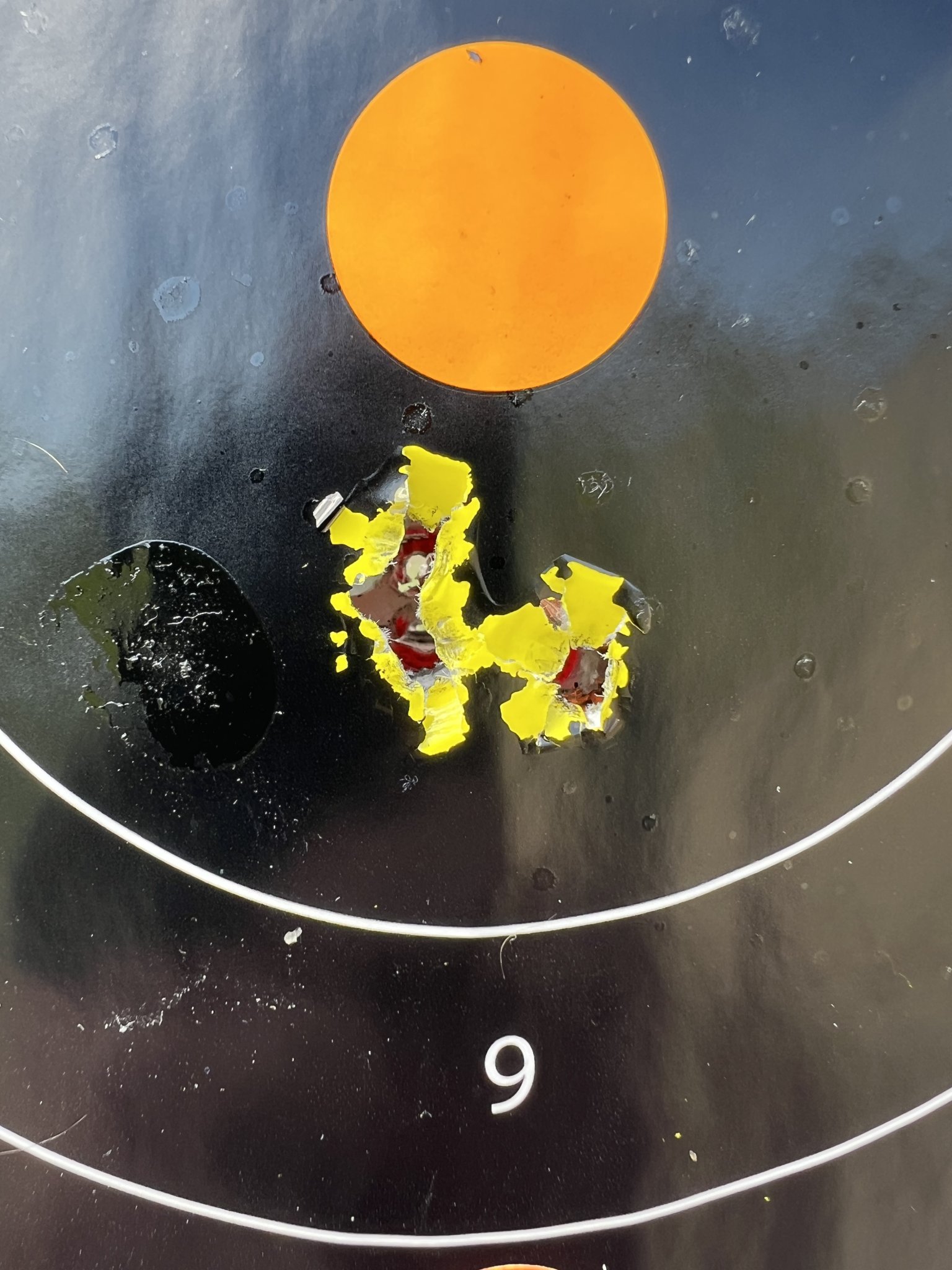

Update: so the FGMM cut a .9 inch group. Also let the barrel sit for ~10 minutes between each shot. Can’t complain, it’s definitely a well built rifle and really light. Finding a hunting round that groups is the next step.
