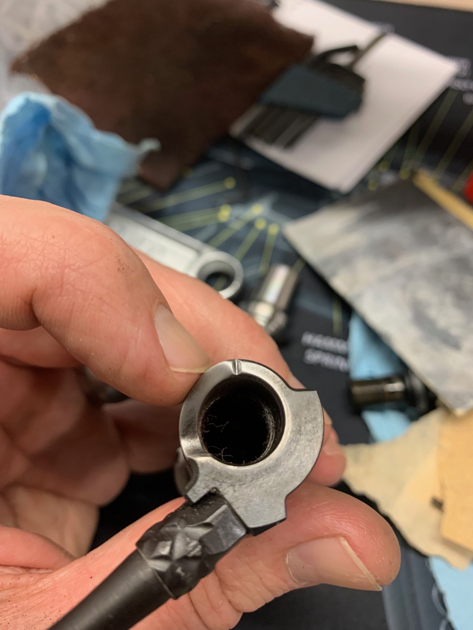

After reading your suggestions I tried to give the bolt a thorough cleaning, but I'm stumped. I can't find instructions on how to take the bolt apart. The manual doesn't cover it and I am hesitant to just rip the bolt apart. Is there a procedure I should follow? (In print would be helpful). Thanks again for the suggestions.

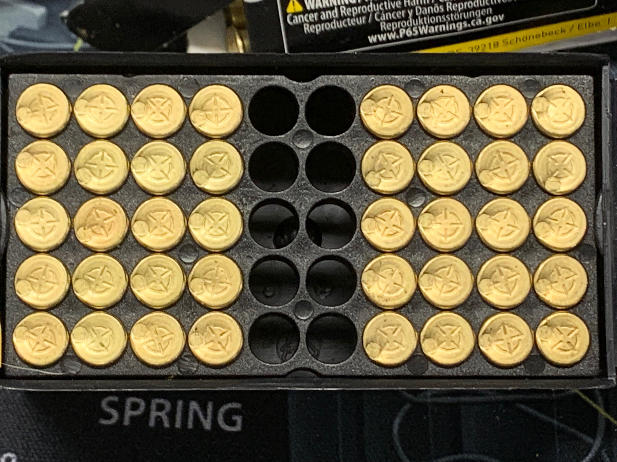

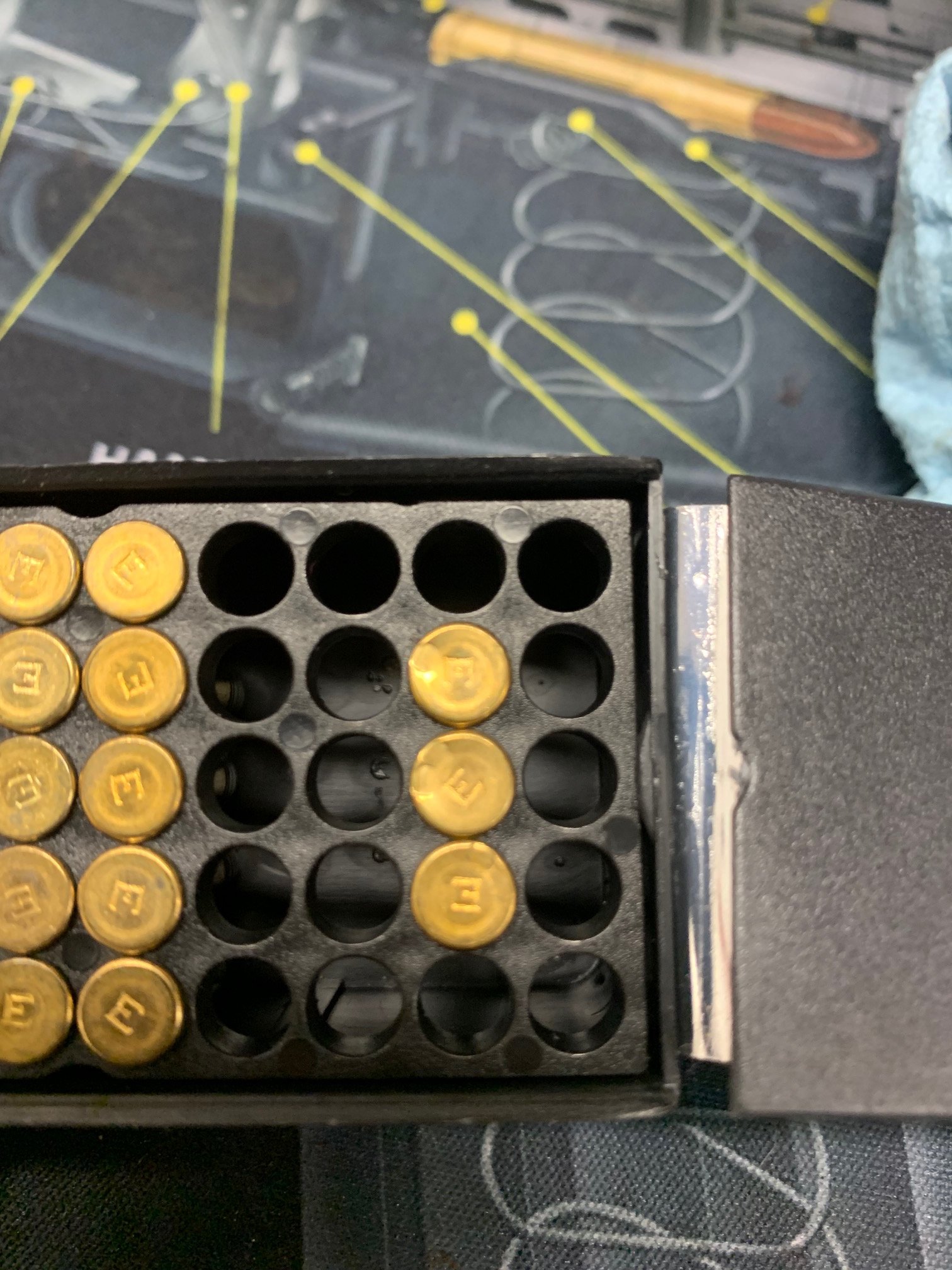

This is the results from the drop test.
DgNhTz-O-d0mO-ayePA23BzJI5vt1eu2CDeEiO_n4hmzAG4Pw2yf7IU8odXshOjZET_pR80-vWkFtBWW8Vq0HftnLExoPSRaG78WUYD1Yg9HZqNZrth3APCuboXBjk5gnY_mA5meoDcU32PW_DTT8b2j3DPomd9s1oM1HX615WK552jDZuwDsa5QJW0gaU0lXxDBqxul6ten4VZj-TGtztEw12a9e1RtytoEkcrg3ax-hNTAzmjGtTtvEO9WXzGQB01CXiKyD7AyXbxfgErLFX0mEmiixF1DwTyRixLVRoD0ulybfJDsE6Zy8R2FZG_Yw7vmPn_ieSFcnr33NUv5gv0kM1GoeRmhIaIXCY6rQ8ctrvqbg1BzO1F2jWBUtgW4wpAYae7nAGEH8ntOH9GY7HOTQtpvhxUVf-c1CBYyyZvt-Tr3tVWdJbRN56EYl7gDKB6GzWoAZrXh_EUgcfJXCPChy8Edv8lNYJCW-lED0J4M097hFPqFHkKkO4GV26I-GLs5id6ura32Qb7A8bUNFmNd9RuFwHUH7r53pyoQEKcaEefinAnEswP6H1XAVtzZopBoNLX9qOZiaeqXDkUYcMuCfBtn298DQrQEnW48R5TKCvw2XTi0B8wX1a0h_pnbCAaJq031sMMULcBooYsZPiZG7ghBaS8Tvd8k2MyrrQ4DFv5siVfGfbLLaAif=w689-h573-no
Rim up was okay...open case mouth up...primer busted loose.

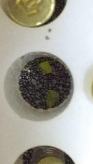

View of the primer chunks in the powder
y8YYRaVoTcE907PokWuGJqiOgnUTuoxasTd16gIC0KAcaCYOZpllzrXi0KLPvQ1SbwCLoDlmwWLgWt_ruG_UhyzoXmfjhli90P8diUMlaaQrYmhjKUnH1dxgMWo27S_ueB-X_cDSpjPpktdzSvbD5MrFmMxtob9COWy52oi4uzrADnsUhO-BZWWwY9R9dYSfIQ_hEZY_KlFaLtVdcUtfFbPJ_6YATXsf4z1AmA7kjZE8LwEmw1KZ2vNoq1SN7iHknCqh2koaqJ7Cx7fH75YGxH3EmsPrR03mEq9OI2tMCXIQNH2-huLu3id46rQun0kxb0qqHSQN9OrV5yIV2H3zHeZZljoRJxI0hqbZeImPxqCUps91zB7xqT-0nPhV0ypNaTEvVIAavAmqp-kxRmN-cVC3zzO8N_3-AyQL6Z4YGIfkMViMCJGLdloNgVLDkvLo_W88AG04MgpJ_guhARFRzF_tAaKrSuV0CVrAASHH53LHdFjfM3CYEte7dS-J5nEMq9IUh7fNSR8sb2Equjf3r_yNxlZlUKRdr0SNf4Pm5dvBsvGP6LASoMiBdcVcyg-un2PLVgd7LhDNdPT8DCKg7TMpgX30F8UoJEpegwoRp4rncgayB_HNKx4bdZq0wsvPXg6YSbcZsK0R7_LEzsjAFmB4JIW4qTjYxj9C281zdxZDCL0L4FUBwlgRtG3u=w324-h570-no
W1Qi4I4SYYKT1Me4C6HR7pPBsdo3-Ch2L_ZdSFvEy87SXm6bXYeoO0ylQcX2yYkMJKN_JABJUCZj9ROVL_KZluQKN5G1LwQg4xiJKBdxe5CicMpqpMJEAVnQCLwEYzbPw38eqgNF71Gmw-RSqF0R_-_Y7oHhcKEbBszXCZD5uNOi2otajue-xIdKuRTIlhz2yqVJHyPTcvrdtM3jsVr0DqKr8ZEn59HEMices9LIHG5mF5u2sYX9cGaSn3kwDngblwFQsksQuAwWwpwXPC0B0UCDs7ewVrPDOtuFNBDkThz116BJg5Yi8iZdVher5rqALDjosY9i3E88FCf-G18ZPnZA77cYNJ6FNuGDdGfEIHqwhGDkuD9-nRUPhU_mti2e06EZKJ01ivuHh00y63ATqjLIHlVpFw0mBDI_Is85dm3TtRX7maf8FuaILWwly2Fj7Hy3C0iI9tfkHH8xpO-vrw8_nXad9sZ0yG2WJEshz0_3RS9E7tceQcCtD2cREpfiW9FjS5zxsFSST4kr4gqYI6zrr63pgA4Rdly8S2ACMLgv08IfEEyI0aykmY1o80XqL6aP66JBSsItNuHojM1ZDvFF8NR8sr4GibD5HWfcRrwyC0Z3zHzgpOsYmM1j7dNK2D-NI-9TO47uIvHQBC4uL9cbjObXMZ-go6hhK-CzWone86uzVvyFTULsEWn1=w279-h481-no
That's the results from a single 36 inch drop.
Think of what the cargo handlers from the shipping services
do with those ammo deliveries on the way to y'er front door.
Rough handling will knock that primer out of the rim. :(

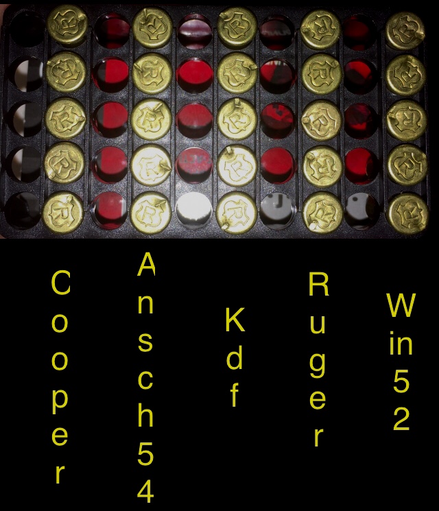

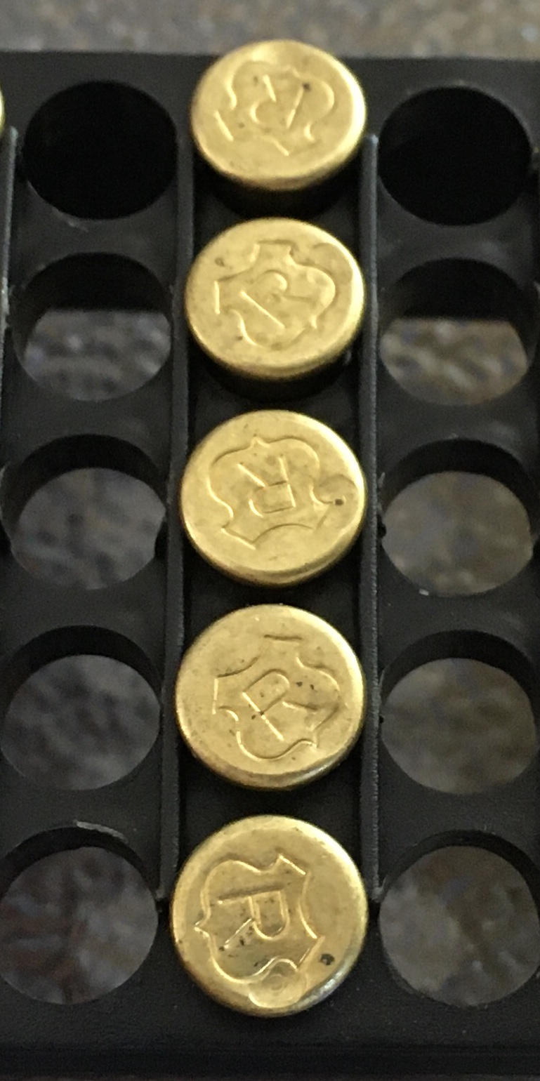

Light strikes is my ONLY complaint with my B-14R.
It’s a phenomenal gun otherwise, but the original pin caused plenty of failures to fire. The above pic is after they sent a replacement pin!
I’ve had no further failures, but that is still a source of fliers.

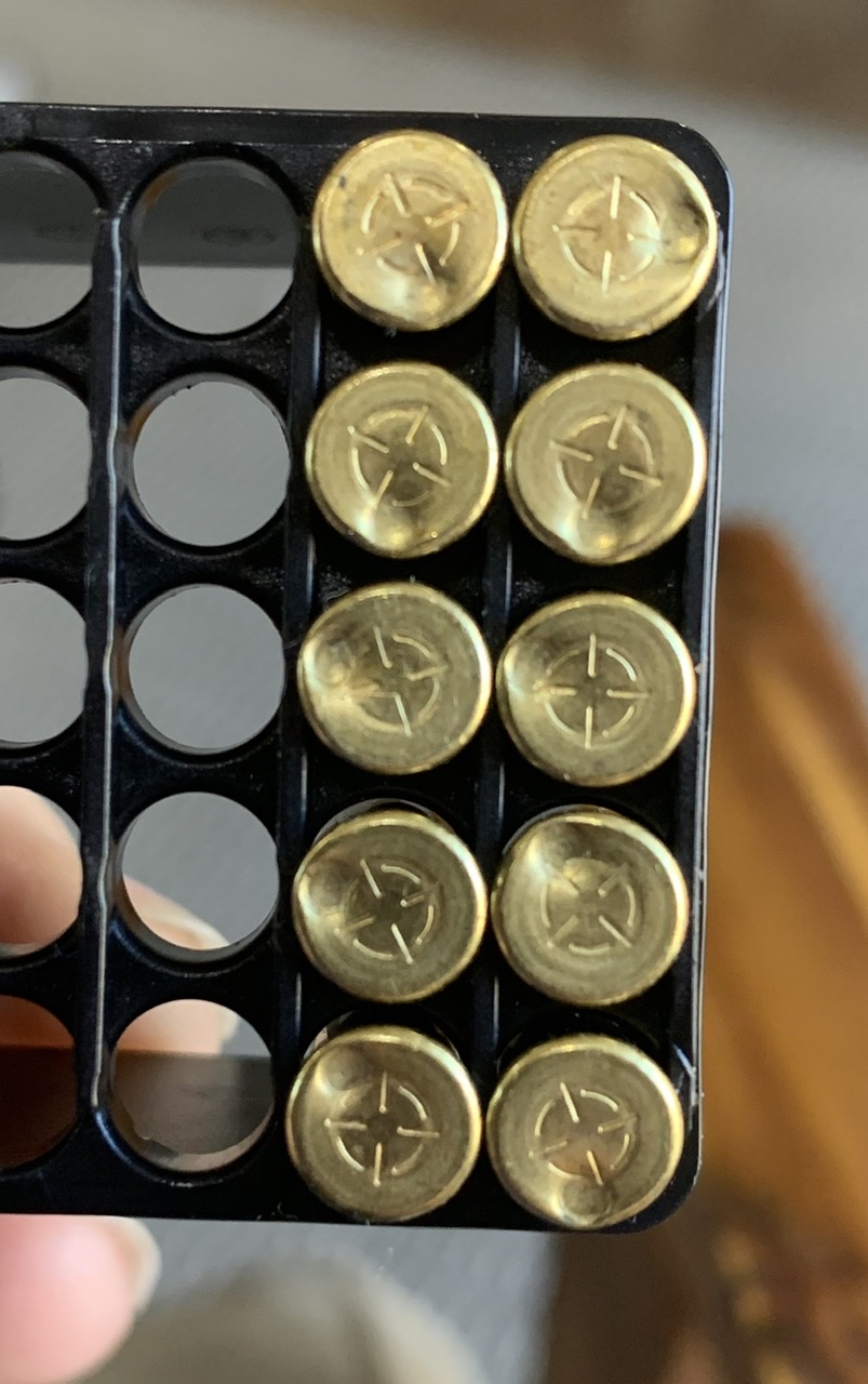

I went out to shoot for the first time with new lighter spring and to zero again after moving my scope. I only shot 100 rds, but no issues. Gun ran flawlessly. The lighter spring definitely is an upgrade and takes less force to run the bolt. I’ve been nothing but happy with my B14.
I rarely collect 22 brass but I did so to clean up where I was shooting. 20 casings on the left are fired with the new Crossroads Precision spring. The 20 casings on the right are with the Bergara spring. The Bergara spring definitely dimples more and distorts the brass more. The CRP spring is a cleaner strike. Less brass distortion. This is all Sk ammo.

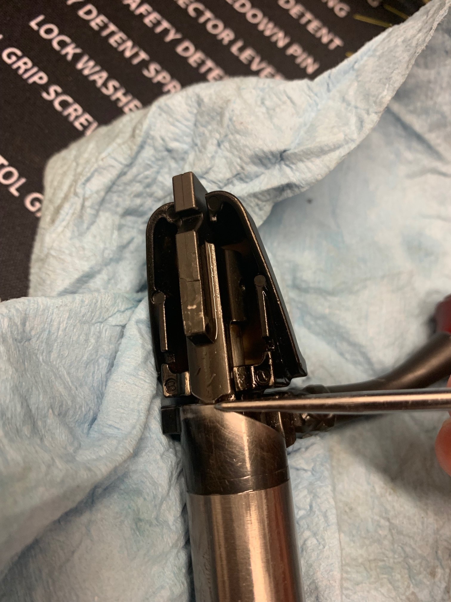

I too have polished the cocking ramp as well as removed much of the material from the groove. See pic of groove just above my index finger. The second pic is the black metal piece that rests in the groove. When working the bolt, it’s much easier with the groove filed down and polished. The bolt runs a lot better with less force to open and close.
As for wanting the lighter spring, it was to make operating the bolt easier and it does. Accuracy has not been affected by the spring and didn’t expect anything to change. Just an easier working bolt.
