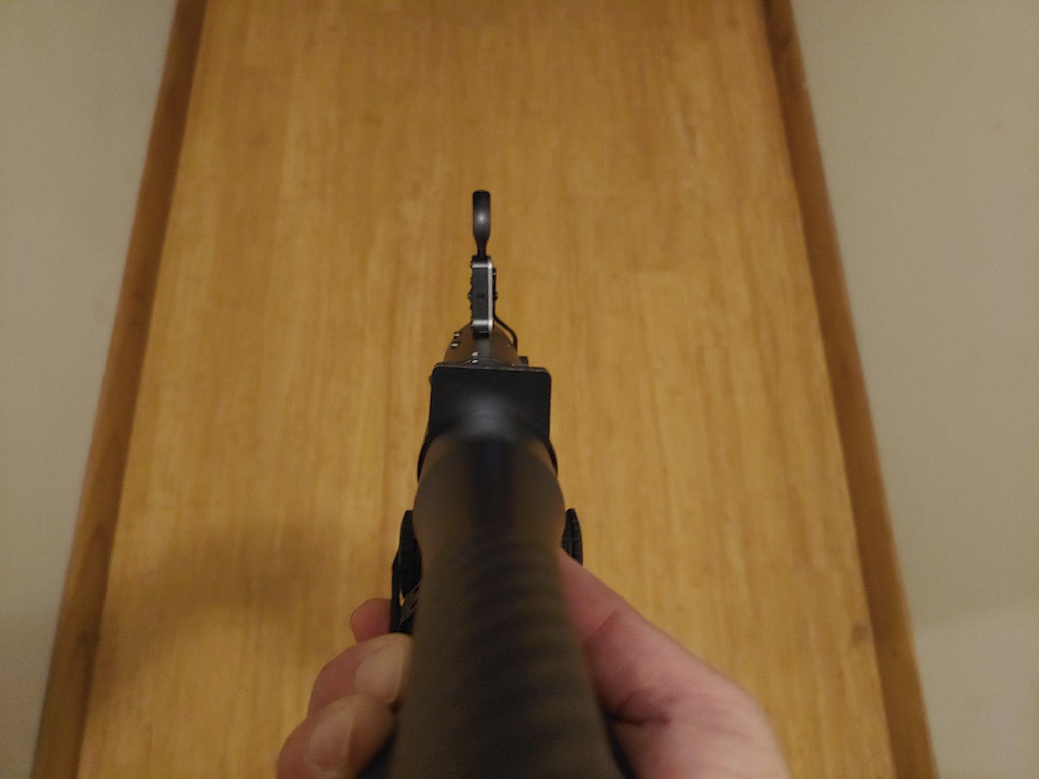

So I picked up a B-14R CF barreled action a few weeks ago. The good news is that the rifle is capable of sub-MOA accuracy if I do my part and use good ammo. So far, it seems to like the slightly less expensive SK Standard Plus ammo, and I average .33" to .46" groups at 50 yards. The bad is that when I dropped it into a spare HMR stock I had laying around, the barrel is visibly off-centered within the barrel channel. The barrel isn't touching the stock, but it is close in some places.
Pulling the action out and looking at it a bit closer, it appears the recoil lug turned a degree or two when the barrel was getting torqued to the receiver. As most will probably know, the recoil lug in the B-14s, including the rimfire models, is a separate piece that sits between the barrel shoulder and receiver face. Unless it's secured while the barrel is getting torqued on, the lug will have a tendency to move with the barrel. While the B-14R has a cutout in the receiver to keep the lug mostly centered, manufacturing tolerances leave enough room for the lug to rotate a degree or two in either direction. You now end up with a lug that isn't square to the receiver, and will cause it to sit unevenly in a stock or chassis depending on how deep or shallow the lug inlet is.
Has anyone else encountered similar? And if so, how quickly was Bergara USA able to rectify the problem? I've never had to send anything back to Bergara before, so not sure what to expect. I have a B-14 chambered in 308 sitting in a Magpul Pro 700 and that rifle (apart from a loose bolt knob which Loctite solved) has been problem free and is square from barrel, to lug, to receiver.

Good to know. Sent them an email with the same photo and serial number. Hopefully, they'll be able to get it sorted quickly. Apart from this issue, I do like the rifle and it performs well. Given the price of primers and the lack of powder these days, my precision bolt guns in 308 and 6.5CM are taking a hiatus. I bought this rimfire to scratch that itch which it has done so admirably. I'd hate to be without it for too long.

OP, you're wrong. As long as the sides and bottom of the lug aren't bearing on anything, its angular orientation is meaningless.
Reactions: supercorndogs
I t would be meaningless except the lug has an extension and as you rotate that extension it kicks out at the end of the lug. Look at his pic, the (as you are looking at it) top right corner of the lug is sticking out to the side a bit. Enough to kick the barrel over depends on how tight the tolerance (hehe could not resist) between the lug and the side of the cutout for it are. Maybe grind a bit out of the stock where the lug hits if it hits?
I suspect the barrel not being centered in the channel isn’t related to the lug, I think it’s an issue with the stock. The lug would tend to just make the BA sit rotated in the stock (you’d see this most obviously at the trigger, if it was visibly off-center in the bottom metal).
Hmm, possibly. I'll look at the stock more closely later tody but I don't recall my 308 action sitting in it off-centered. Since moving the 308 action to a chassis, I fgured I'd use the HMR stock for the B-14R. Now that I think of it, the barrel could also be slightly warped, but given the recoil lug's cant, I assumed that to be the source of the problem.
This is what I was thinking as the action sits centered in the stock when the action screws are loose. You can feel it wobbling at the area where the lug sits in the inlet, hence my theory that the lug is pushing the action over to one side once it's torqued down.
Uh, that's the same thing I said.
The recoil lug doesn't have an "extension". The whole tab is the recoil lug. I kinda have seen it, since I have that same exact rifle.......

FWIW, Bergara USA was very quick to reply. Had an RMA# and prepaid UPS label sent to my email at 9:00 this morning. The barreled action is on its way back to them. No muss, no fuss. So far, the CS received from Bergara has been leaps and bounds better than some other companies *cough POF cough* I've dealt with.
As for in-letting the recess for the recoil lug a bit more in the HMR stock, that would be fine if I was intent on keeping it in that. It may not sit correctly in some of the aftermarket chassis I've been considering though. It's a slight inconvenience to have to send anything back, but I'd rather let Bergara fix any issues now.
