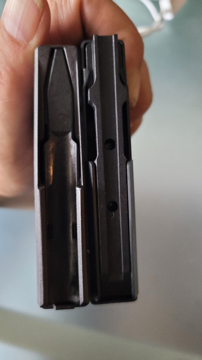

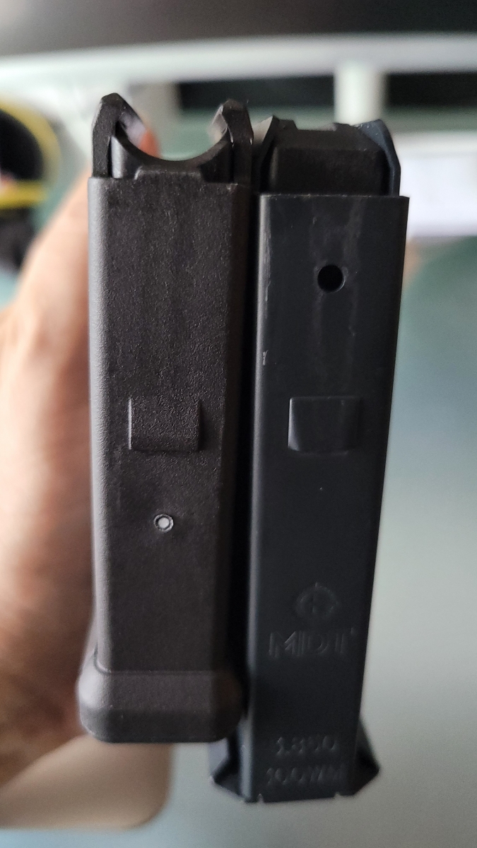

My buddy bought a Bergara HMR B 14 chambered in 300 WM after he saw me run my 300 PRC out to the mile and was impressed. But..... he wanted it in 300WM and I get it as ammo is way more available for the old tried and true 3 hundo .
anyways, I noticed when we set up the rifle that the mag that was supplied with it is a pmag type magazine
Anyhow, I told him to get METAL MAG
Aics type. so there is a member on here that sells the 3.850 made fir savage for like 60$ on eBay and he bought one ...
He got the mag and It it’s slightly to long !
I thought the 300 WM and 300 PRC had the same mag well ??
anyhow, can anyone tell me what length of mag he should use as this standard 3.85 is to long ?
Bonus is I got a free mag lol
Any help is appreciated .

Most 300 Win Mag rifles take a detachable magazine length of 3.715 (SAAMI). It only has been the last few years that some of the rifle manufactures have moved over to the longer 3.850 (CIP) magazine length for accepting both 300 PRC and 300 WIn Mag for cost savings. Your buddy's rifle needs the 3.715 length AICS type. He could call Bergara and see if they have a bottom metal that will take the longer mag or buy an after market chassis, like the Remingtion Long action KRG Bravo chassis that takes the longer length magazine. Though I would check with the chassis manufacture before buying that the Bergara will fit.
As for AICS patterned magazines, look at MDT, AICS or Accurate Mag. Cadex Defence has a nice CHASSIS VS MAGAZINE COMPATIBILITY PDF with part numbers and sizes you can use for reference.
3.715 Mag internal COAL sizes....
Magpul 3.500
MDT 3.625
Accurate Mag 3.615
Magpul 3.500
MDT 3.625
Accurate Mag 3.615
