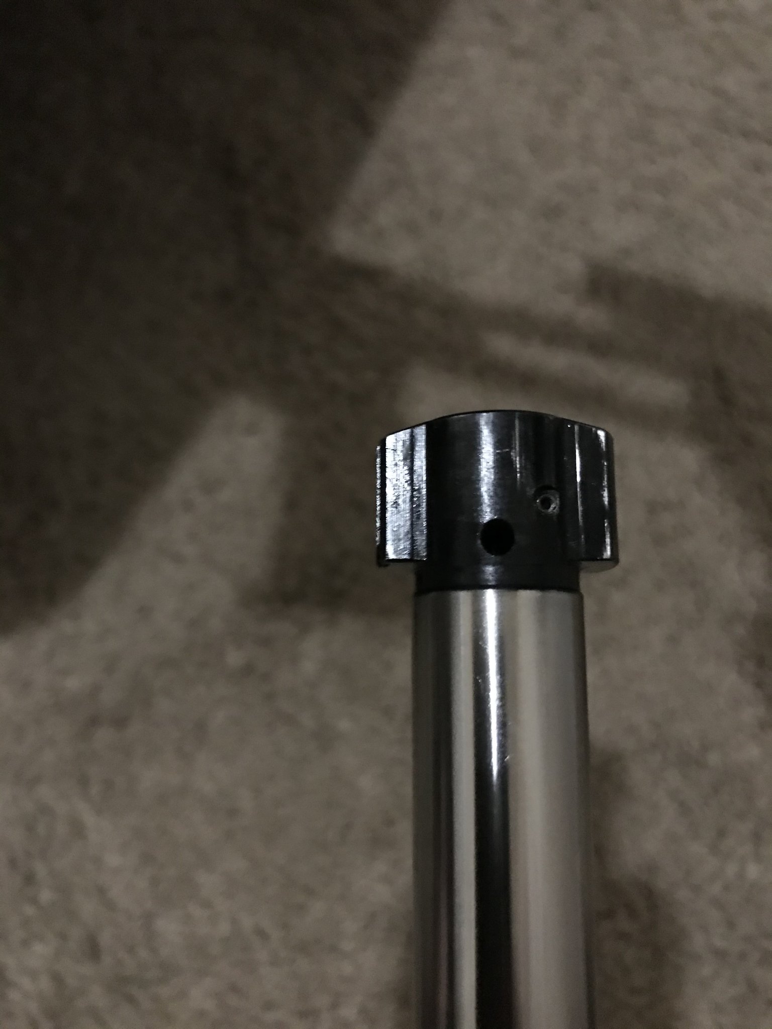

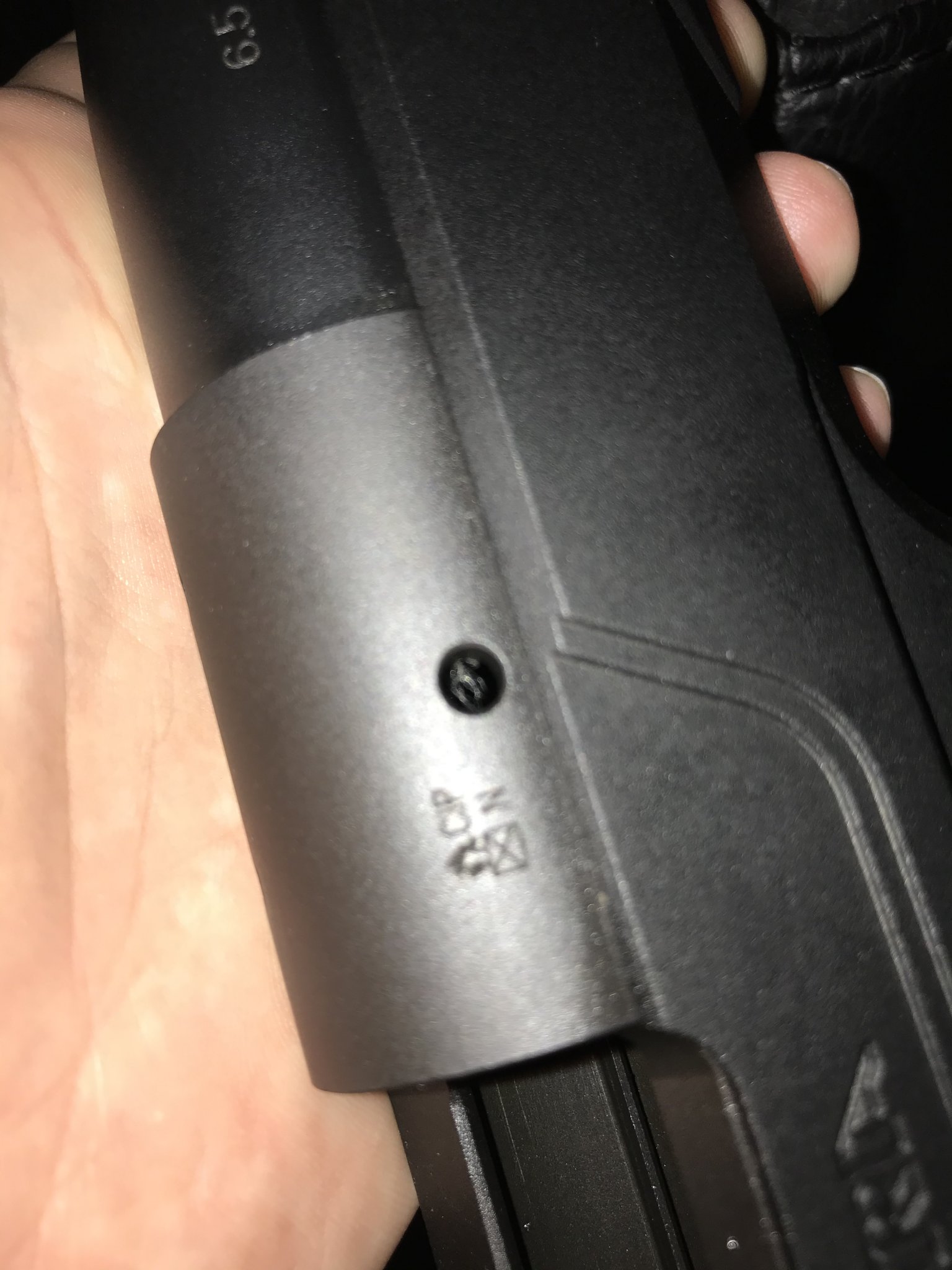

Found something interesting. There actually is a gas relief hole in my bolt, not as extreme as howa’s however it doesn’t make sense to me.
The hole would be positioned at the 9 clock position in battery while the receivers gas exhaust port is positioned at the 3 clock position.
Though there may be enough space for the lugs to move around it seems to me that it would choke the gas flow enough to maybe still create enough pressure to pressurize the firing pin enough to slam it into the shroud.

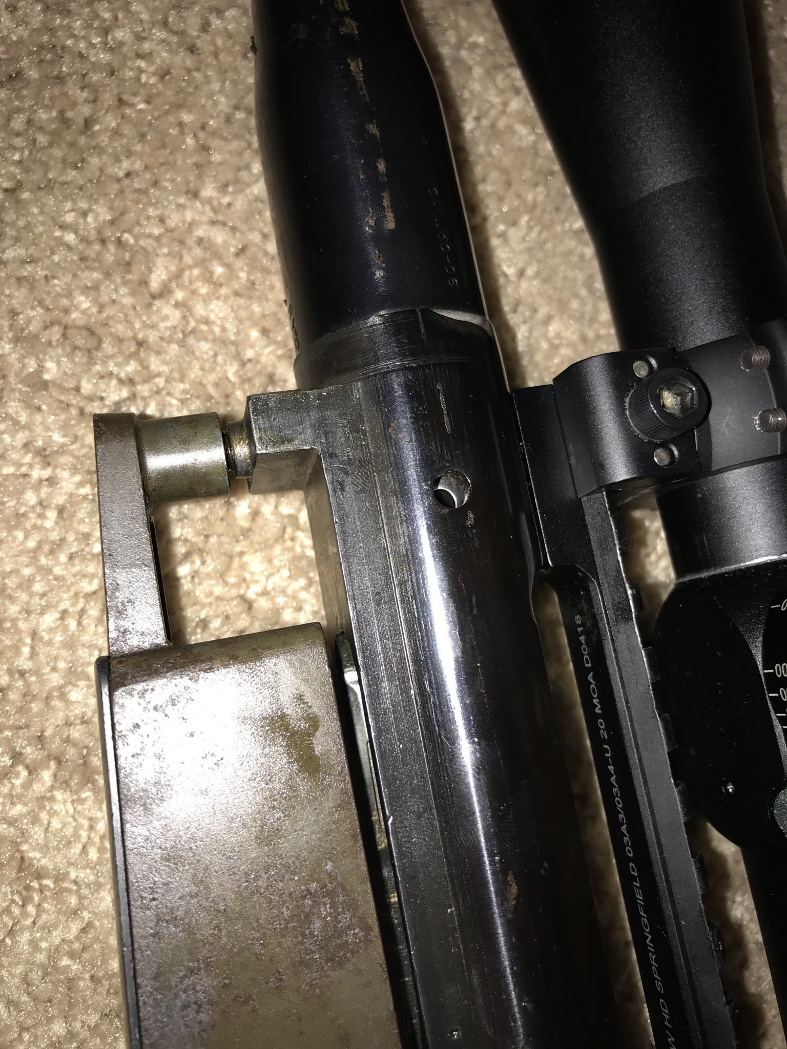

This is on my Smith Corona 1903A3, notice you can actually see the relief hole in the bolt line up with the one in the receiver.... perhaps there is a reason for this as this rifle craters primers like no tomorrow and probably has for its 70+ years of being around. Never has the old gun ever pierced a primer.... yet.

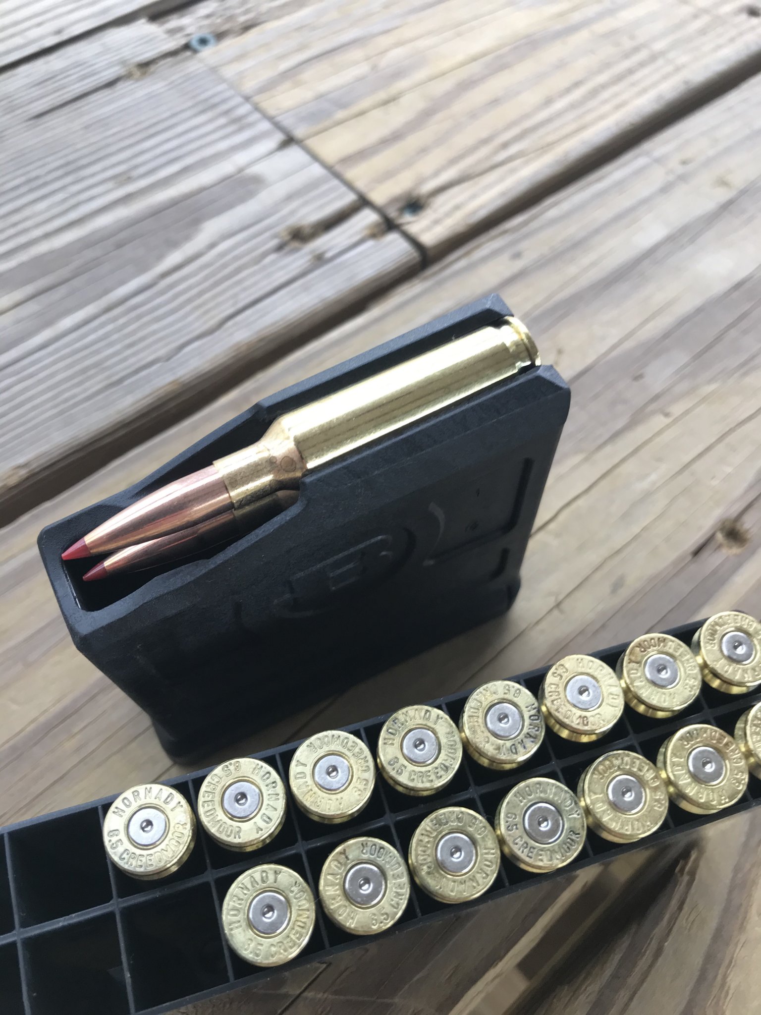

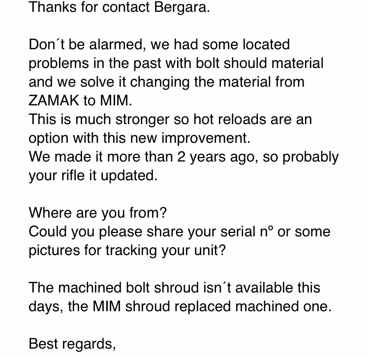

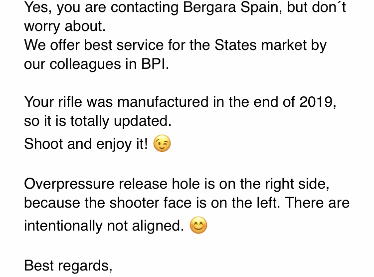

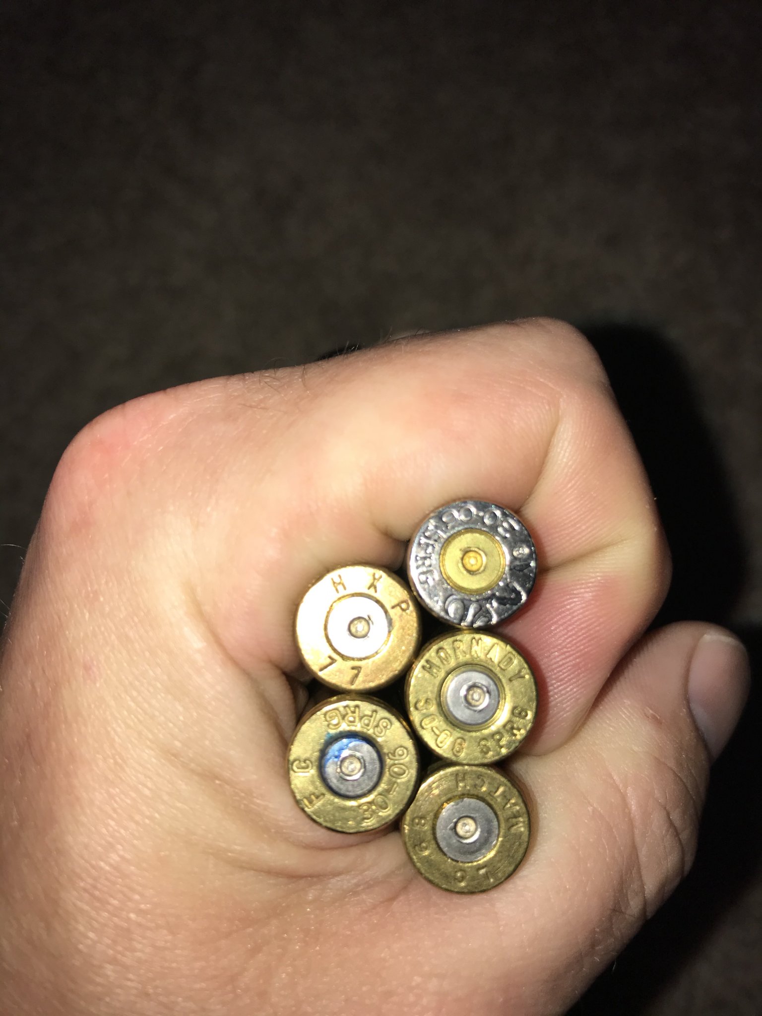

I feel like it’s time for my range report and conclusion of this thread.
I contacted Bergara BPI through phone calls who said the problems with the B14 rifles have been addressed and all new models are unaffected. In regard to the gas ports not aligned I had to contact Bergara Spain through email addressing both the shroud and the gas port misalignment.
I will attach email responses and pictures from the range. It is fair to note that I am not the best shooter so I don’t think I am capable of holding a sub minute group as of yet. They did have a ransom rest however I opted to not use it and fired all shots from a Harris BRM bipod without the use of any bags.
Followed bergara’s barrel break in guidelines and cleaned after each shot for 5 shots, then clean after 5 shots for 50. Ammo used was Hornady ELD Match 140 gr, Hornady Black 140 gr, and Hornady American Whitetail 129 gr. Point of impact at 100 yards after switching ammo was minimal, almost not worth noticing.
Glass being used was a Steiner P4xi 4-16x56 mounted to a Badger Ordnance 306-06A rail with Steiner’s T-Series High (1.25”) 34mm rings
I am happy to report out of the 60 rounds fired I have had experienced zero primer craters and the rifle performed flawlessly.
Hats off to Sirboom he was spot on I doubt I will ever have any issues with this rifle.
If you were thinking about this rifle I would recommend buy brand new and don’t look back.

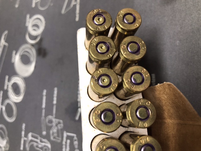

I have been shooting some Lake City Match 175gr M118LR that I picked up 6-7 years ago. No pierced primers, but mild cratering. Here is what the primers look like. Should I be worried?
