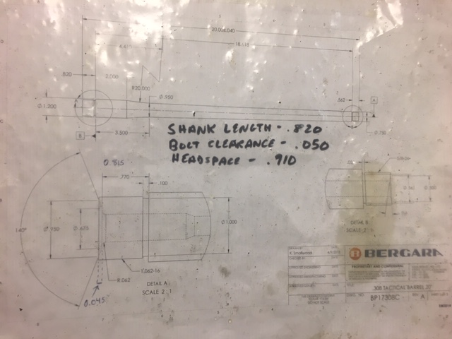

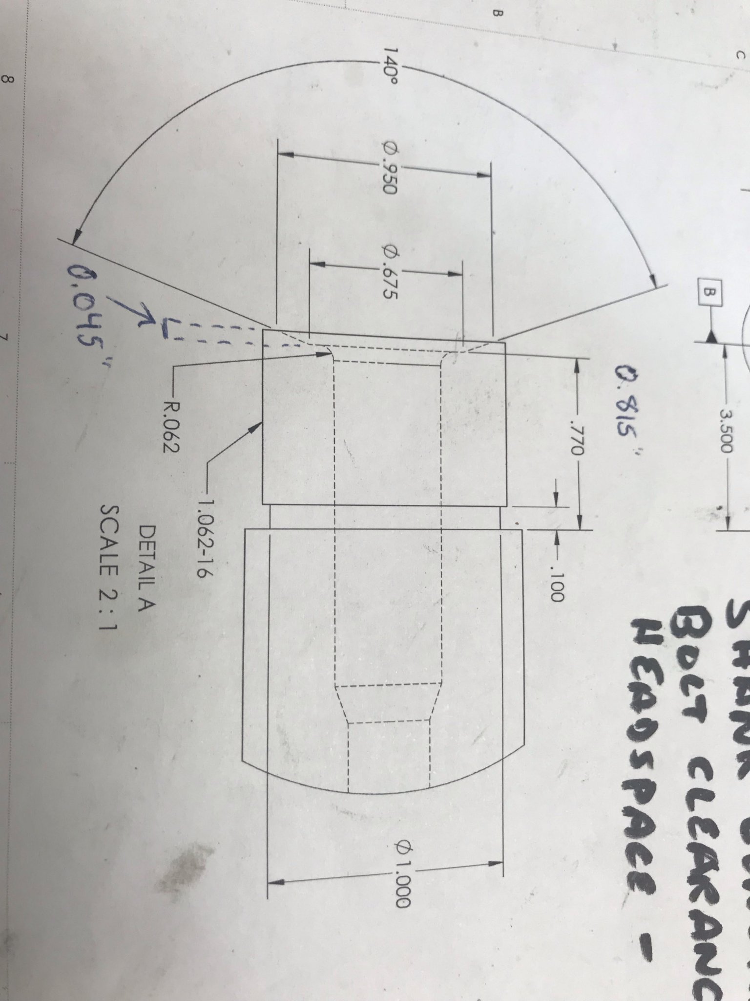

Well that's the issue, the coned nose bolt.
When I asked northland shooters I was told, words more words less, that unless Bergara released the drawings of the action or someone sends one in for them to use as a template they had no way to make prefits
They could buy a rifle take it apart and do it I guess, I am no machinist so don't know
I guess they're not interested in making them for now
Best pic I could find, sorry about the quality
