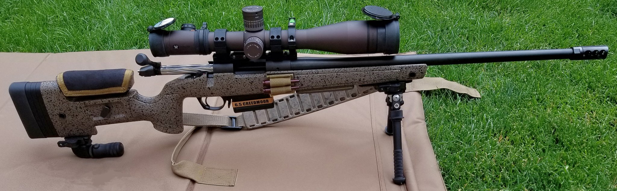

The TriggerTech Remington 700 Special took my Bergara HMR from great to excellent. My B-14 HMR had a pretty good trigger but the TriggerTech took the rifle to a whole new level. It is set to within Bergara's described pull weight parameters but it feels at least 8 - 10 oz. lighter, and it improved my groups with the 6.5 Creedmoor match grade ammo that produced .7 MOA groups at 100 yards to .3 MOA and with the ammo that produced .3 - .5 MOA before to .1 MOA.
You must be quoting one of my old posts although I did not post on TT page, has been totally worth it for me, especially since I recently upgraded my bolt to the Bergara Premier SA bolt. The Bergara trigger was nice but not anywhere in the same class as the TriggerTech Special, even Bergara is using TriggerTech Primary triggers for their premier series now.
Reactions: fanninland
