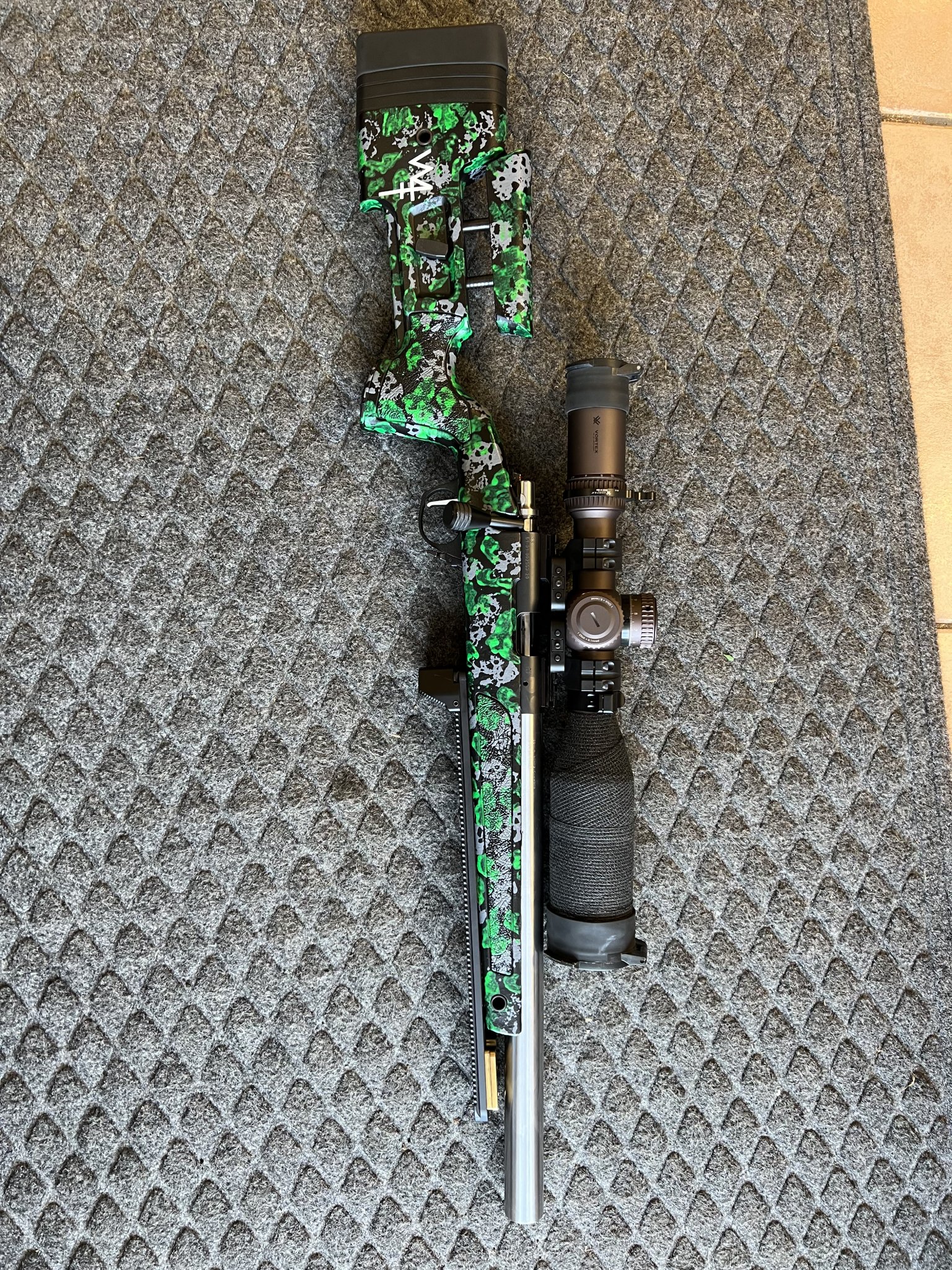

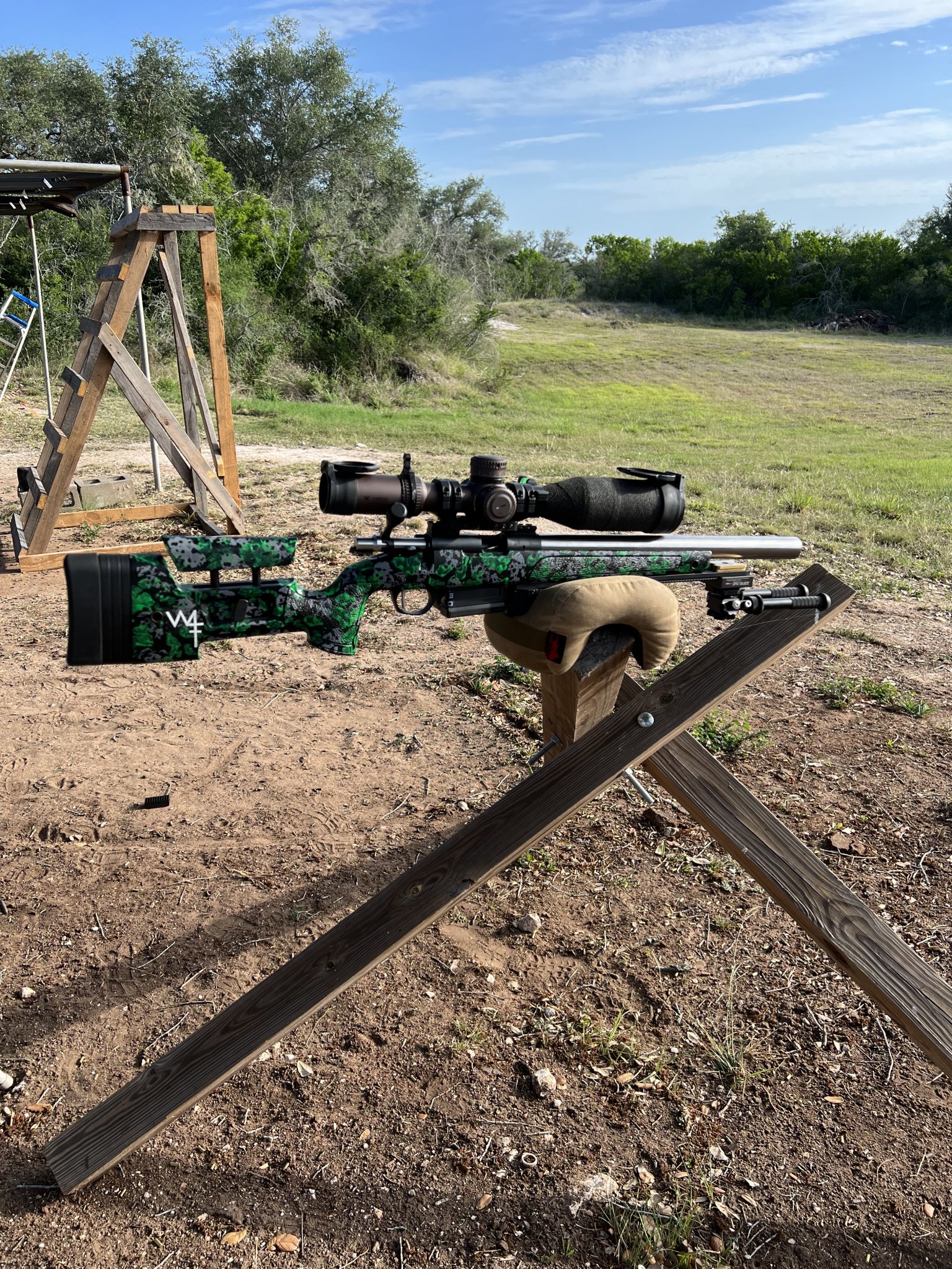

Here's an IBI fitted by a Canadian - Looks the part!
