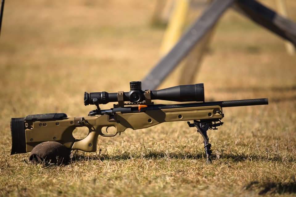

Believe it or not you can still strap heavy shit to the carbon version and still easily have a heavy but not retarded heavy rimfire. The rifle pictures above is still 14.5lbs. It does barricades and unsupported just fine.
