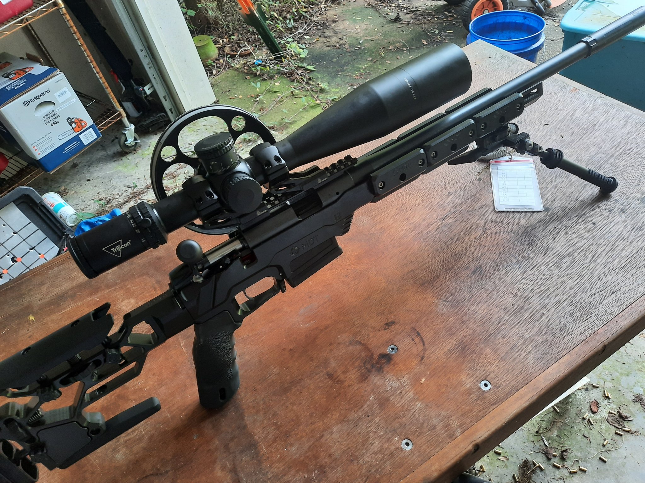

My v22 has lot tested ammo and my stock B14R shoots on par with the V22s ammo. That's a beautiful thing.
Like most people, I don't need another .22 but I want one. I know people have been having problems with their V22
but I did not. . Mine went in an MDT LSS gen 2 chassis and it was a perfect marriage.
No magazine issue, FTF, FTE.... no problems at all. I put my B14R into the same chassis using the same trigger Tech Diamond
trigger and it worked just as well. As shown in the photo they were just over 18 pounds.
It had four weight sets and the rear stock weight. The LOP was 13.5". The rear stock comes in two lengths. The short one was
$100.00 more for some reason.
Had I accidently bought the cheaper one, like I nearly did, I would have lost all of the butt stocks adjustment because it's
an inch longer.

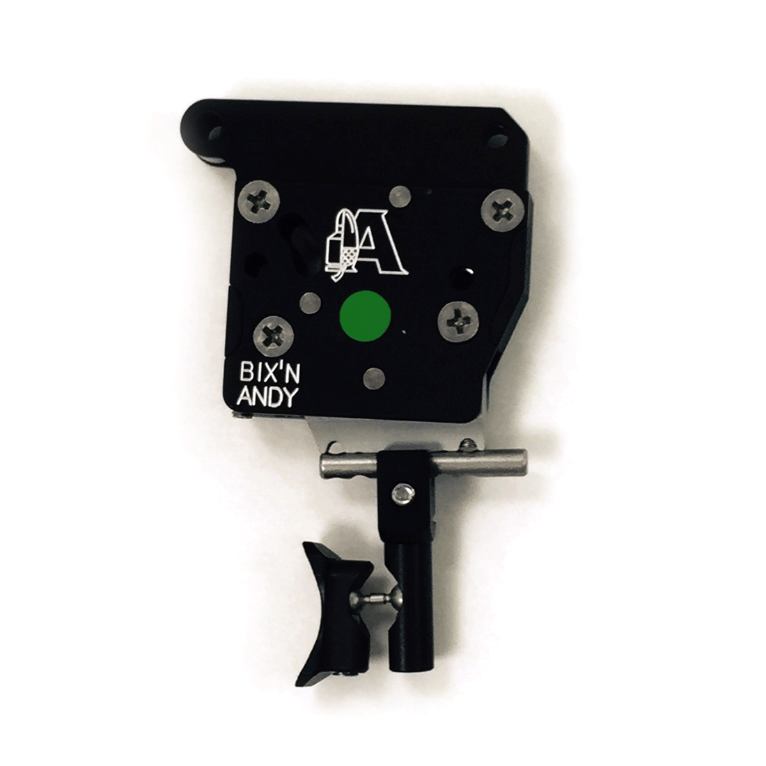

I had altered the B14R trigger with a #6-32 long nose spring plunger and that got it down to 11 ounces and added an adjustable sear stop.
I went too far with an #8-32 and that drove me into a Jewell HVR trigger. I really like it but I cant say it is much better than my TTD.
I want a Bix-n-Andy trigger with a free rail. Image #3. I have the SenSive blade already so I have to buy the trigger. LoL

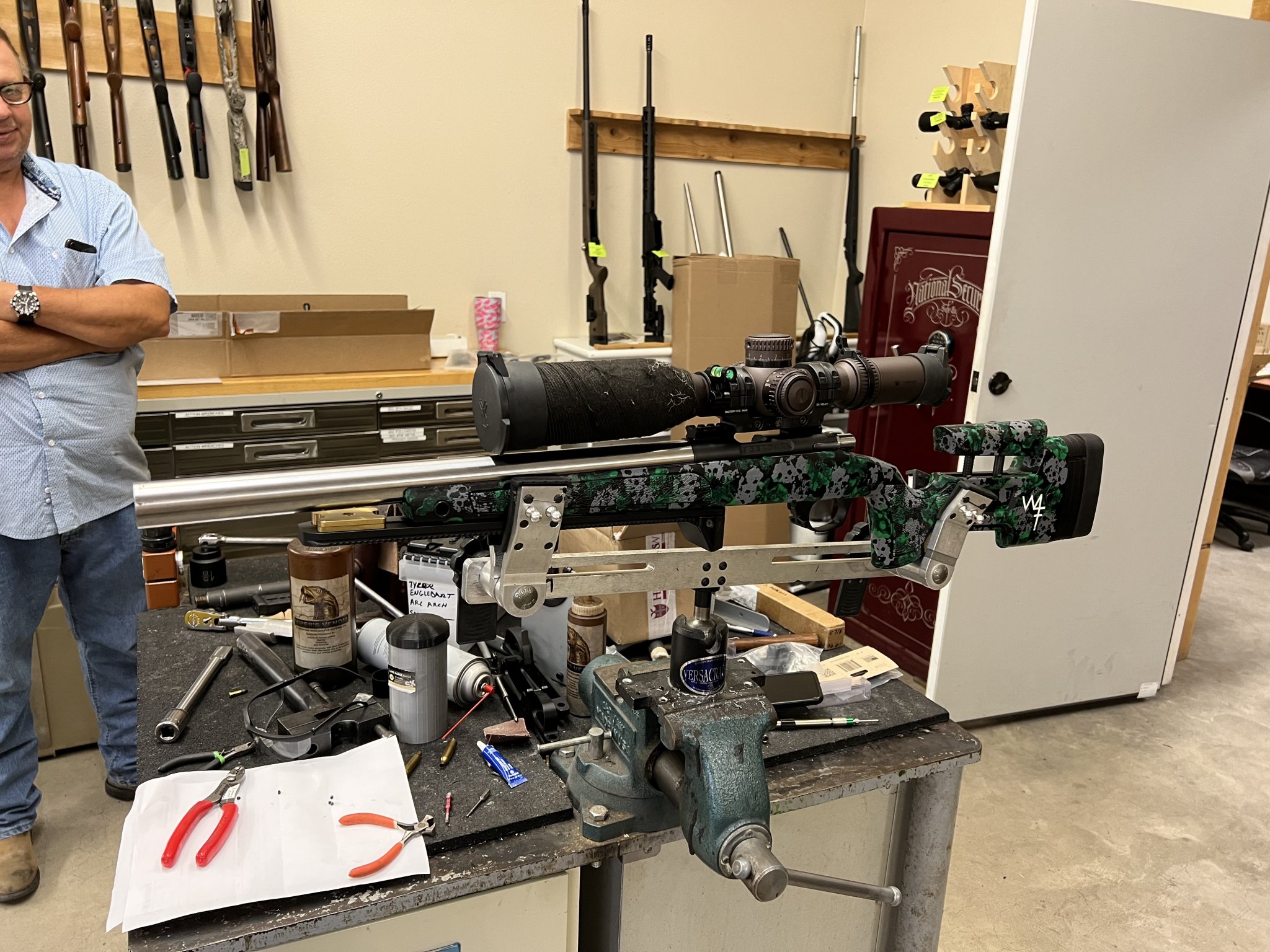

It’s too late for me Gents! I now have a 1.25” straight taper Krieger barrel blank and a set of match reamers/pilots/bushings/gauges that will be headed to my gunsmith soon. I’m thinking 22” finished length and going to run it in my ACC chassis to mimic my centerfire rifle setup. Call me crazy if you want. It should be an interesting project!
Do yourself a favor and look really hard at the length of barrel if you are running a tuner. I had to install my ATS tuner backwards on my 22" barrel to get it to fit in the ACC chassis.
Thanks a lot for your reply. It’s a 25” blank, so we could cut an inch off each side to be safe and land in 23” zone. Im a little worried about how the action will hold up to the weight of the straight taper barrel…..I guess there’s only one way to find out!
From what i understand there isnt much of a difference between the b14 and b14r actions. Id be really surprised if you had an issue.
Reactions: TNSleeper99
Hello W4,
Looks nice !! Did you have to enlarge the stock barrel channel ?? I would like a 1.25" straight but don't want to buy a chassis at this point.
