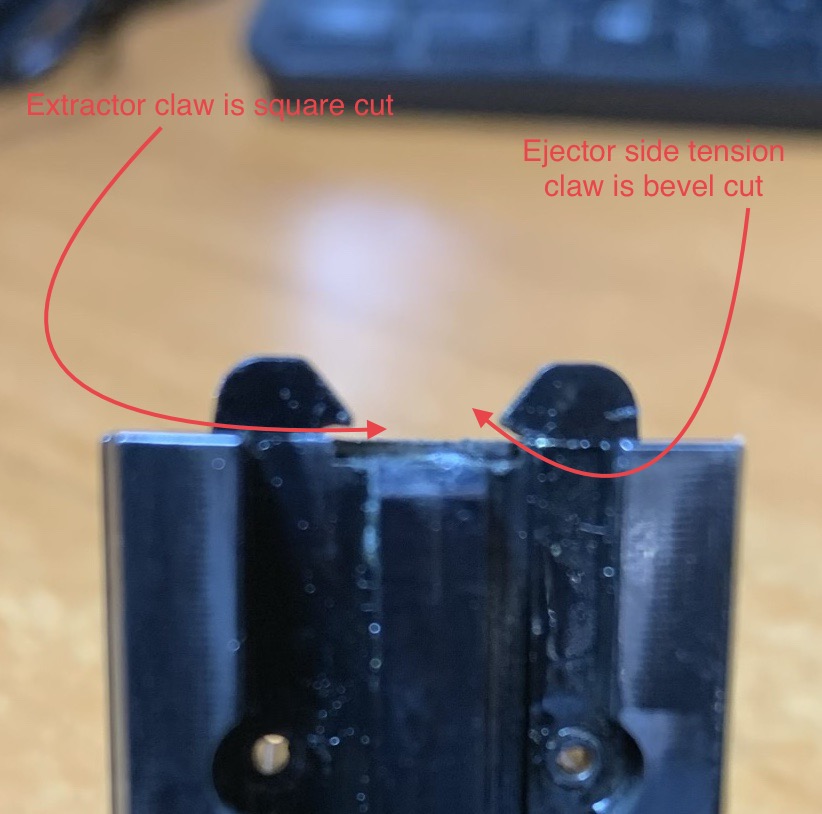

I found the weak spring tension of the ejector side extractor to be the main culprit. The extractors have no issue pulling the case out of the chamber, but the case is to easily popped out from the weak side extractor claw before it reaches the ejector. The first thing the spent case catches on is the mag feed lips, then the rim of the round below. Either of those can and does knock the case loose before reaching the ejector thus leaving a spent case in there to jam as you try chambering the next round.
Watch closely in this video. The first round is ejected by the mag feed lips, it's not even close to hitting the ejector. The second round you can see hang on the feed lips, then hang on the rim of the shell below, and finally gets pushed out by the ejector.
The factory spring too weak on the tension claw. They really should just have the same damn spring in both sides & I suspect that is the real fix when one of these gets sent back.
Honestly I don't think I can explain it any better & not going to rehash the fixes I did. Check the other thread linked by someone above.
I'm now at 2800 trouble free rounds on mine since the fix.
