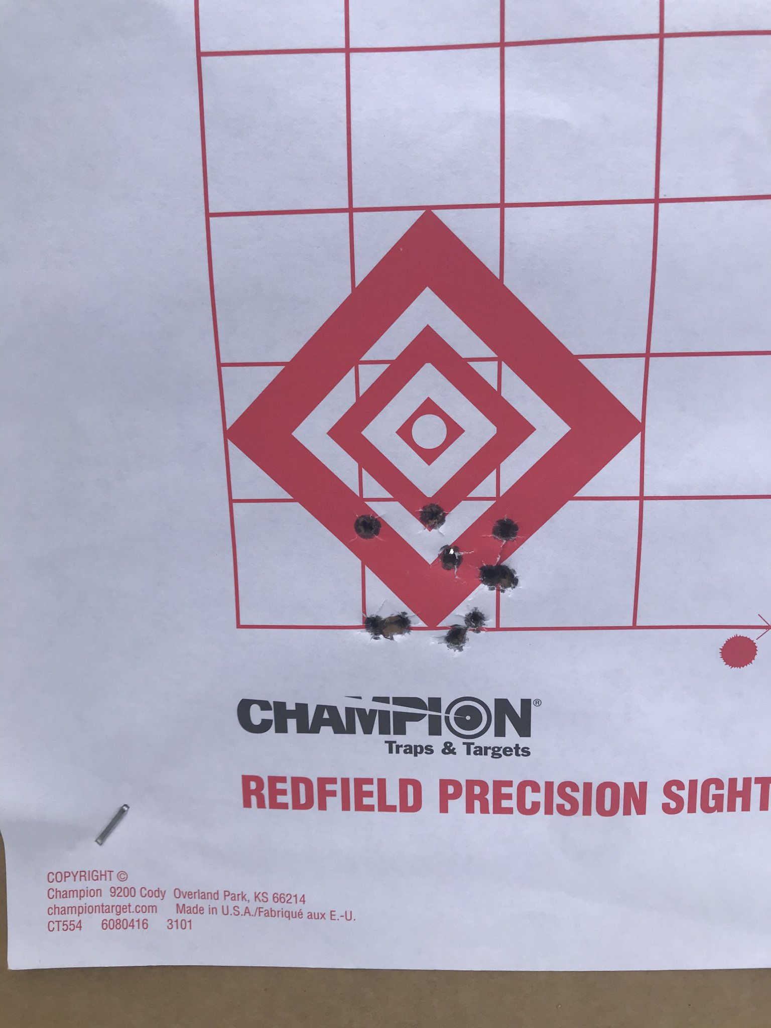

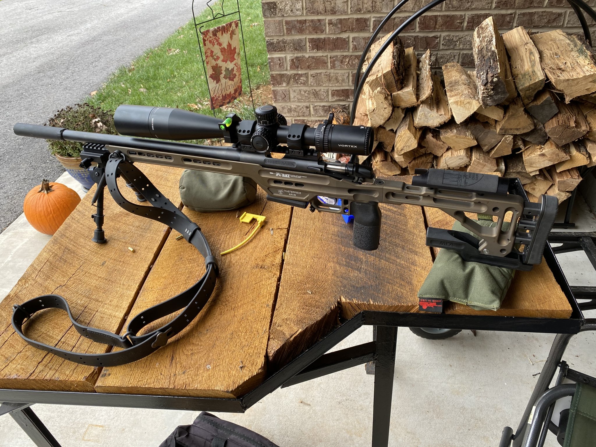

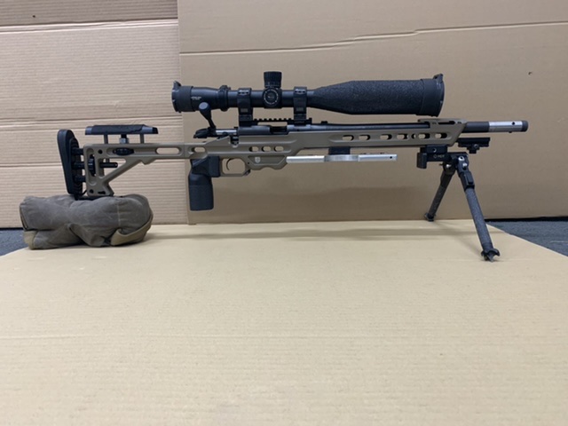

This is my first post to Snipershide. So please be gentle! I haven't been posting that much recently to gun forums, but this B14R has me really excited.
I recently picked up a BA (steel) Begara B14R, installed it in an MPA Hybrid chassis, and topped it with Burris XTR Signature rings and a Vortex Viper PST Gen II.
It has a Sparrow suppressor. the trigger is the stock trigger. I just ordered a Timney Hit for it. The stock trigger is heavy somewhere north of 2 pounds. I haven't measured it because of the damn firing pin reports about the Bergara, but I know it's heavy. Speaking of heavy, this entire package currently weighs 15 pounds. I bought the hybrid chassis because it is one of the lightest, and am I glad I did! The rifle is butt heavy because of the shorter barrel length. I can add weight to the fore end of the hybrid, but I don't want to.
I purchased a couple extra mags. I have three. Out of the three, two seem to function flawlessly. The other one will not feed. I have the dreaded droop in the front of the mag. This has been reported on other threads regarding the MPA chassis and the B14R. I don't know how to address this issue long term.

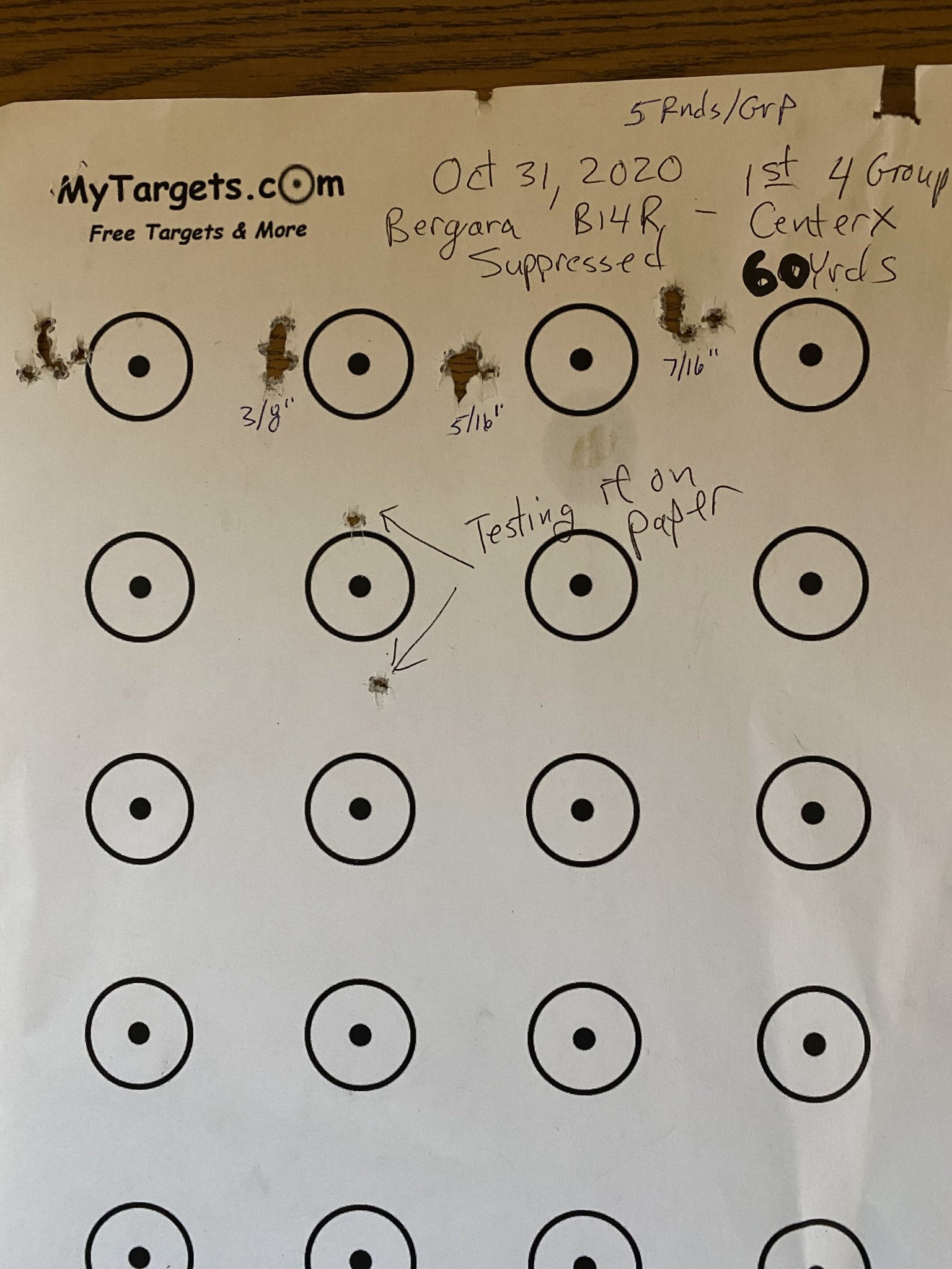

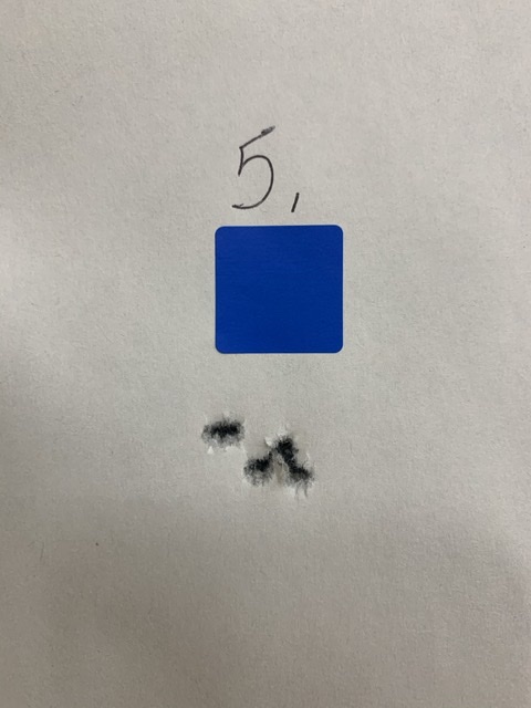

I cleaned the barrel out of the box to make sure there wasn't any debris remaining. Then I started shooting center-x. Right out of the gate, the thing shot lights out! These are the very first 20 rounds out of the barrel after shooting two test shots to get on paper and roughly zeroed. Note these groups are at 60 yards. The first group actually had 6 or 7 rounds. Once I realized how well it was shooting, I started shooting 5 shot groups. All well within 1 moa.

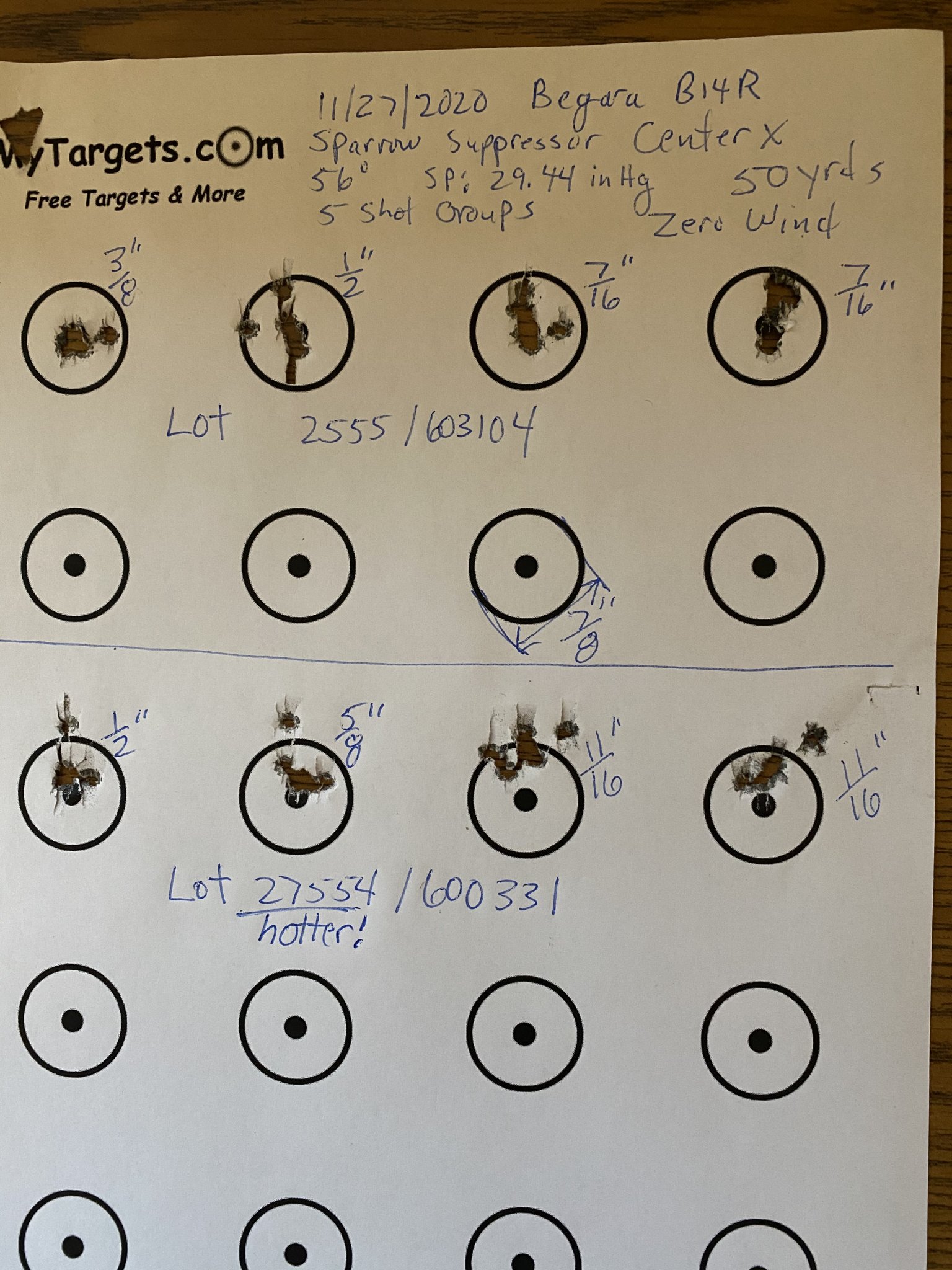

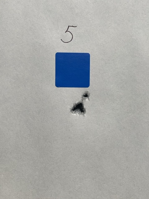

Today is a nice quiet day for wind, so I thought I would shoot some more groups:
I had some odd lots of center-x sitting around. So I tried two of them. Immediately upon switching to the second lot, it was shooting high and I actually heard the crack. After inspecting the lot closer, I see it was cronoed higher. I can see the B14R does not like that second lot as well as the first.
Good looking rifle Big- and she shoots also! How do you like that scope?
The scope is great depending upon what you are doing. I have an egw 30moa rail and 0/0 moa offset in the burris rings. With that config, I get 26 mrad up. That’s actually very good considering the scope is rated for 20mrad vertical. Most posts I’ve read say the scope provides almost 30mrads. closest I can get is 26. 26 is not enough for some of the shoots I do. We will shoot north of 500 yards which requires 30 mrads. So I adjust for 25 and hold over 5 or six mrads.
the sub-tensions are also pretty course, .5mRad. this hasn’t been as much of a big deal since with the target sizes we shoot, you can approximate pretty well.
I have a vortex razor gen one on my centerfire prs rifle. That’s an awesome scope that eliminates all of the shortcomings of the pst. Depends upon what you are wanting to do with your rifle and how much you want to spend.
bottom line, however, I love the scope, and it works very well for what I paid, plus lifetime warranty!

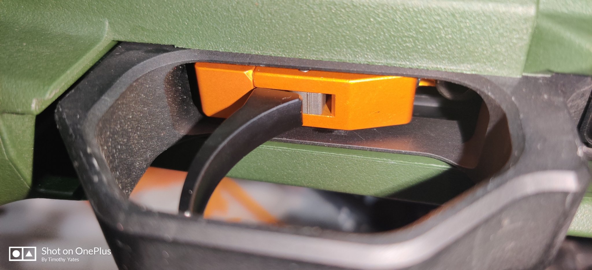

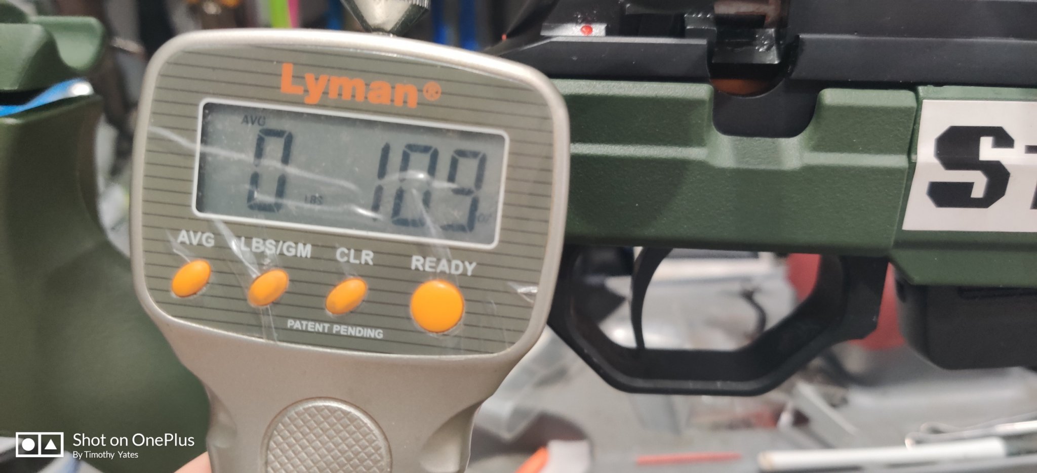

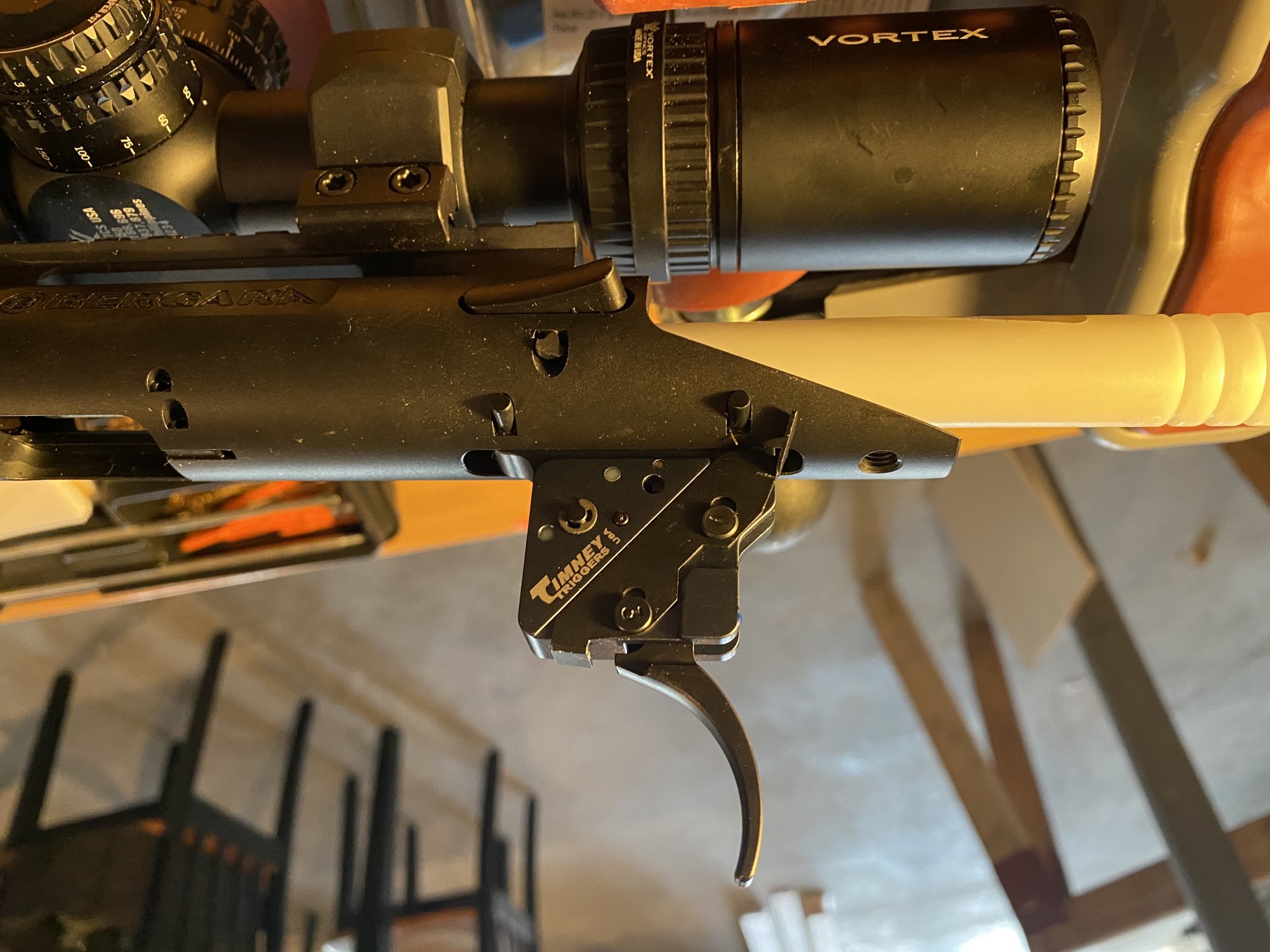

I installed the Timney Hit trigger today. I did not touch any adjustment before dropping it right in. Super easy to install. Out of the box, it is pulling at 12 oz. I did not adjust since this is a tactical competition rifle. I also figured I'd shoot it a couple hundred times and see where it ends up. It does have some creep, but releases crisply. The creep is smooth, almost like a two stage. The more I shot it, the less I noticed it. We will see where it ends up.

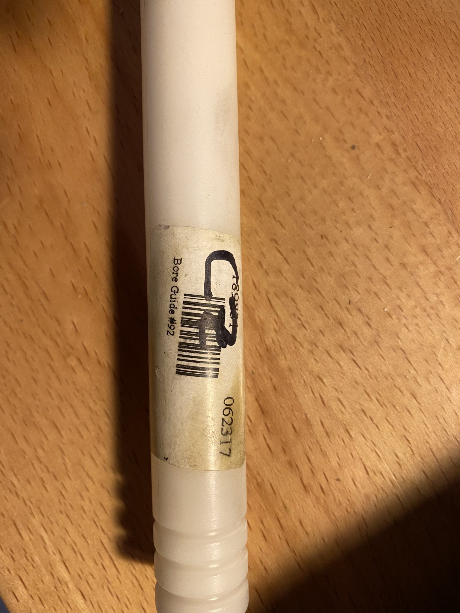

Oh, some interesting news, perhaps deserving a pin somewhere or a thread of its own.... My CZ455 bore guide works very well in the b14R.

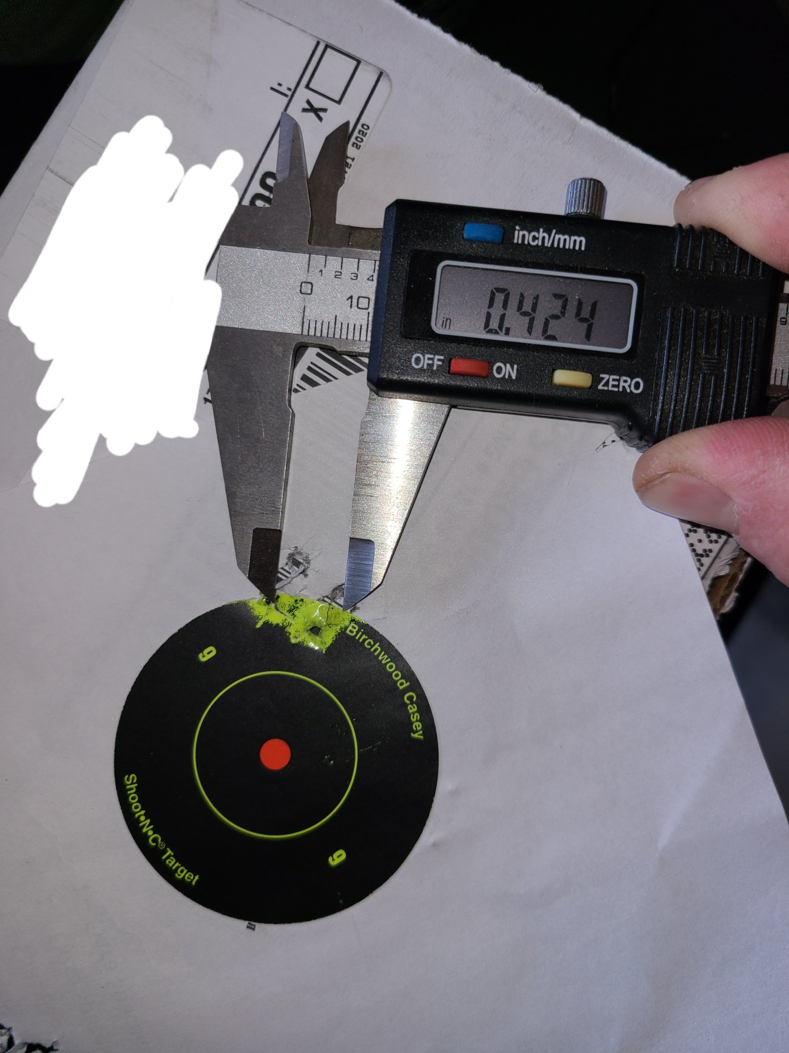

@Bigdaddycsi thanks for starting up this thread. Good information for those looking at the bergara, so I figured I'd share my experiences as well. I got the CF barreled action and dropped it into a mcmillan A4 stock with hawkins bottom metal. My first trip to the range was plagued by feeding issues, particularly the magazine sitting too low in the bottom metal causing the round to jam into the 6 o'clock of the chamber. I did note that the mcmilan stock I used came with pillars already installed and the textured paint on the stock was done throughout, including the action inlet and the bottom metal inlet. The coating actually covered the pillars, which I think caused some tolerance issues with the seating depth of the mag. I remove the paint from the inletted surface and now I'm getting reliable feeding, but still some slight front dip which causes some minor bullet deformation if I don't catch it. I will say the rifle is accurate though, ammo dependent. I fired about 80 rds of gemtech subs through it, which averaged about 2" groups at 100yds. Norma match was slightly better at around 1.5" at 100. The SK red box was the winner though. I fired groups at 50 and 100yds. I didn't measure the groups at 50, but all shots were touching. It didn't shoot outside of 1" at 100 yds, with the best 5 rd group measuring .42". I think if I can knock out the minute forward tilt of the mag it'll be a really good shooter.
*edited to redact information that was on the postal packaging in the background 🤦

They are definitely shooters.
MPA BA comp
Athlon Ares ETR
20moa Leupold base
40moa Burris Signature XTR rings

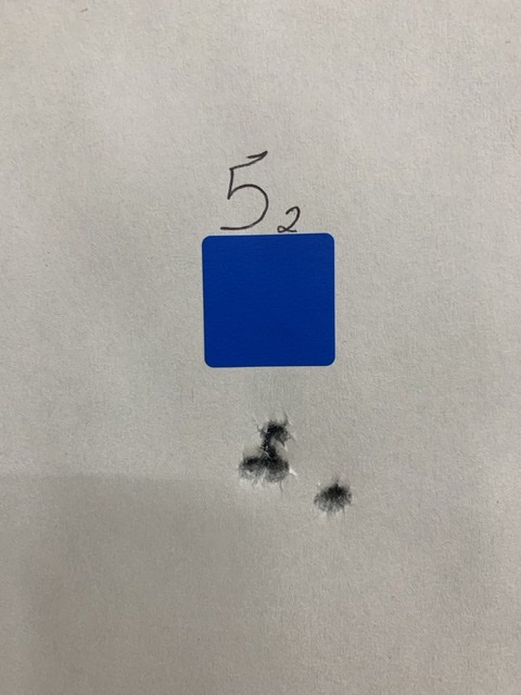

A few 5 shot groups at 50y, testing my tuner. Fine tuning would be a better term than testing, I guess.
Would have been great groups if not for the occasional flier....that's a problem with me too. What ammo were you using?
Also, thoughts on that scope, seriously considering that one next.
Yeah. I'm not the guy who claims it a true "flyer." I am confident those were 100% me.
Wolf Match Target Extra
I like the scope a lot. I have used it for a couple years, now. I had it on, of course, other rifles. I am an Athlon dealer, so I have several models on various personal rifles and shop loaner rifles. I like the short parallax and the amount of available elevation. Athlon claims 31Mils, however, mine has 34mils. With 60moa of, combined, rings and base, I have a true 31Mils of UP. While I have only shot out to 440y with this rifle (24.1Mils), StrelokPro claims 34Mils will get me to about 640-ish.

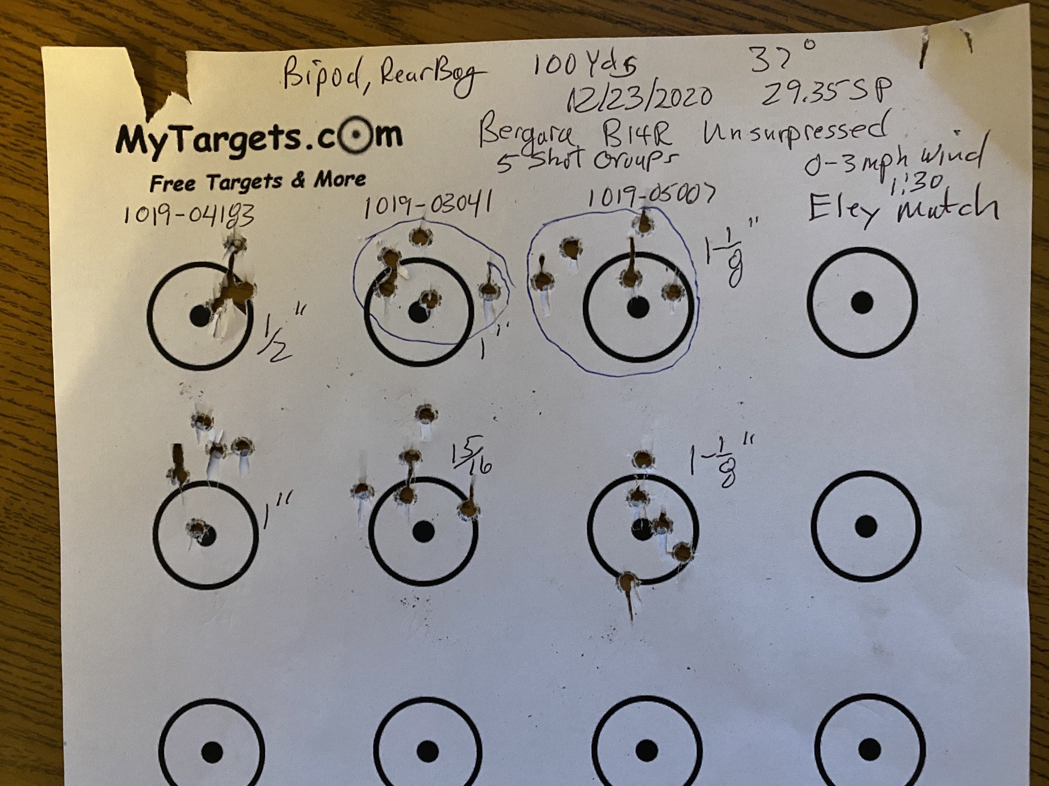

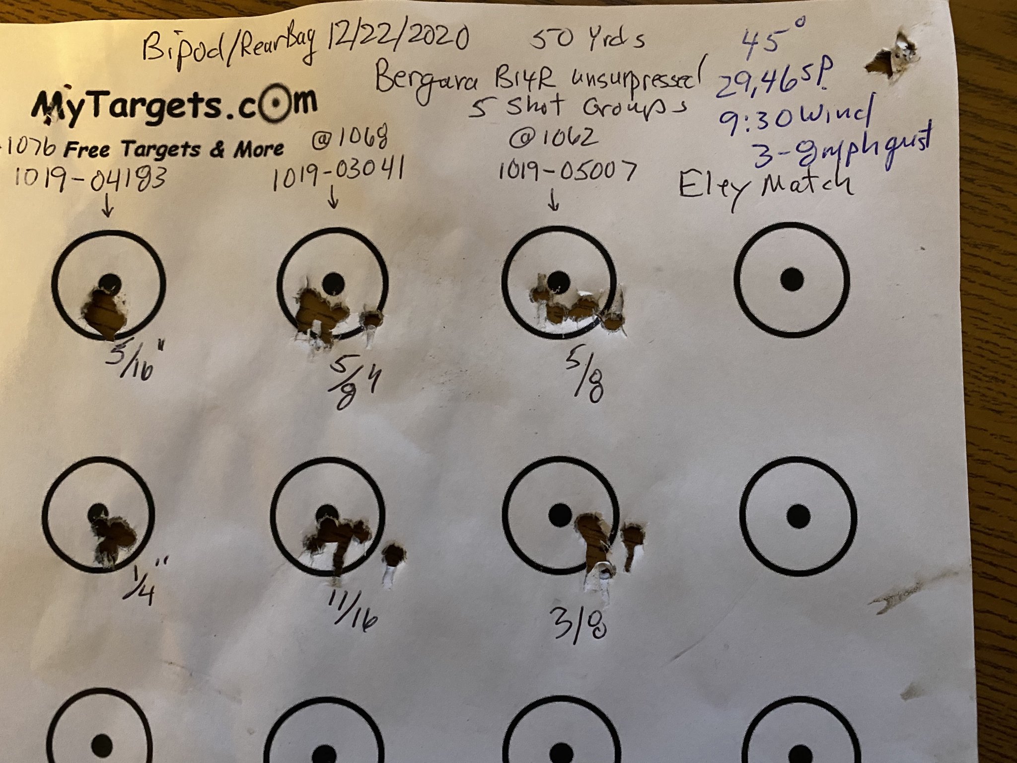

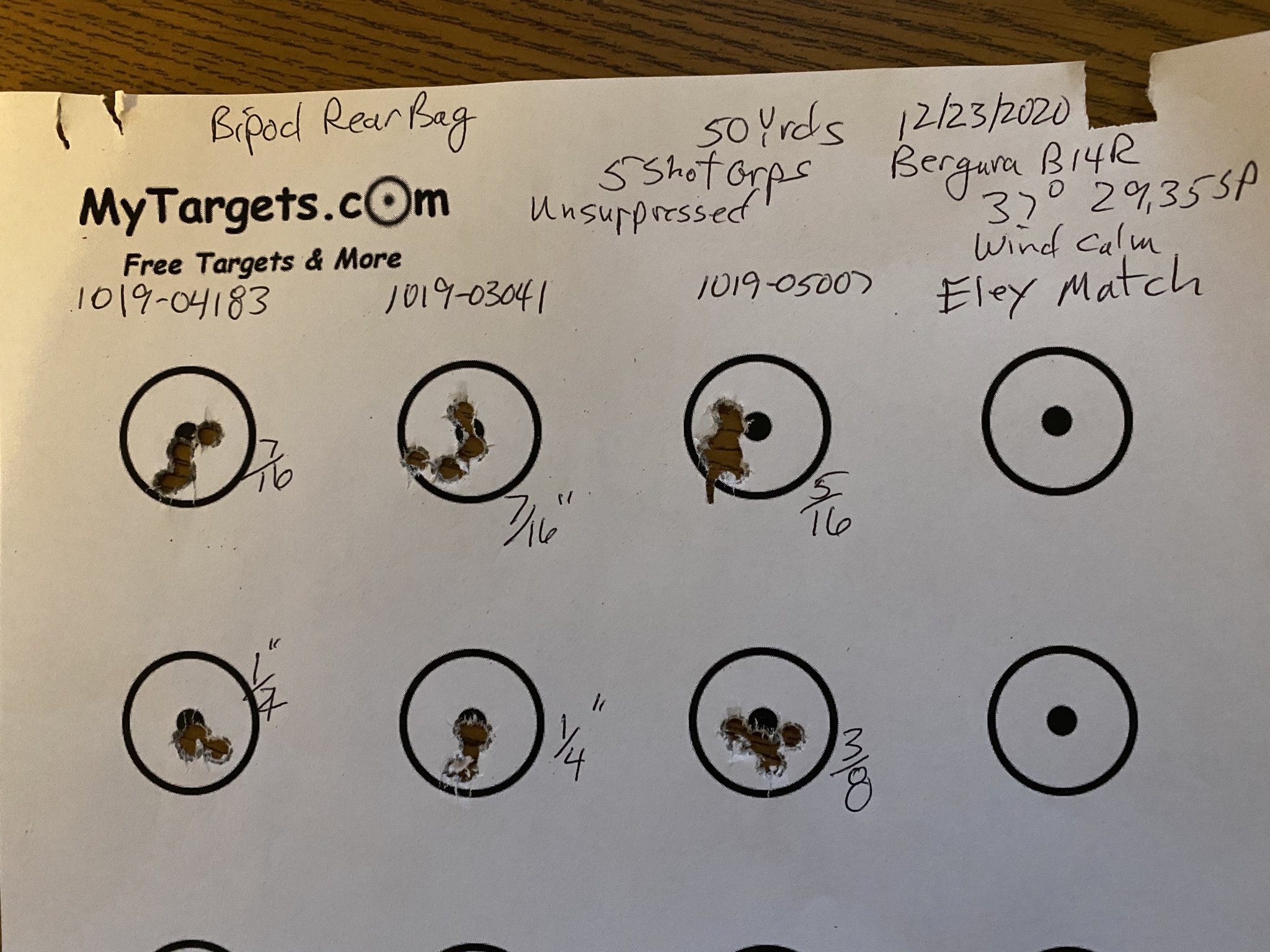

Re: More Groups

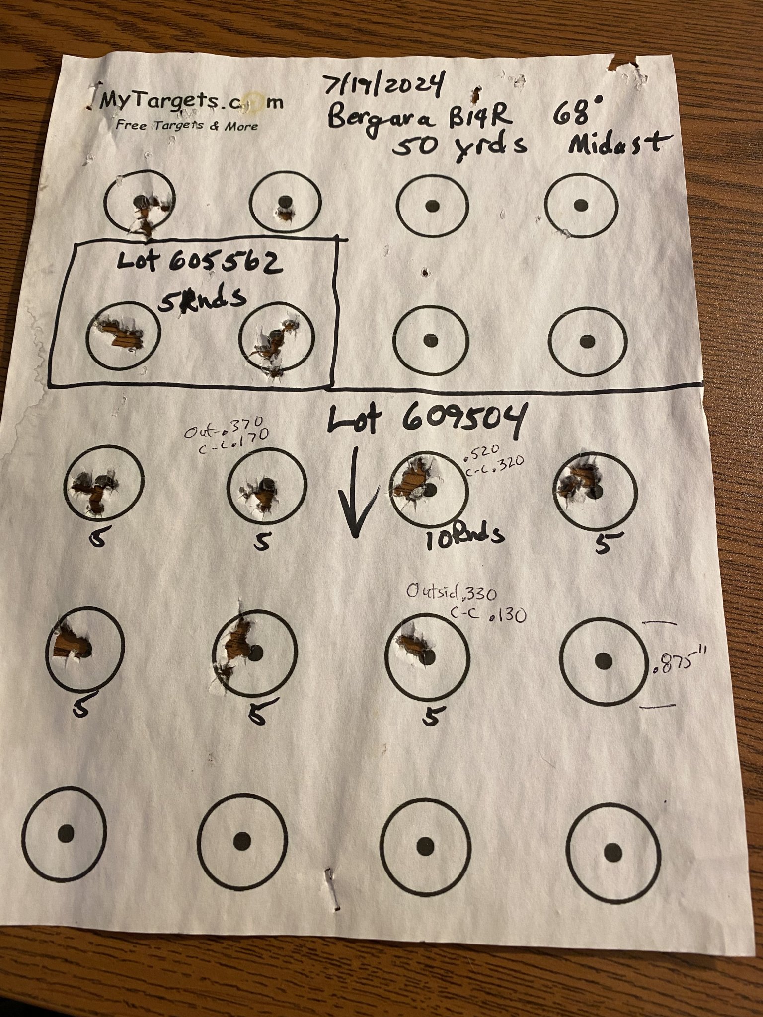

I have to say, this is one excellent shooting rifle. I shot some groups with Eley Match at 50 and 100 yards. Yesterday I shot 50 yrds. Today I shot 50 and 100. I cleaned the barrel prior to shooting the Eley, and only shot 9 rounds prior to starting the grouping tests. Others have reported needing 50 rounds thru a rifle when switching to Eley, but I'm not seeing that trend in the groups below.
This was off the bench with bipod and rear bag. My first groups posted in this thread had some vertical stringing. Evidently, that was from the bipod on a hard wooden surface. I've starting using a towel folded over once, and that problem has disappeared.
Twice today, I had 4 rounds into the same hole at 50, and then one slightly off making 1/4" groups. That very well could have been me. I had trouble keeping my heart beats under 1/4". Unfortunately by the time I got to 100 yards, the wind was picking up. Best group was 1/2" at 100 and two at 1". Typical 22rf behavior. I would have shot more groups, but I feared the wind was starting to skew (pun intended) my results.
Oh, I've been shooting unsuppressed for now. I wanted to benchmark some different ammo unsuppressed before trying the can again.
