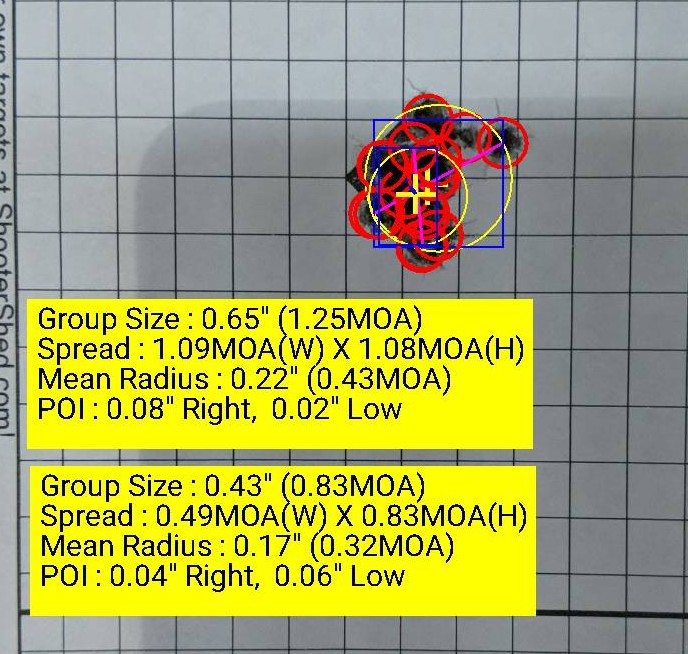

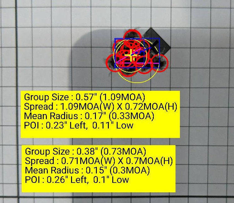

It was about 37°F this morning with no wind (rare for Oklahoma). I sighted the rifle in at 50 yards with Eley SA Benchrest Outlaw. It took me 5 shots to get zeroed because I'm a bonehead that can't remember right from left. Once I found zero I shot five more and proceeded to begin testing the various flavors of ammo I had on hand. I shot 10 round groups at 50 yards until the wind picked up. I'm not going to put up all 12 groups, but I'll put up three of the better ones. With each of these I've grouped all 10 shots and then made another group that throws out 1 shot, so the lower group label that shows a tighter measurement is the 9-shot group. (Grid is 1/4" and center diamond is 1/2")
SK Flatnose Target
Eley Club
I'm absolutely pleased with the accuracy from this rifle. Even supersonic varieties shoot remarkably well (for supersonic varieties) and very few varieties actually shot poorly. There were several more groups that showed 7 or 8 shots in a tight group and then a couple of outliers that were probably more the fault of the shooter than the rifle. All 3 mags functioned flawlessly and there were no failures of any kind in the 130 rounds I put down range.

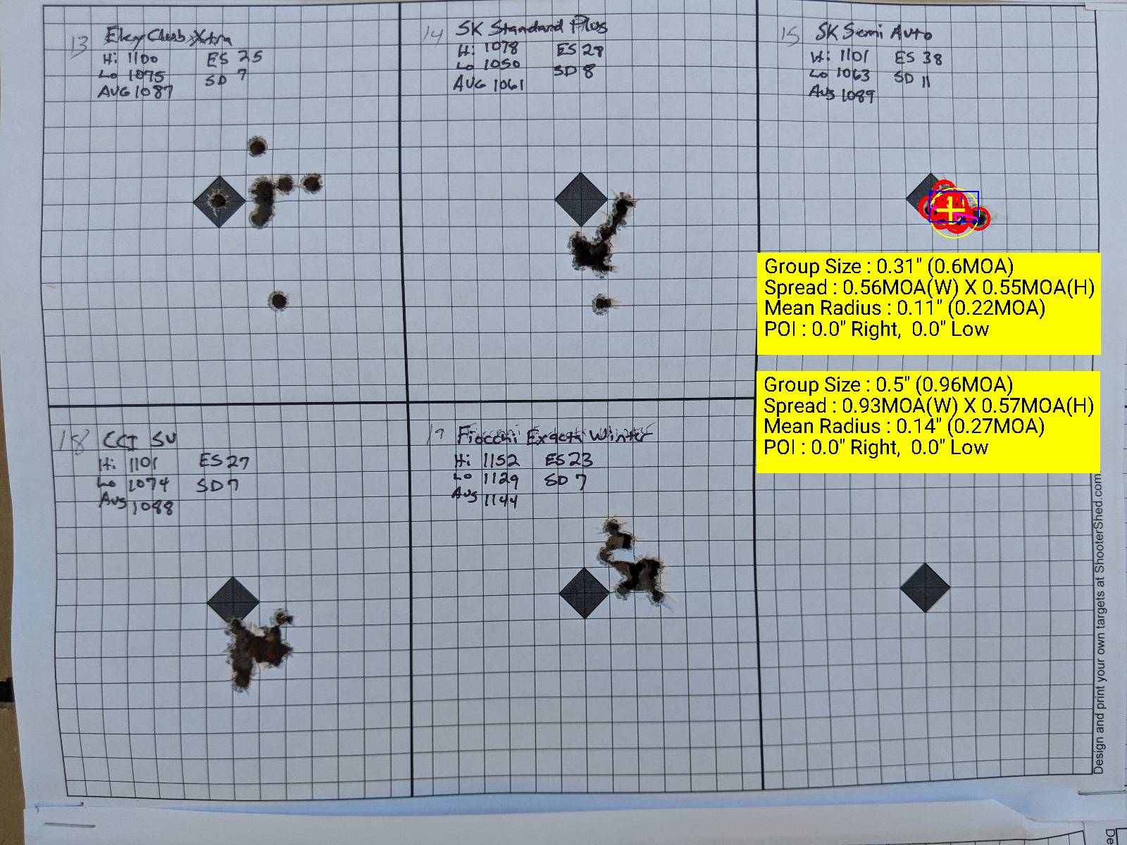

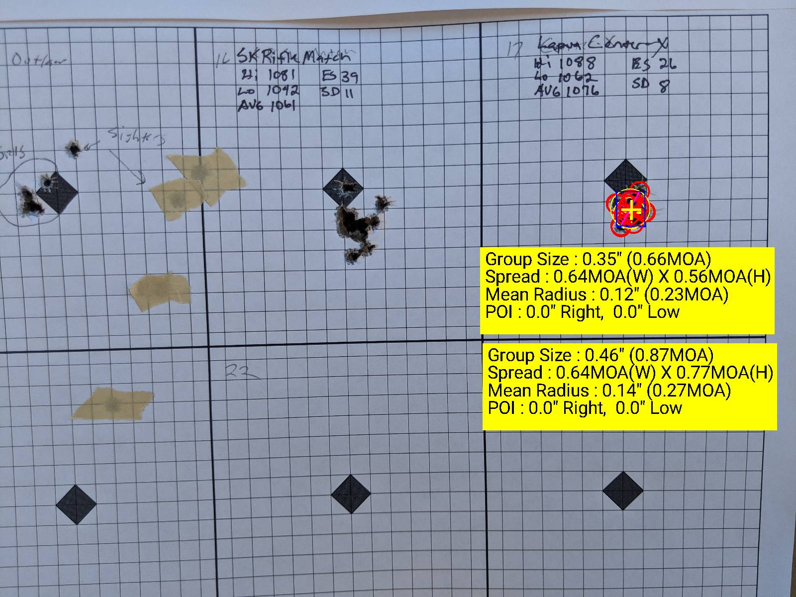

Back out again today with some other ammo to try. I also found a deal on a couple of Triggertech Special triggers that replaced the stock triggers in this B14R and in my B14 HMR. Groups of note are shone with the best 9/10 and the full 10 shots (grid is 1/4", diamond is 1/2") at 50 yards.
First up, the old standby, Lapua Center-X
Next up, the new kid, SK Semi Auto
I'm really pleased with the SK Semi Auto. I bought the last case that GoodShootingInc.com had, hoping for good results. I had a hunch based on the results from Eley Semi-Auto Outlaw that this SK variety would be decent. I only have a little over 100 rounds of Center-X left, with results like this I think I'll be okay for a while.
