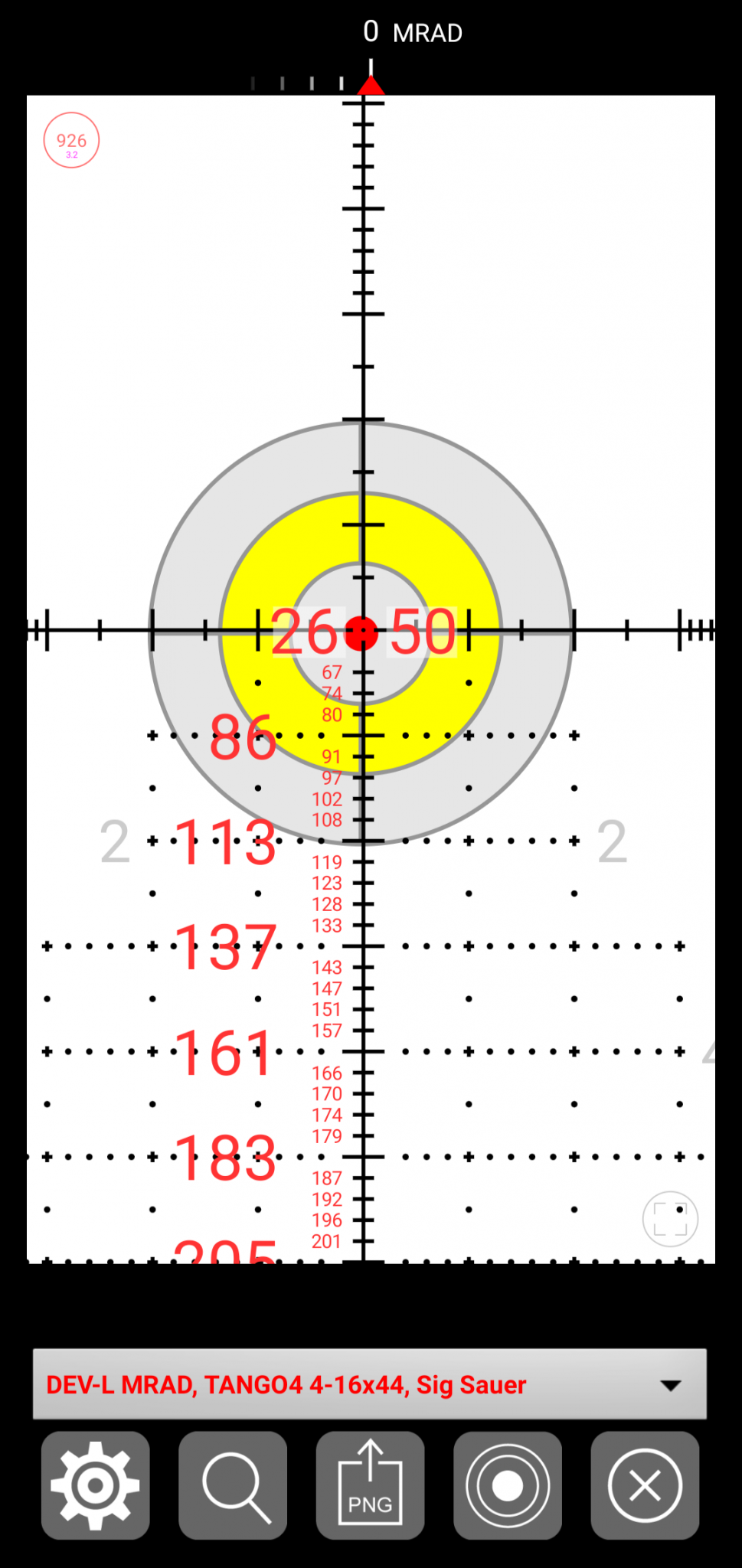

Follow up question for everyone. Assuming most people use a 50 yard zero, do you set your zero stop for POA/POI at 50 and leave .5 MIL where you can dial down for POA/POI when you want to shoot at 25 yards? I keep going back and forth between the 5X25 Arken EP5 and the Vortex Strike Eagle. I use the 5X25 PST Gen II on my 6.5CM so I’m not sure if I need to stick with Vortex to keep reticle uniformity. Also, with standard rings, will it be better to use 20 or 30 MOA base. I guess I would like to dial from 25-325 yards as that’s the max I can see me shooting this at which will be rare at Steel targets. I have access to 1000 plus yards at steel on a different range but I won’t ever use the rimfire for that. Thanks everyone
Only one way to really find out...shoot it.
Also, with standard rings, will it be better to use 20 or 30 MOA base. I guess I would like to dial from 25-325 yards as that’s the max I can see me shooting this at which will be rare at Steel targets. Thanks everyone
I have never heard of anyone regretting 30MOA bases. And if you really want to play with MOA, get Burris XTR rings and you can add or subtract from 0-40MOA in 5MOA increments.
If you have range flexibility that allows you to zero at 35 yards do so. Everything is an up adjustment from there. 30 MOA base is a better choice than 20 for the near NRL22X distances you mention.
No need to dial under except at about 32-34 it's a tenth or two.

I zeroed at 50 and put on the stop - I can still dial down .4 mil for 25 yards - or just hold. But I”m shooting silhouettes at ranges from 80 to 200 yards so no need to go lower for now.

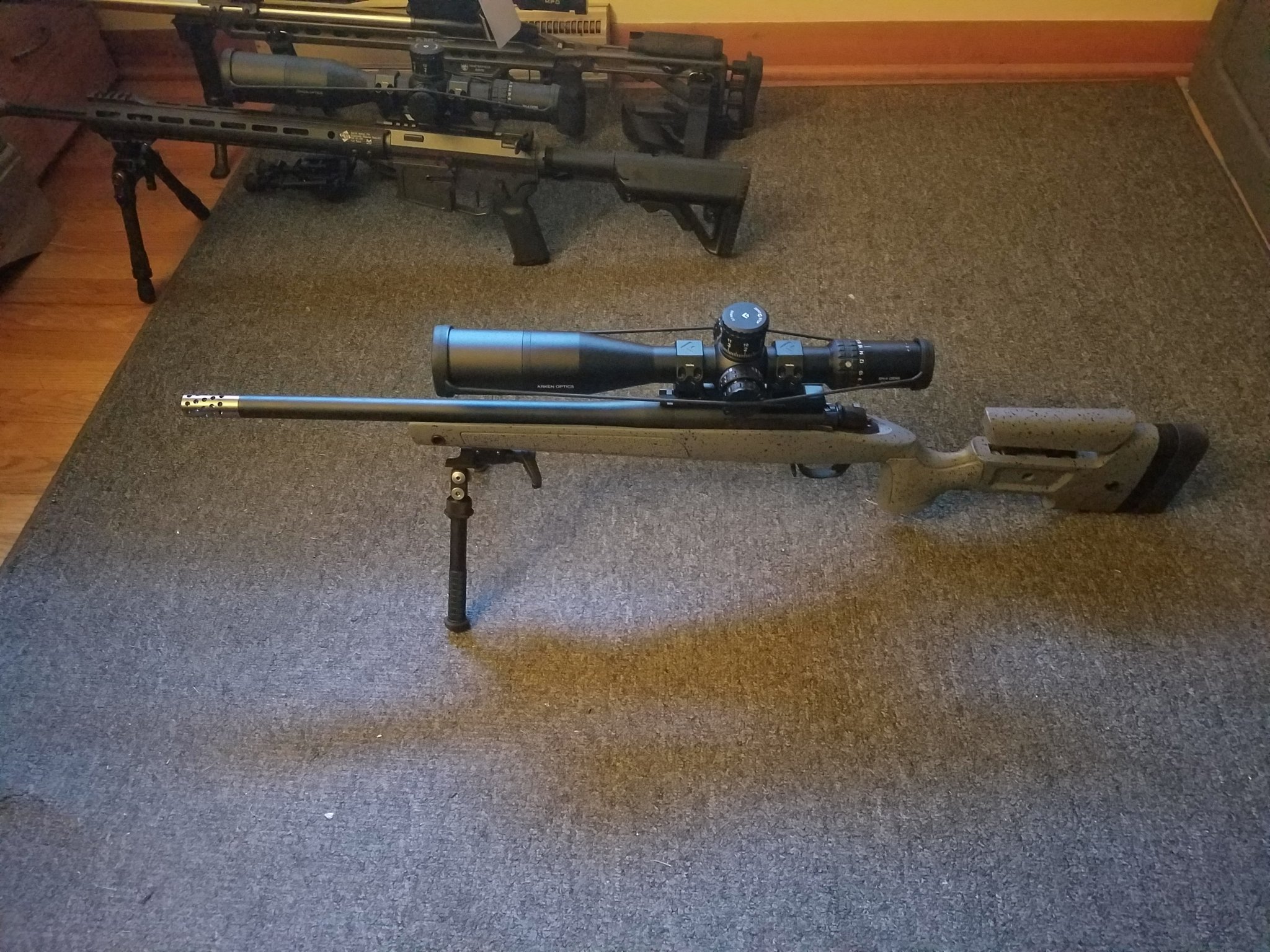

Reactions: Ghost231
Well, I got it all put together, here’s my initial thoughts on it so far.
I went with the factory setup instead of putting it in a KRG Bravo. Having my custom 700 in a KRG and this side by side, I feel I made the right choice. The KRG has a wider forend, but that can be fixed by adding an ARCA rail later of I choose. I went with a Timney HIT trigger, it’s set at 8oz and no matter how hard I run that bolt the sear didn’t slip. Feels nice and crisp, didn’t feel any creep. I won’t get real trigger time till my next days off though. I went with the Arken EP5, so far I like the glass for the price, but again, I won’t be able to hit the range till next week to see how it does.
Only two issues so far that I have found, the bolt is a bit stiffer then I expected when closing the bolt. It also arrived with a small gouge in the magwell with a burr. Maybe Bergara will replace the bottom metal, but will see. Can’t find any in stock extra mags which is a little annoying, but it seems everyone is waiting on them.
So, overall I am very happy with this build so far, hope it prints well on paper, but I’m sure either way I will like this as a shooter. Thanks to all of you who helped with making some of the choices I made.
