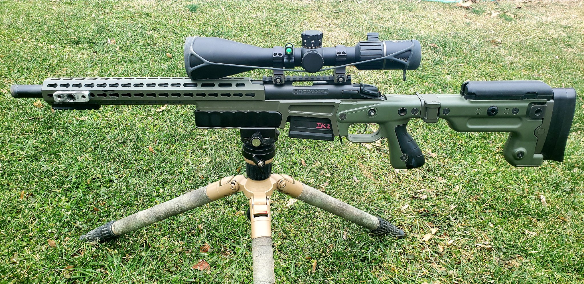

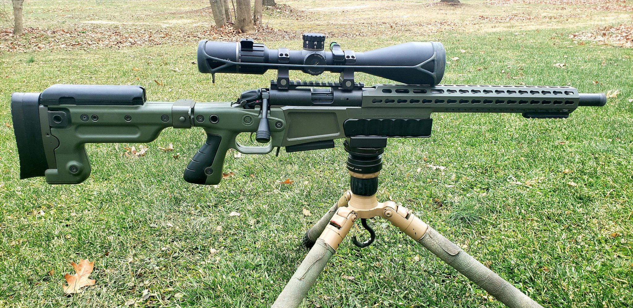

I took the rifle out today to get zeroed and there wasn't really any drama, all the rounds fed smoothly and accuracy was good. I had one bad group because I was having trouble feeling my fingers but the 30 round average was .475" with SK Long Range. The last shot center punched the pastie target so I figured it was good enough. The place was surprisingly busy so I didn't get a chance to shoot at 200 and 300 so I binned it for the day.
