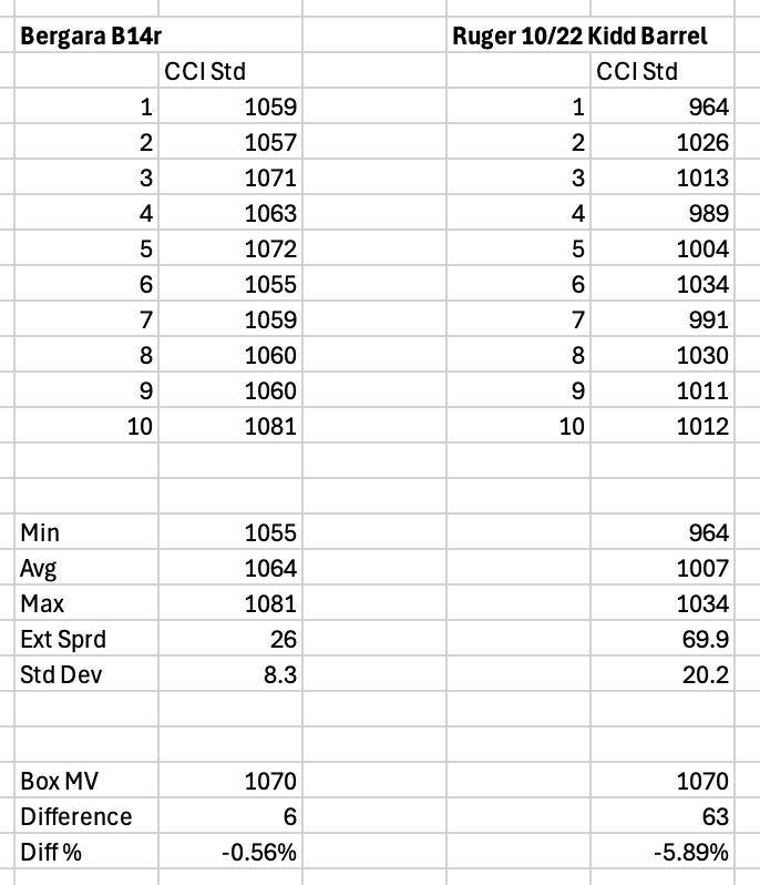

Hello All - I borrowed a Garmin Chronograph (amazing technology btw) and shot 10 rounds through both the Bergara B14r and Ruger 10/22. It was on my lunch hour and 32 degrees, or I would have shot more.
I am pleasantly surprised at how well the Bergara handles the CCI Std load. Box says 1070 fps. I found in the 10 shots this data: Min 1055, Max 1081, Avg 1064. Ext Sprd of 26 and SD of 8.3. Really happy with that.
Ruger 10/22 performed as expected, meaning worse: Min 964, Max 1034, Avg 1007, Ext Sprd 69.9 and SD of 20.2.

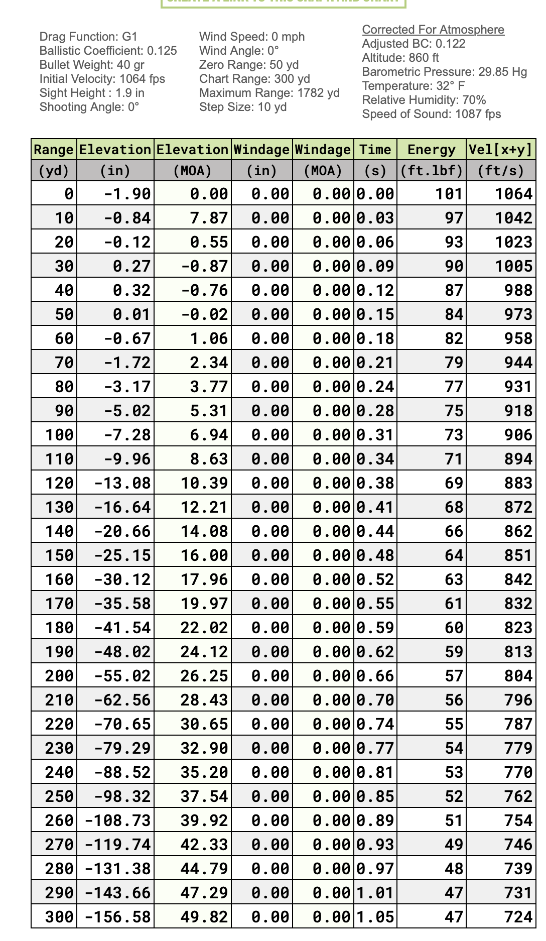

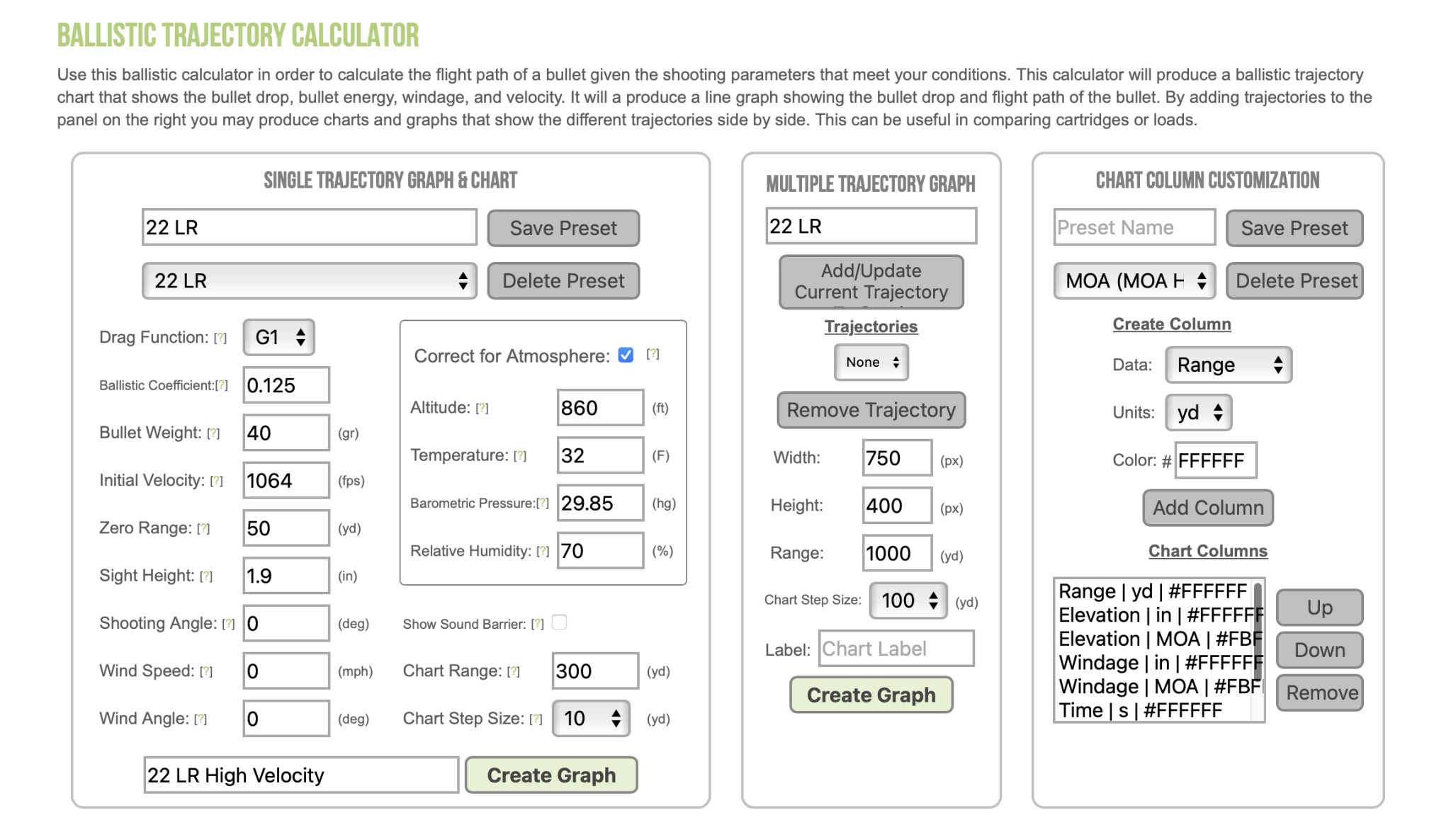

Knowing this information, I have used 2 different ballistic calculators. One online version called Shooterscalculator.com and the other is an app on my iPhone called Chairgun Elite +. I have measured my scope center to be 1.9 inches above bore center, and double checked all of the other variables. Shooterscalculator.com estimates 6.94 MOA for 100 yard shot, and Chairgun Elite + estimates 7.1. So both calculators are within .2 MOA of each other.
My real world experience was that I only needed 6 MOA, not 7. If I use my now known MV of 1063, I need to adjust the BC from .125 to .350 to get the correct 6 MOA.
Someone asked how I got to 7 MOA. I will attach a couple of screenshots from the online calculator.
Any further thoughts or do I just say the Bergara needs BC of .35 and call it good?

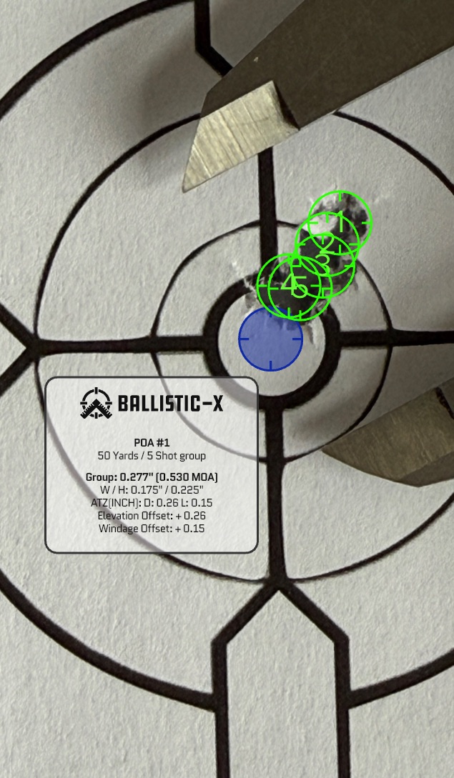

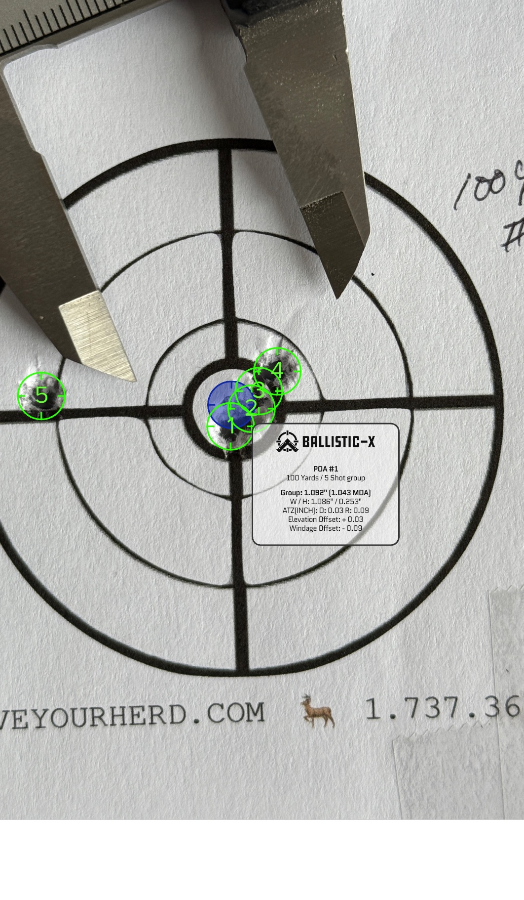

Also, just so I can be a 100% nerd.... Here is example of a good group at 50 yards and a group at 100 yards after I found the correct 6 MOA. On the 100 yard, I believe the one shot to the left was my bad... but very pleased with the other 4.

That 50 yard target would indicate your zero is off. 0.26" @ 50y = ~0.5 moa at 100y, which would be half your error alone.
Are you 100% sure the target is 100 yards from your shooting position, and that your zero board is 50 yards?
Correct your zero first, but also verify ranges are spot on.

Either way, it is what it is. 6 - 6.5 moa is the solution for your setup.
There's no way the b.c. is in the .3xx's......its gonna be in the .105 to .185 range likely. Your ammo doesn't have 3 times better b.c. than the average. Just sayin'....

With a 50-yard zero and goal of truing your calculator at 100 yards, adjust your velocity. With a BC of .35, you will get elevation solutions far too low at longer ranges. And yes, you should have an accurate velocity from the Garmin - but the bullet speaks. You have to adjust ("true") your calculator to what the bullet is actually doing.

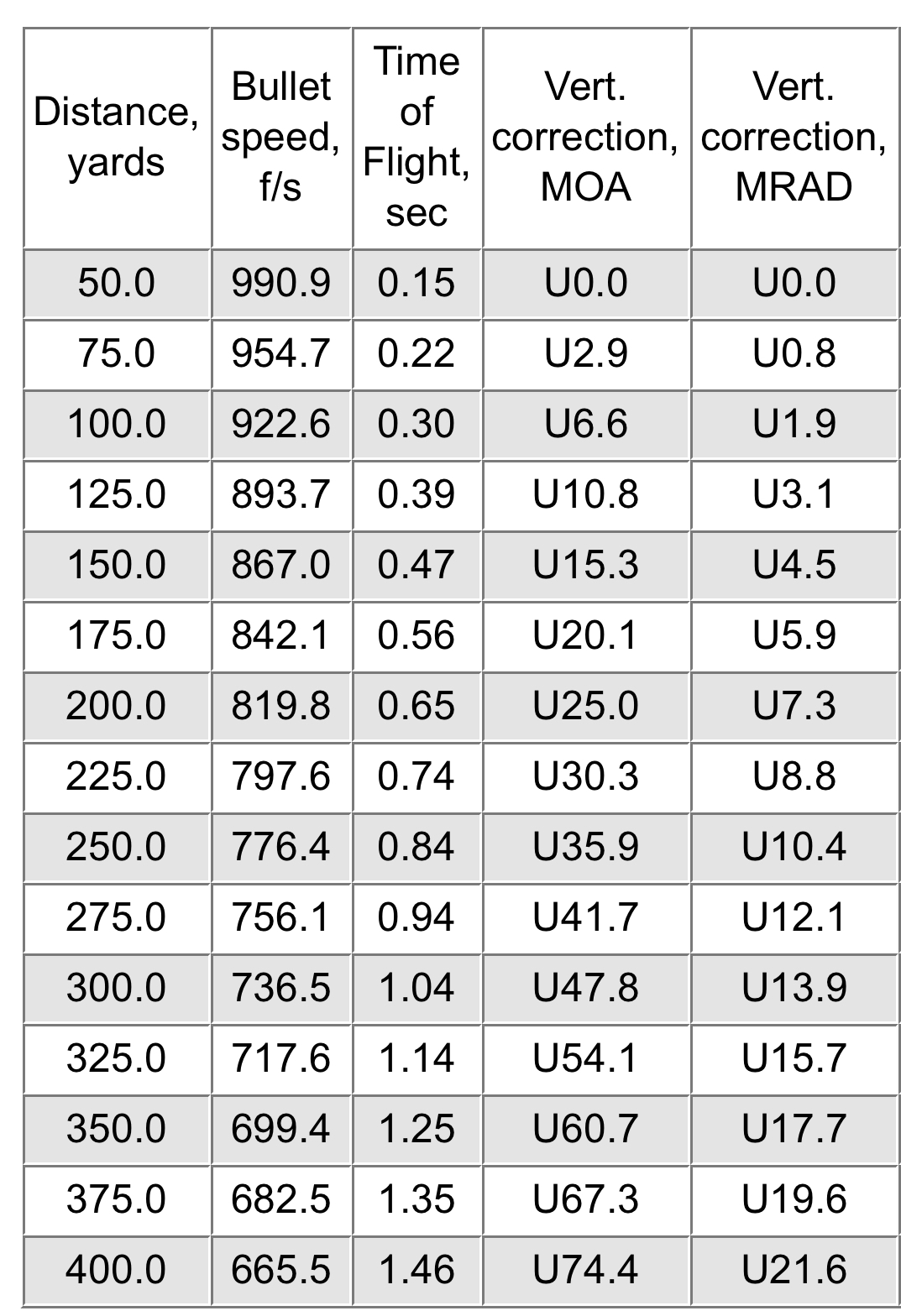

Attached is the drop table for CCI SV in my Vudoo. Velocity is trued to 1086, BC .123 ( BC set per CCI SV data from Strelok Pro). Note the 300-yard elevation is 47.8 MOA. If I change BC to .35, calculator returns 38.8 MOA elevation.
True your calculator by changing velocity out to 200 yards, using .123 BC. As 1911shootist said, you MUST be sure your distances are correct.
