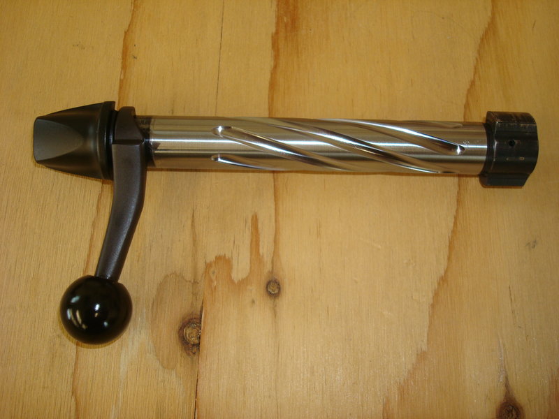

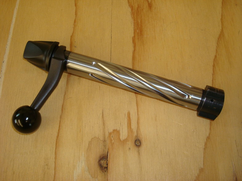

A new offering for bolt fluting. The Bergara rifles are fairly new the the states I believe. I finally got one in my hands to flute. No problem, except they use a metric M12X1.0 thread for the firing pin assy. This thread is like trying to find a unicorn in the forest. So, I had to thread mill a stud to hold onto. Lots of fun. These are a very nice little bolt and machine beautifully. Bolt body is very tough which leads to a very nice finish. All styles of fluting that I do are available for this bolt.[IMG2=JSON]{"data-align":"none","data-size":"full","src":"http:\/\/forum.accurateshooter.com\/styles\/default\/xenforo\/clear.png"}[/IMG2]
Thanks for checking it out. [IMG2=JSON]{"data-align":"none","data-size":"full","src":"http:\/\/forum.accurateshooter.com\/styles\/default\/xenforo\/clear.png"}[/IMG2][IMG2=JSON]{"data-align":"none","data-size":"full","src":"http:\/\/forum.accurateshooter.com\/styles\/default\/xenforo\/clear.png"}[/IMG2]
