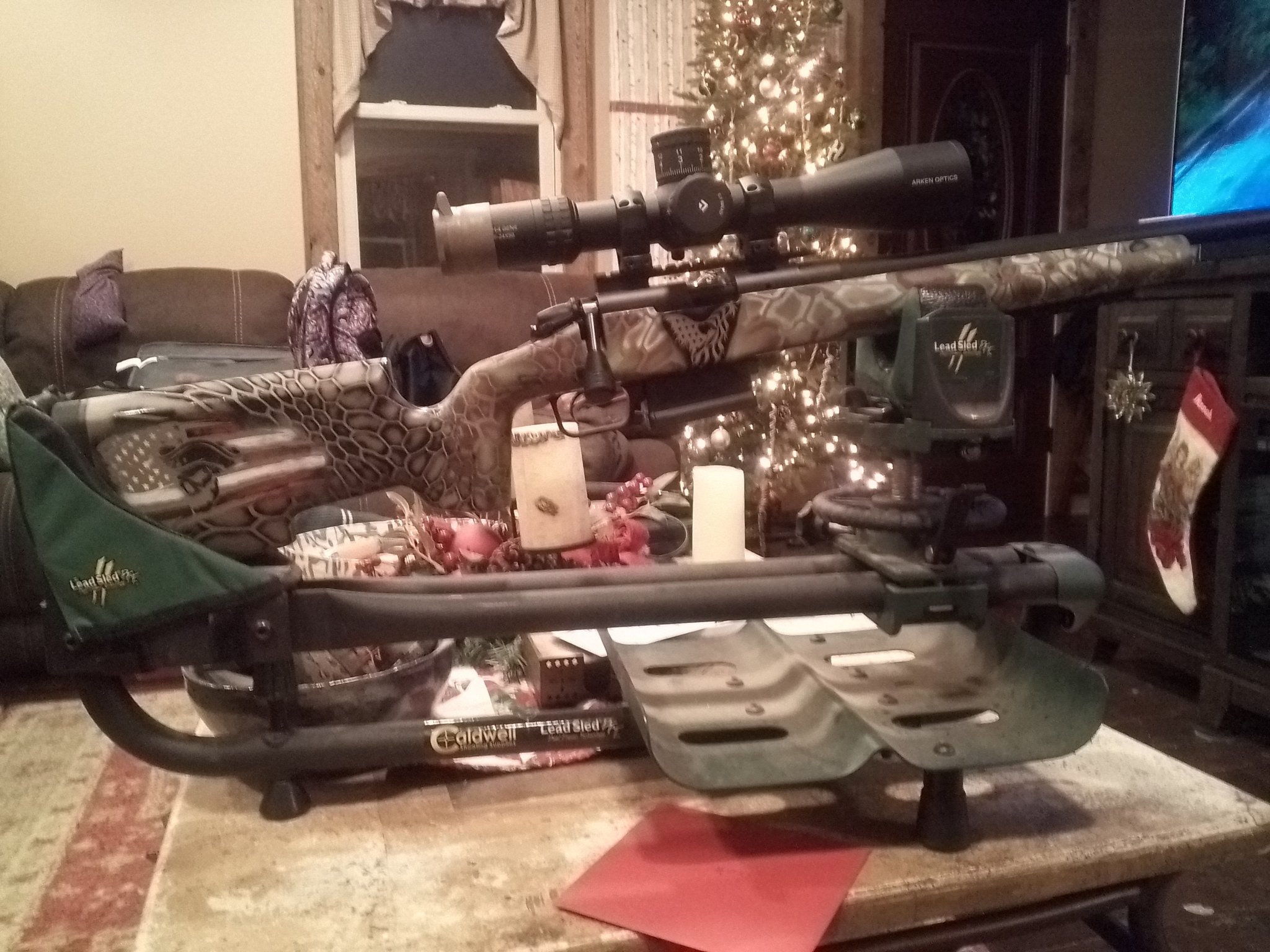

Bergara BR14 R Barreled Action
Styger
Feb 23, 2018
53
30
Picked up a steel Barreled Action from GB. Installed in a Grayboe renegade stock I had with Grayboe's M5 BM. Trigger out of the box is great very clean and crisp. Very surprised based on reviews but maybe I lucked out. Mounted an Arken SH4 6-24 GEN2 with their medium mounts on an EGW 30 MOA rail. Looked a little high but it sighted in at 50 yards .5 mil of being bottomed out so I should have the whole range available for elevation to range. Range update to come.

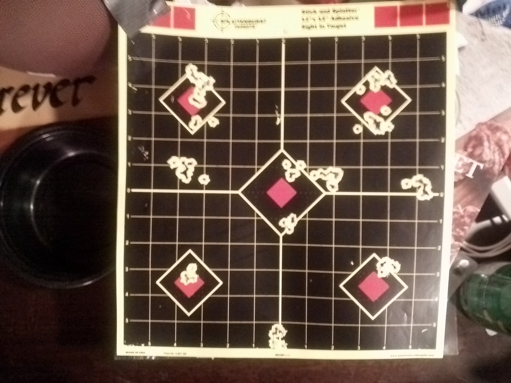

Not sure how to break in a 22 but I cleaned it thoroughly. Decided to shoot a bunch of CCI standard velocity before I shoot all of the good stuff to see what it prefers. May shoot a full brick? The gun won't load properly unless I keep pressure on the mag from to keep the round pointing up. Slight pressure and it loads flawlessly. No pressure and the round hits low and shears the lead severely.
The top left target had 4 10 round groups shot at slightly different aiming points. I was not expecting accuracy like this from ammo I've had laying around for more than 10 years. If I had gone Rim X or Vudoo I would have been happy. With the B14 at $650 I'm stoked. There were multiple 10 round 50 yard groups under .5 inch. After watching a ton of YT videos of precision shooters with 22lr I'm happy with these results. Shot off of a small front bag only. Hopefully it shoots some of the expensive stuff even better.
Search both here and rimfire central on methods to fix your ammo feeding issue. It's common issue with all of the rimfires using AICS-style magazines. It could be as easy as easy as re-install/torque your action and bottom metal with the magazine installed or as involved as tuning the magazine itself. I had a similar issue with my B14r and Grayboe bottom metal. Any pressure on the front of the magazine (like a barricade or front bag) and I would get a hung round.

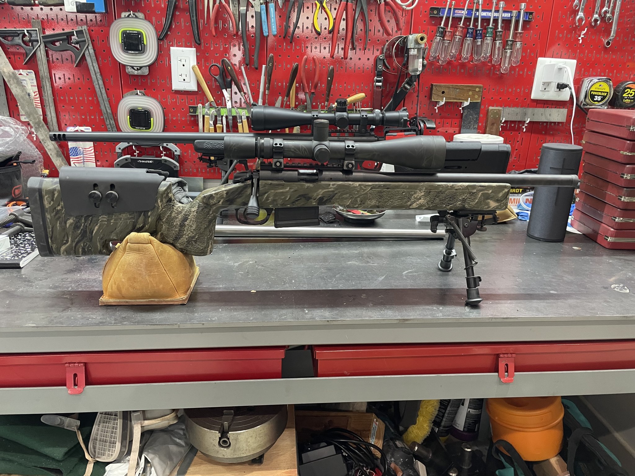

I have my Bergara in a Bravo chassis. I had to tighten up the front stock portion and adjust the trigger guard but now it feeds great.
