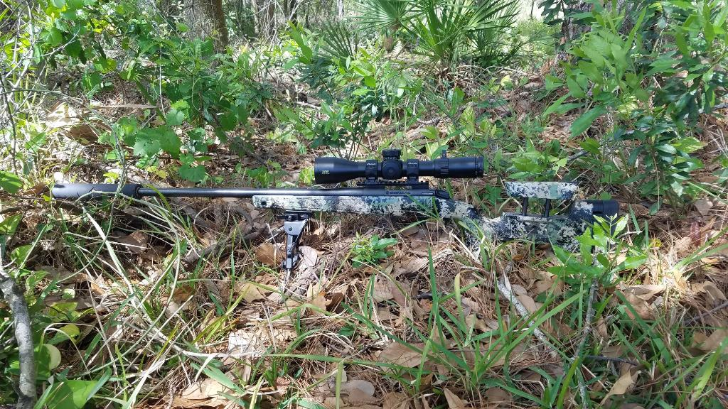

    Looks great. Am wondering if that cheek riser is comfortable for you. I don't think I've ever seen one that high up before, especially with normal height rings.
    Yea fits like a glove had to modify to get it that high the bottom of the posts are threaded buddy who painted it dropped some bolts in and voila extended. Had a horrible home made setup that worked ok since last fall, but wanted a permanent solution that didn't wiggle on me. I have -8.5x glasses and I can only see 20/20 through the dead center of them...have to keep my head quite upright. I also have really high cheek bones....add that up and it's a weirdo setup:/ Bench only simply can't shoot prone at this stage in the game. Not really that important to me to shoot prone jsut so i'm out there with the boys having fun. Getting my cataract surgery here in the next couple of years so will revisit prone at that time.
