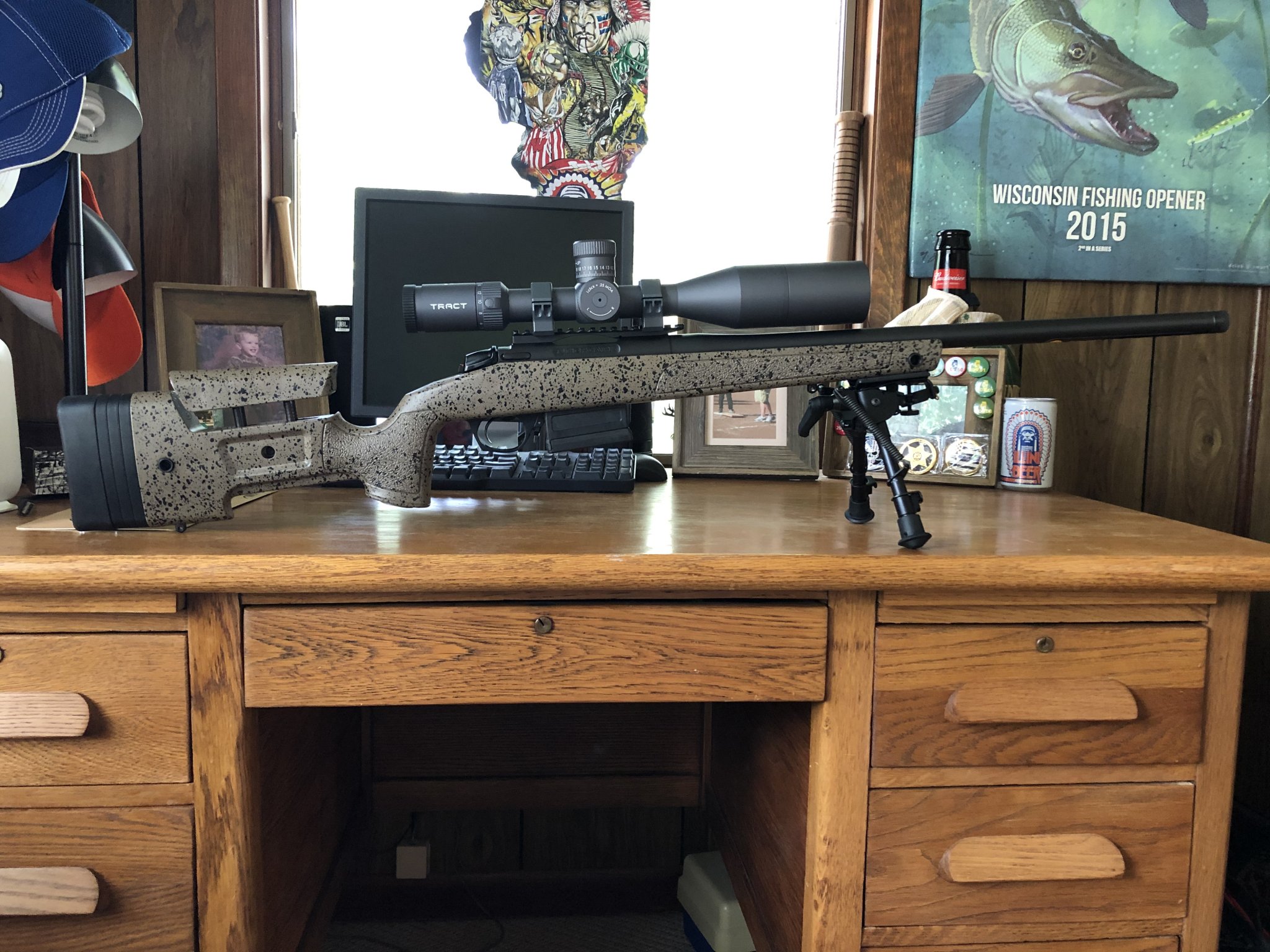

Just picked up my HMR in 6.5CM and am going to mount a Tract Toric UHD 30MM 4-20X50 w/ Iota rings on a 20moa Area 419 base. I’ve read here and elsewhere about new barrel break-in. Reread the owners manual and found the method they suggest.
Should I use the cheaper 125g Winchester hunting rounds from Walmart and save the 140-143-147g Hornady to see what the gun likes/sight in? Thanks in advance.

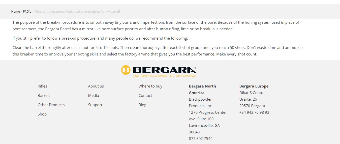

I went ahead and broke mine in even know their website shows this:
I did the fire/clean x5, fire 5/clean x5, fire 10/clean x2. That gave me 50 rounds of fire formed brass. Was it needed? Not sure. My old man would have come out of grave and kicked my ass if I didn't, so I did. I always have.
If you are going to reload, I would load or buy some quality match ammo for the break in. That way you have the fire formed brass. If not, I'd go as cheap as you can.
