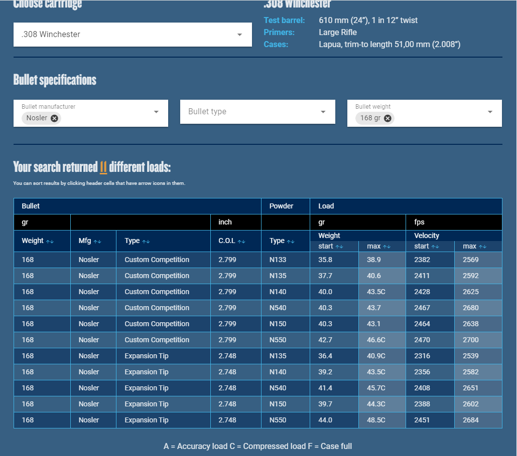

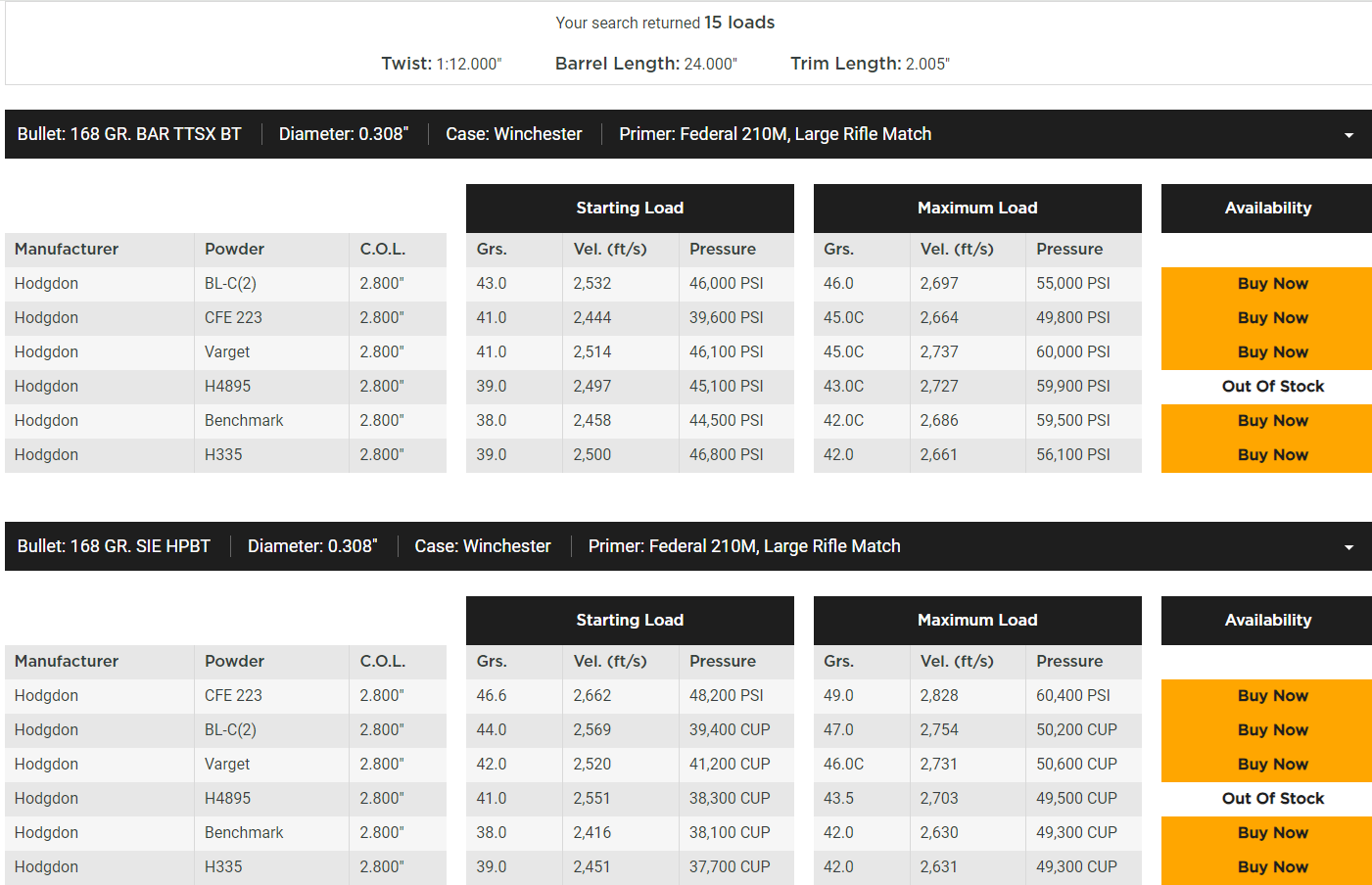

Not sure if you have seen all the below data, but your 168 ABLR isn't listed as often as the more popular ones. Still, you will get a decent idea of how these powders run under other 168 grain bullets from these data.
The CFE certainly can generate some speed, and it is very easy to meter, but in general experience it isn't as competitive as an extruded powder like H4895. On the other hand, there is something to be said for a bird in hand since H4895 has been unobtanium for a while now.
