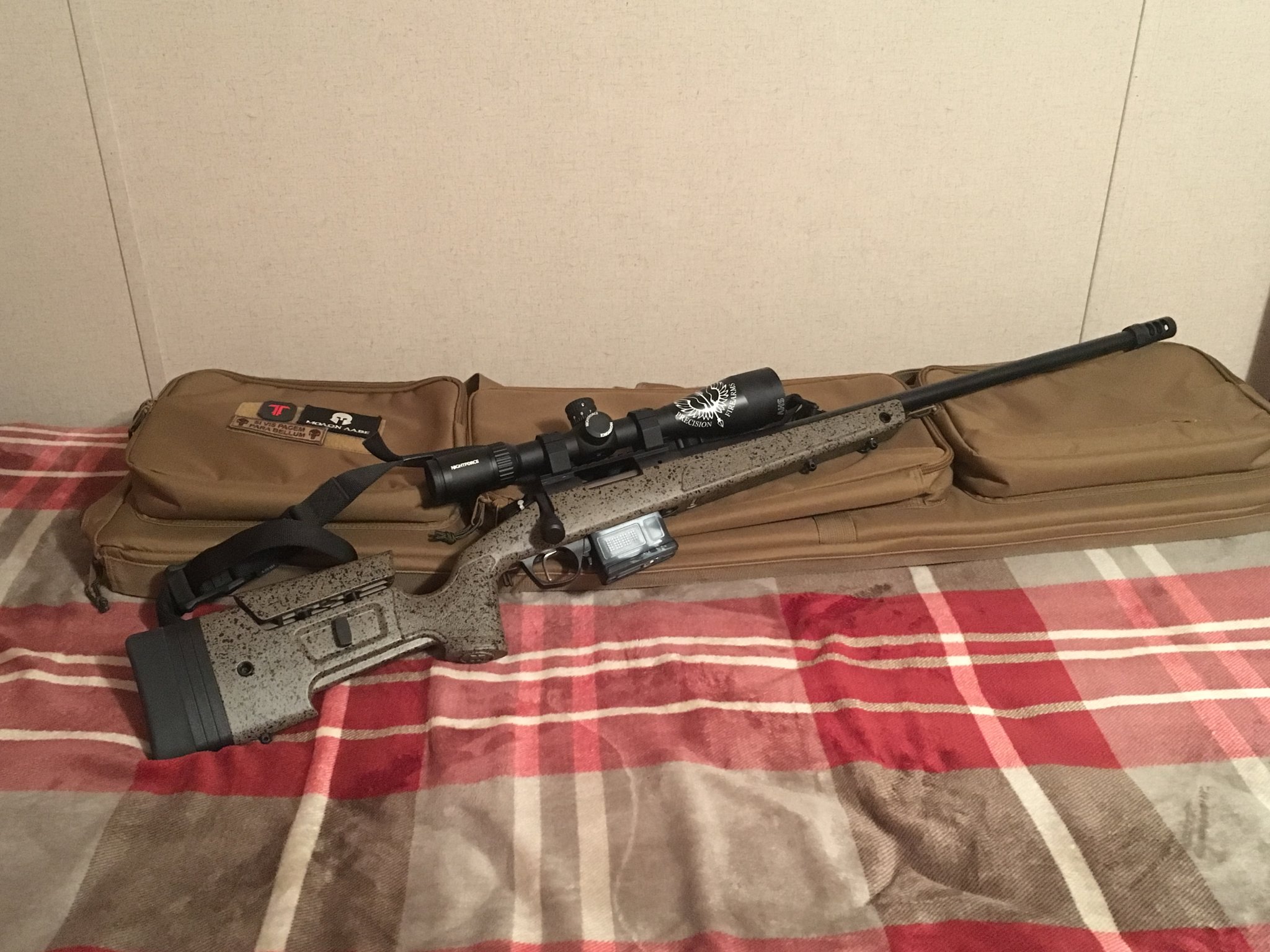

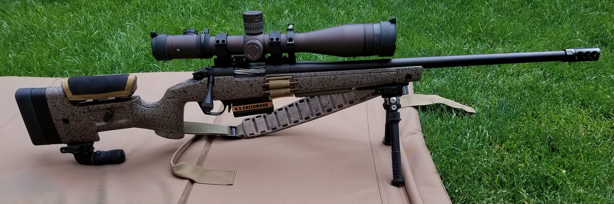

I eventually ended up ordering the fluted Bergara Premier SA bolt for it because of the lighter firing pin and ease of disassembly, and replaced the Bergara trigger with a TriggerTech Special, not because the trigger was bad but because I like the TriggerTechs. I also added a Patriot Valley Arms 6.5 Creedmoor Jet Blast muzzle brake, and a Wiebad stock mini pad for the cheekriser which feels better on the skin when it's cold. As for factory ammo mine especially likes the Federal Gold Medal Match Berger, 130gr. and the Hornady Match and Precision Hunter ammo in the 140s gr. range. Heard from some that American Gunner shoots just fine, others not, each barrel is different in what ammo it likes but that is not unique to Bergaras but goes for all brands. If you get a throw lever for whatever scope you mount the 90 degree bolt throw can conflict with the lever set to low mag other than that using bore shine before the actual break in minimized my clean up afterwards compared to my B14 .300 WinMag. that's about all I can think of right off the bat.

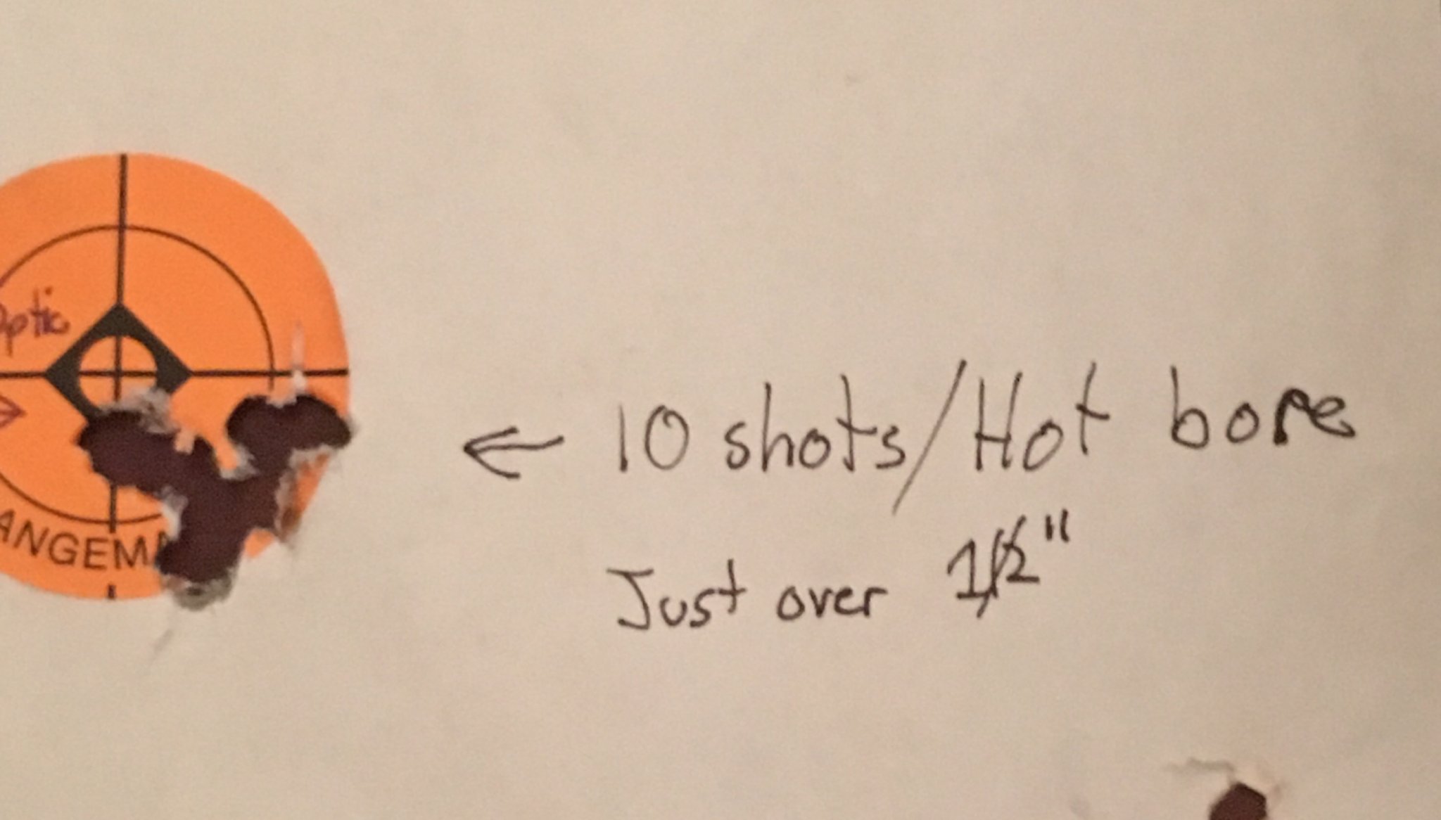

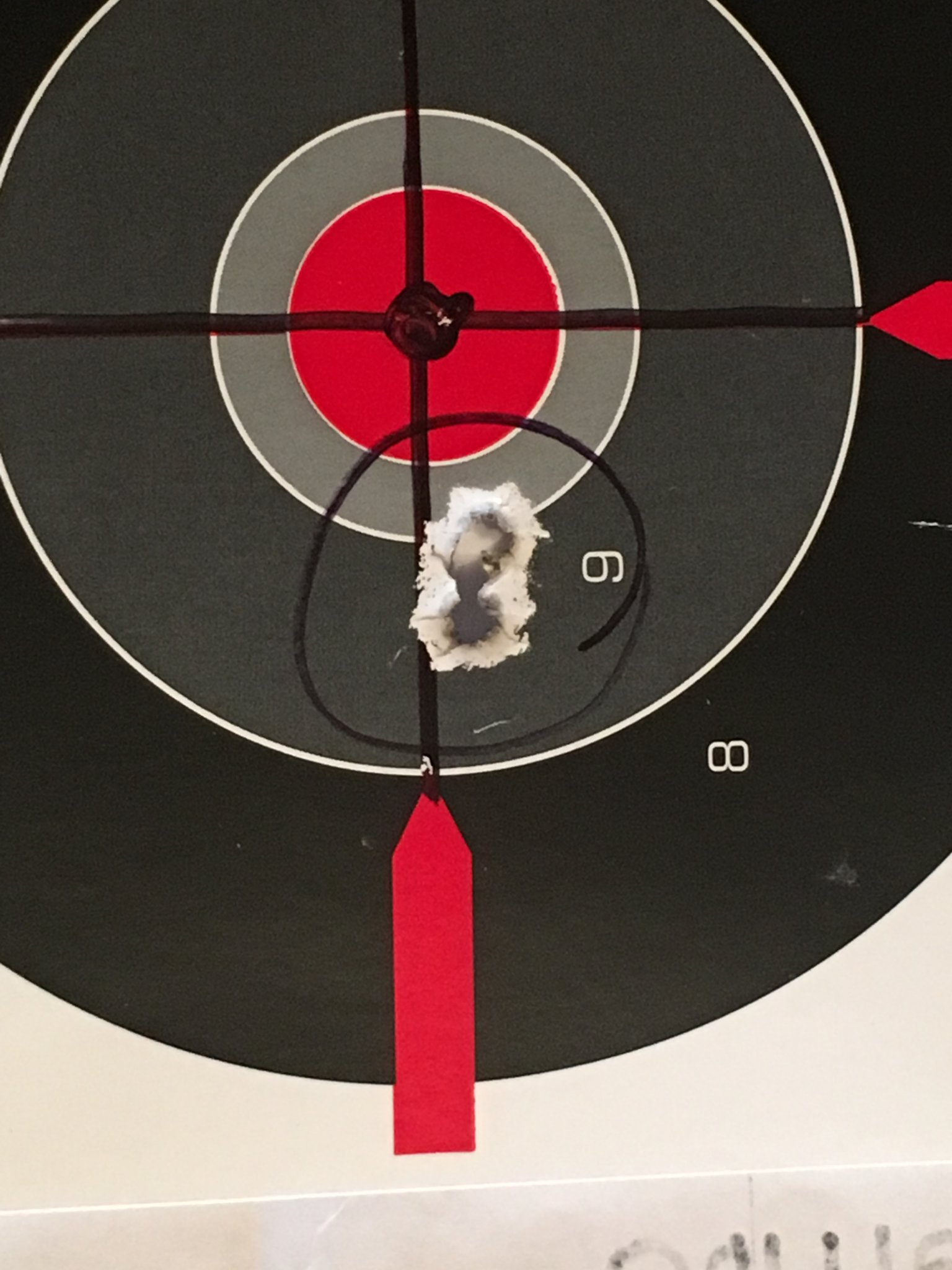

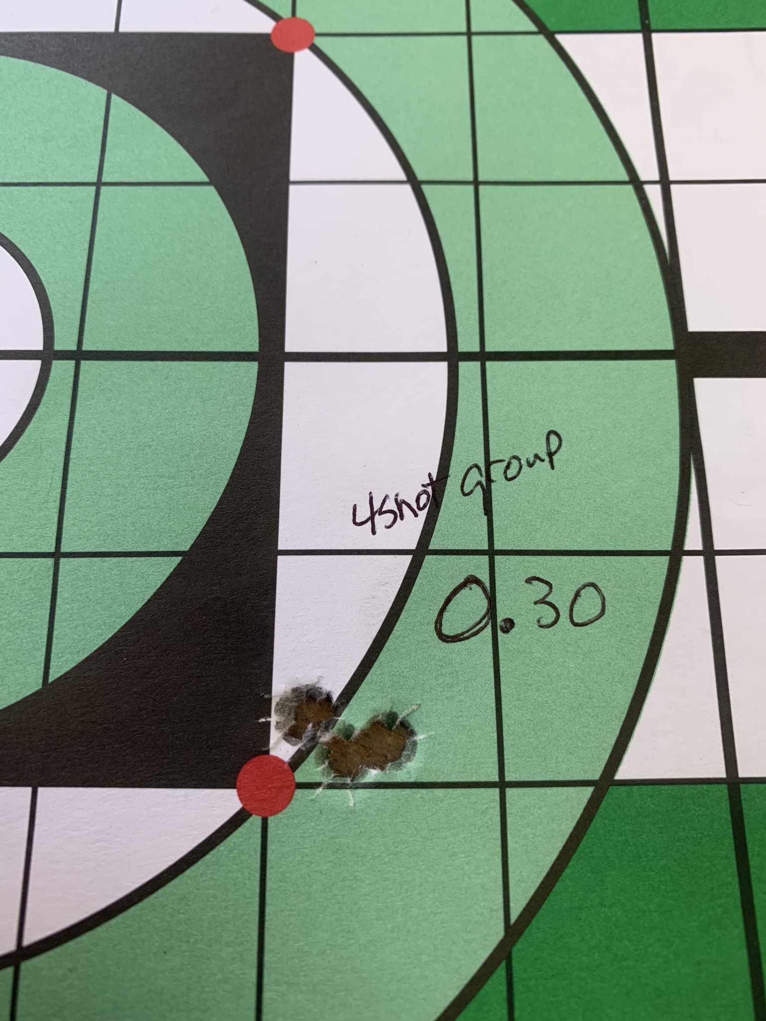

In my experience, it will shift zero a little bit after it gets hot but accuracy does not fall off. The best factory ammo for mine was federal Gold Metal match 130gr berger. It would do good to ad a trigger tech special, I did
these groups are hand loads

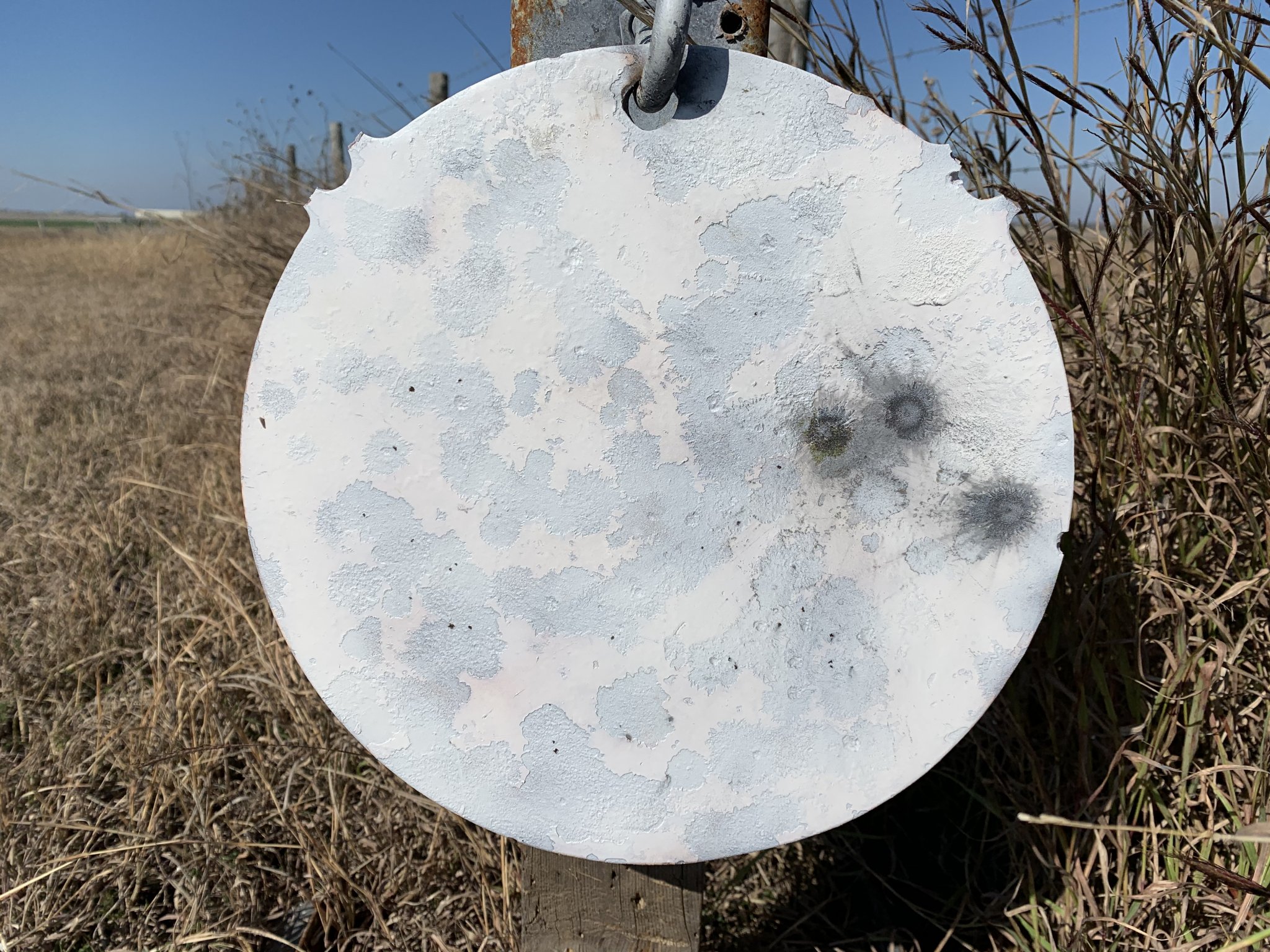

I’m pretty happy with this thing. Bought it from another Hide member and picked it up last Friday. I got it on paper at 100yds and then took a few shots on one of my plates at 270yds. Once my neighbor moves his cows out of the field next to me I’ll be able to push the plate back farther.
This is just Hornady American Gunner 140gr. I’m excited to see how things tighten up with match grade stuff or had loads if I eventually start reloading.
