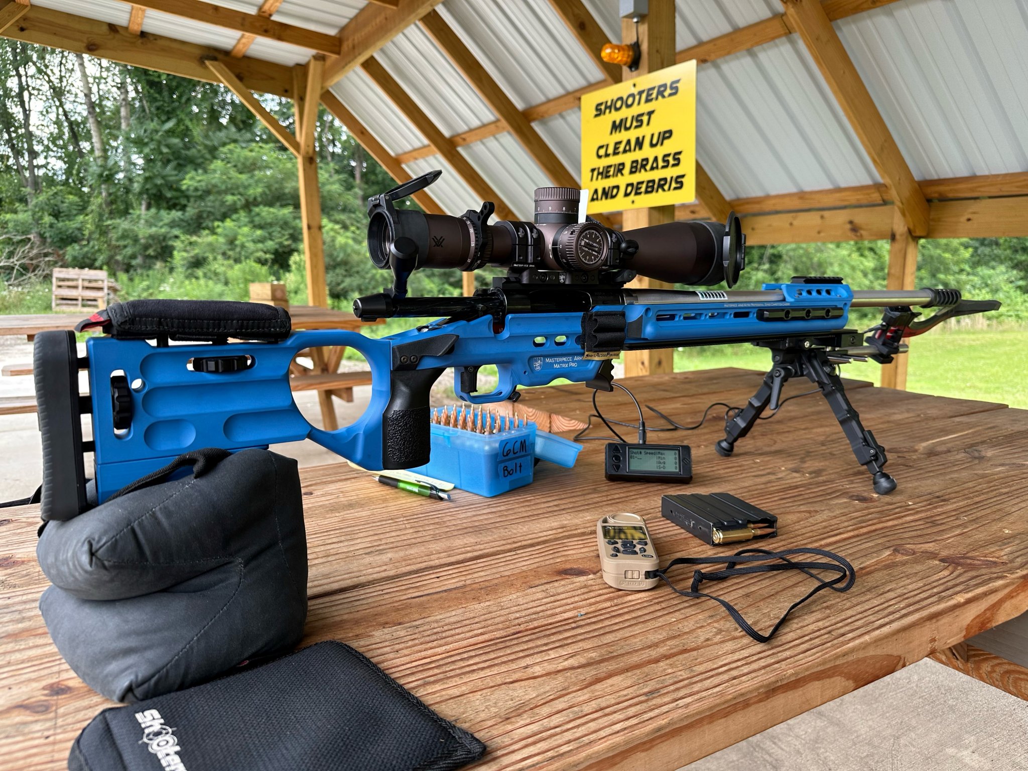

I'll repeat what others have already said, yes you can install and remove a barrel with a couple basic tools. No gunsmith needed. I've done it several times to my Origin. A pic of mine is attached. If you go the route of Origin and prefit barrel, those are available now. If you like the MPA chassis options (I do as well and use the MPA Matrix Pro chassis), you can keep an eye on the PX in this site for used or sometimes nearly new chassis for sale.
I'd suggest finding someone near you that has a 300 PRC and ask to shoot it so you can get an idea of the recoil before you purchase a rifle or build one.
