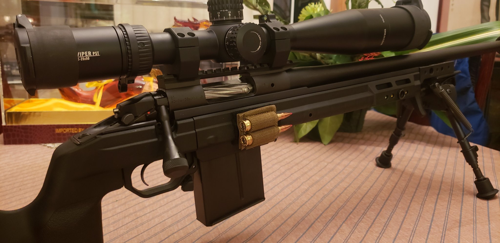

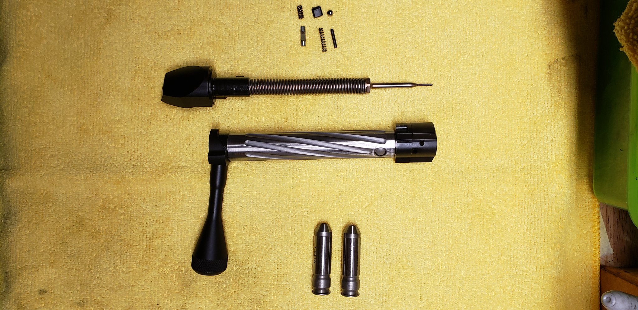

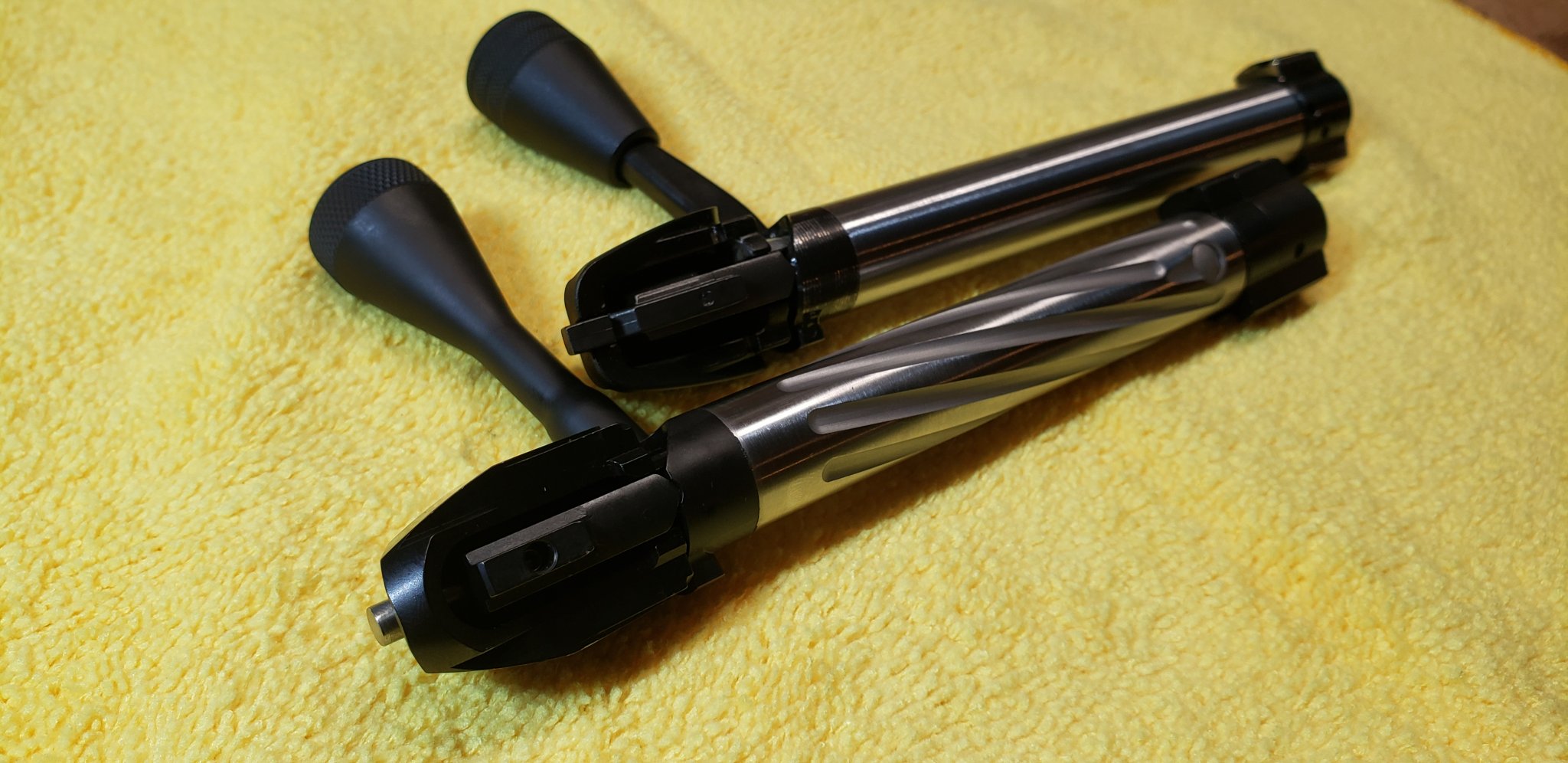

Been running it for quite some time now, together with the TriggerTech Special some of the best money I ever spent on my Bergara B14 and yes it is a drop in and I verified it with my own Go/No-Go gauges on my HMR. The action does benefit from working the bolt back and forth for as long as you feel you want to do it and will get much smoother, don't forget to give it a proper lube before though.
Lookin' good! How do you like it? Have you taken it to the range yet? Looks like it was made for the Bravo.

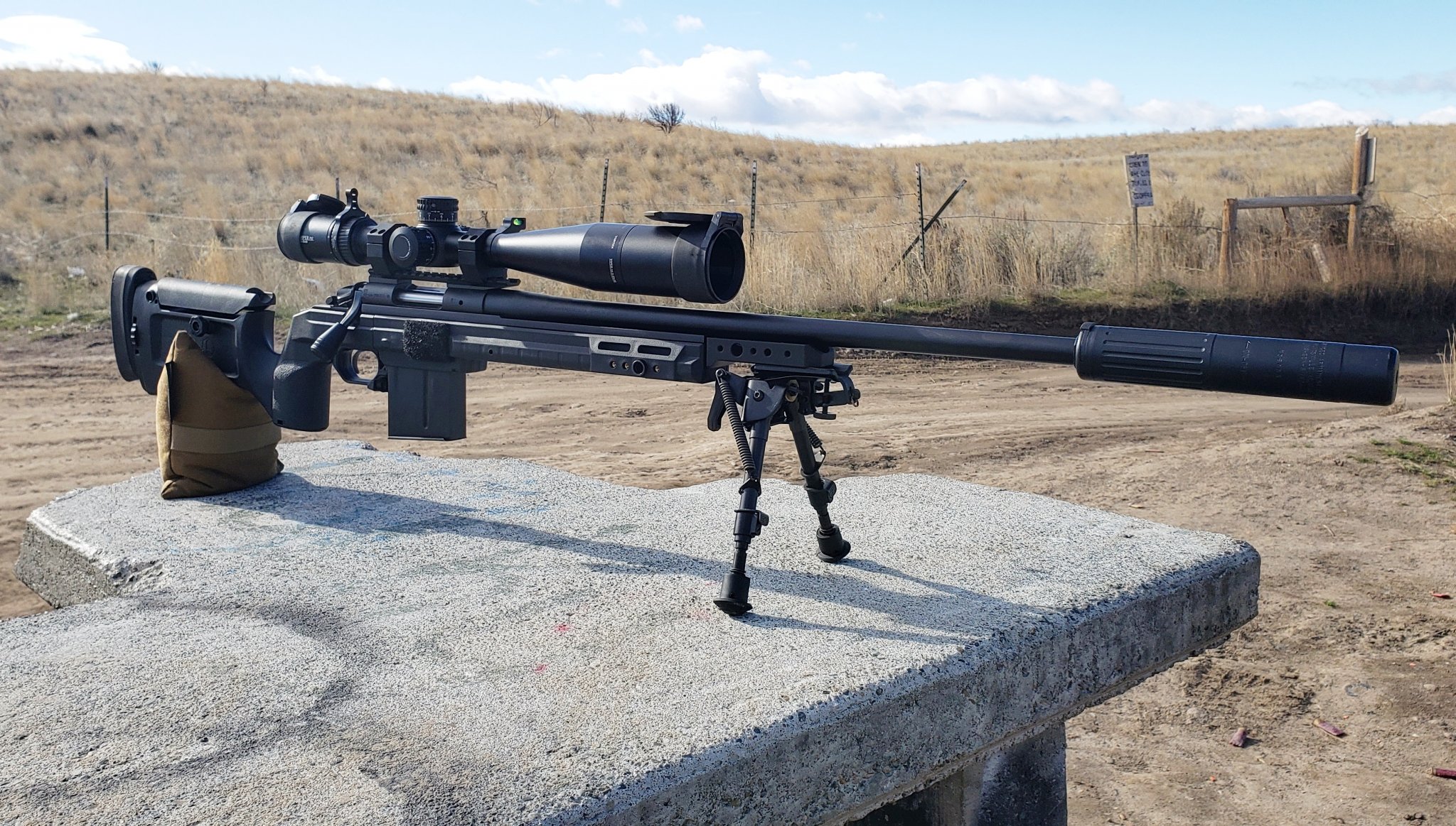

Thanks. Not yet, I was banging a gong at 1000m on Saturday afternnoon in 20mph winds. Made the day quite challenging and interesting. Came home and saw the mailman had delivered the bolt to my doorstep.

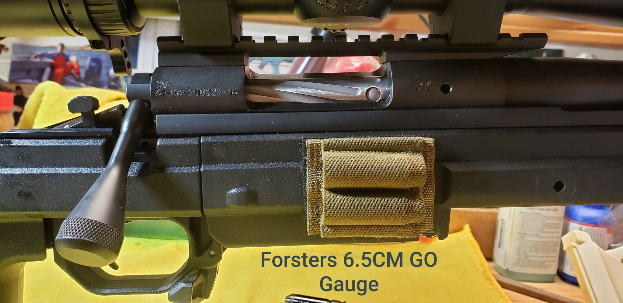

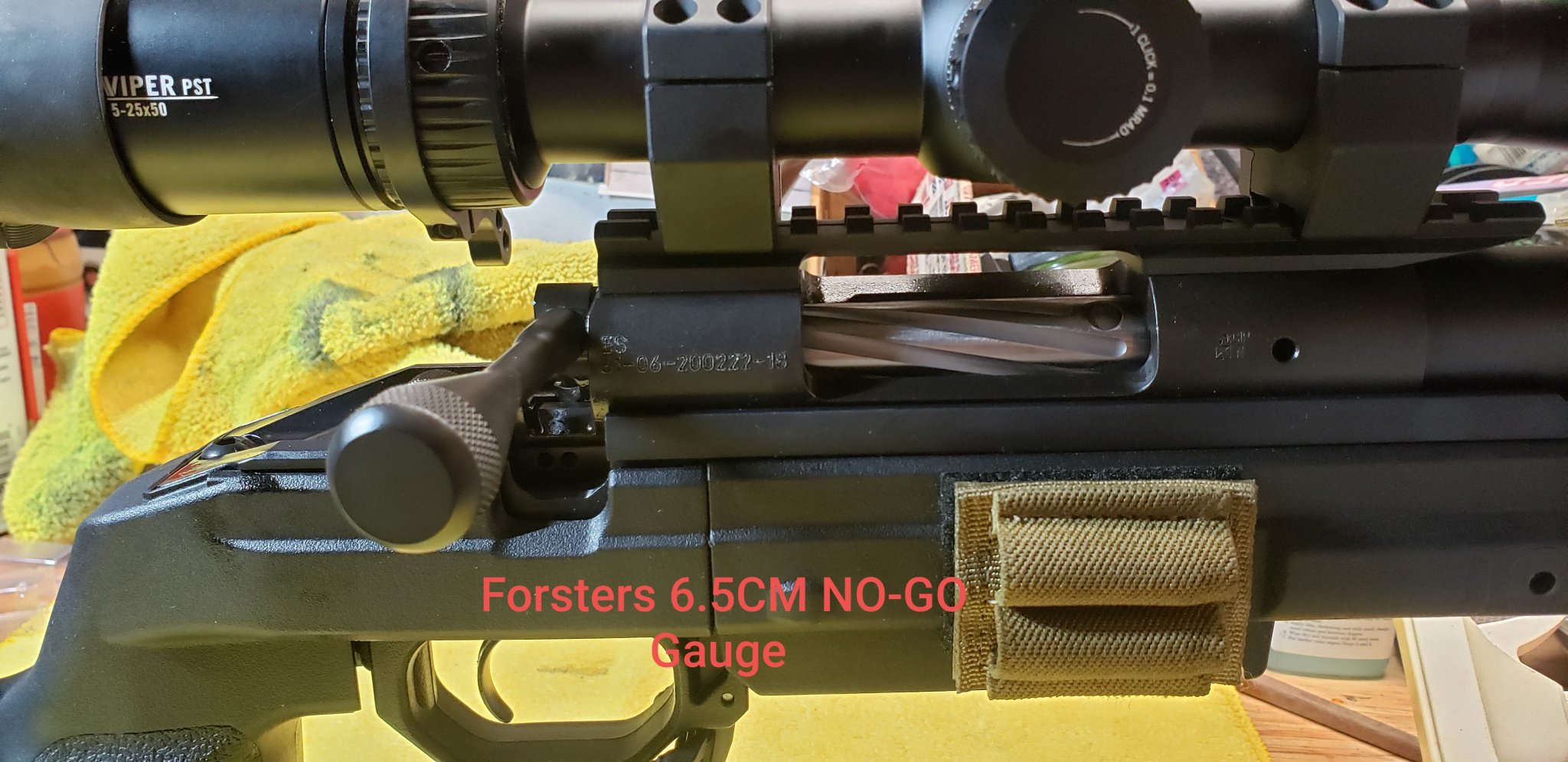

Even though Bergara states the Premier is a drop-in bolt I still ordered a set of Forsters headspace gauges to double check myself. Did you have to remove the firing pin, extractor, and ejection when you did the headspace check?
Reactions: floridajpr

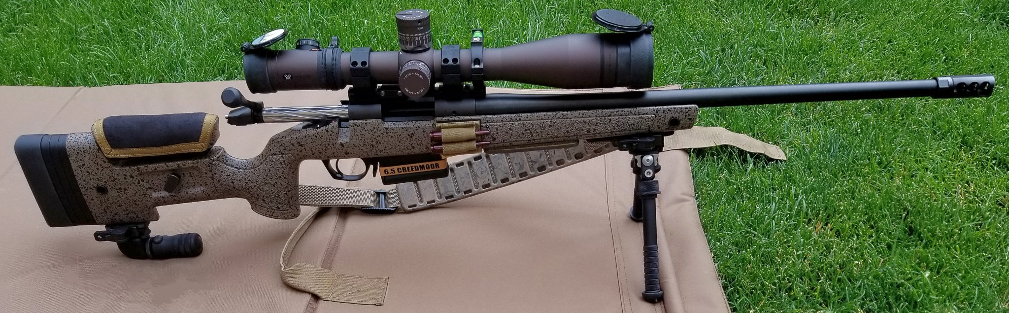

Just to confirm that Bergara is correct, their Premier Series bolt will drop into the standard HMR, headspace unaffected. I did a headspace check with a new set of Forsters 6.5cm go/no-go gauges.
Bolt closed without effort on go gauge.
Bolt will not close at all on no-go gauge.

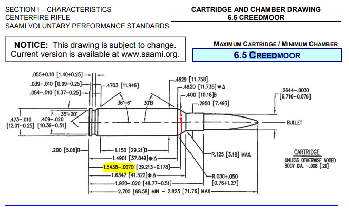

So a chamber is created with a reamer, that reamers geometry is fixed, the reamer wont change, so youre stuck with the shape, all you can really control is how deep you insert the reamer into the barrel during the process of chambering the barrel. Headspace is basically a measure of how deep the reamer was inserted into the barrel indicated by the shoulder (which is at an angle).
Saami is a governing body and they publish some charts, in those charts are specs. In this chart they published for the 6.5 creed you will see that the red line is on basically the middle of the shoulder. That red line is on the datum plane where the shoulder diameter is exactly .400" (datum explained below). So basically we are measuring from that datum plane at .400" all the way back to the bottom of the case. Which should be a max of 1.5438" and up to .007" below that meaning anywhere from 1.5438" to 1.5368" deep is in spec.
So to measure from the angled surface of the shoulder back to the case head is tough. What we are really wanting is to measure the distance between two flat parallel planes. The first datum plane of reference is the base of the case which is nice and flat and easy, the second datum plane of reference will need to be at some point on the shoulders. Because the shoulders are a cone, a circle tool with a given diameter will allow us to settle into exactly the same location on the shoulders evenly all around consistently each time. So we create a datum diameter (.400" as example for a bunch of chamberings) and that will allow us to measure the same spot on the shoulders consistently back to the case head which is basically how deeply the reamer was inserted.​

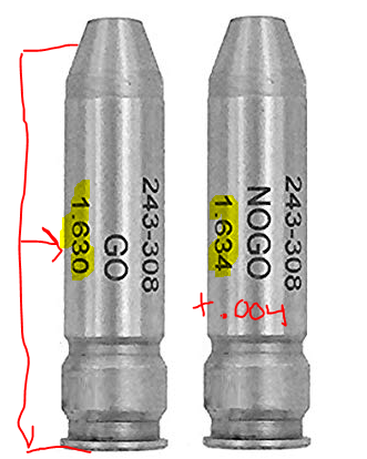

What a go gauge does is act as a depth gauge. It is preciously cut to a certain distance between the case head where the bolt touches the case and the chambers shoulder. When you insert the go gauge you want it to close on the go gauge so that you know the chambers is cut adequately deep/long. When you insert the no go gauge, which is slightly longer than go, you want the bolt to stop short of closing so that you know the chamber isnt cut overly deep/long. This guarantees that you are firmly inside the spec designed for that ammo.
Being slightly long isnt the worst thing in the world and actually guarantees it will function with dirt and grime etc, AI is a great example if this as they cut their chambers slightly long so the inspec ammo will always chamber in the rifle during war even if the rifle falls in the sand and mud and ice.
But there is one more gauge that is called a field gauge which is even longer still and is designed for the actual safety check. I fit passes on the field then you need to get the case checked because its wayy too deep and can lead to brass cases cracking and stretching and just not great stuff at 60k psi.
But for a rifle that Im not doing war with Id rather have a tighter chamber that falls inside the go and no go parameters and limits the amount of deformation that is imparted on the case during firing, too much stretch can split brass and do all sorts of nasty things but it can also stretch a fair amount safely if you dont over do it, its how ackley improved chamber brass is made and its called fire forming.

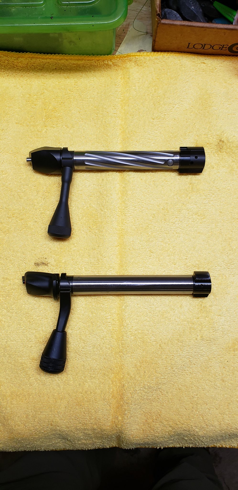

In my case, the small FP was what I needed. Others have said the bolt fluting was an advantage in dusty conditions. There may (or may not) be others I don't know about.

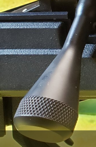

It looks like the bolt knob is all one piece, so I assume it's R700-esque in that it's not replaceable without cutting and threading? I wonder why they would do that on the high end option when the low end option is threaded already.
The bolt knobs are still threaded.

B-14 is built, Premier is over build.
And yes, the picture is deceiving. That knob is threaded on.

Just to add a little bit to the discussion of why excessive headspace is bad-
When the firing pin strikes the primer it pushes the entire cartridge forward. The round is pushed all the way forward until the shoulder hits the front of the chamber (datum points shown above). When the primer and powder ignite the brass case is forced outwards against the chamber walls. The extreme pressure causes the case to stick to chamber walls throughout the firing cycle. The pressure in the case forces the head back until it contacts the bolt face. Because the walls of the case are pinned to the walls of the chamber by the extreme pressure the unsupported area just above the extractor groove (the "web") is forced to stretch. In a properly headspaced rifle the web only stretches a few thousandths of an inch which is fine. With excessive headspace (chamber cut to deep/long) the web stretches farther than it should which can cause it to thin over time until it fails (reloading), or fail catastrophically which can cause severe injury, damage to the gun, or potentially death. So yes, get it fixed.

Hey fellers,
Just sent in my 2016 b14 bmp with the up dated premier bolt to get checked out. Here is the issue I was having. Cold bore shots, maybe slow and go, no sticky bolt. But if I heated the barrel up with quick successive firing, each time I put one into the chamber it kept getting tighter and tighter, same with extraction. The gun smith called me back this morning, June 30th and said hey, can't find any problems with putting 5 down. I told him to put about 10 or more fast and it'll rear it's ugly head. These are not just drop ins, if one is doing rapid fire. Like their bolt shroud/hood on the original bolt that had an issue, (mine included), not everyone was faced with it. My old bolt was working just fine after the new shroud. One of the reasons for changing was I could only get the trigger down to what Bergara set as the low limit, 2.5lbs. Their reason was, the original bolt spring was so strong that anything under 2lbs could be dangerous. That is one of the reasons for the deep cratering of primers in the first place. Even had one spray back at me one time. Another fellow i ran into had many problems with the same, sent his entire rifle in twice to Bergara to get checked/fixed. I changed the bolt to a trigger Tech Diamond so that I could get my trigger weight down, in doing so I needed a bolt with a lighter spring pressure, the premier was that bolt. I have been in discussion with a few heads on the subject about head spacing, it would only make sense to at least get it checked or if one is capable, do it yourself. I believe the true test is run a box of ammo down the tube fairly fast and then make a decision. It would show up once the barrel starts to heat up.
Hey fellers,
Any updates on this issue?
Reactions: LoCal247
Hey fellers,
So did your gunsmith confirm the problem with the premier bolt? So drop in ready is not true?
