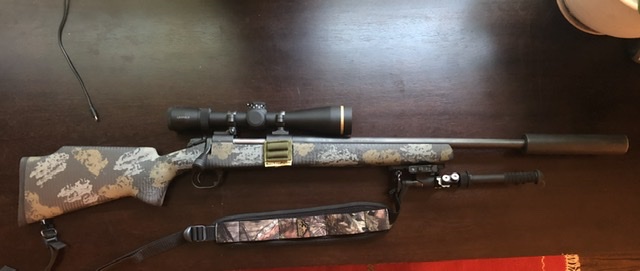

Just got my Ridge in 7mm Mag on Friday and wanted to share an overview and initial impressions.
Overview: this gun bridges the gap between a dedicated long range rifle and a hunting rifle that most varment rifles just can't do. These past few years there has been a lot of movement in the industry surrounding long range shooting and in turn, long range hunting. This rifle along with a few others have hit the shelves in 2017-2018, comparatively at its price point and the Bergara is no slouch being easily found for under $750.
First impressions: it's awesome, well balanced, well built, heavy enough barrel to do any task but light enough that I'm not afraid to hike with it on an Elk hunt. The trigger has no take up (except when you're on safe for some reason) and will do just fine for field work including long shots and tight groups. In all honesty the best way I can describe this gun is a remington done right. It has all the same functions as a remington but built with the finness of a browning. It's not a custom gun but the attention to detail is great. When cocking the bolt lift is very smooth, smoother than any off the shelf hunting rifle I've owned or have handled.
What I would have liked to have seen is a stock that isn't only harmonically sound but actually fits the rifles application. There is no reason in 2018 we should still be using a stock that is built for iron sights with an awful grip angle. Even a basic M40 stock wouldn't be that hard to mold.
June is a busy month for me but I should be doing load development in July. Excited to see how it shoots and handles. So far I can't see off hand shots being a problem. If you guys have a Ridge and would like to chime and share your experience feel free!

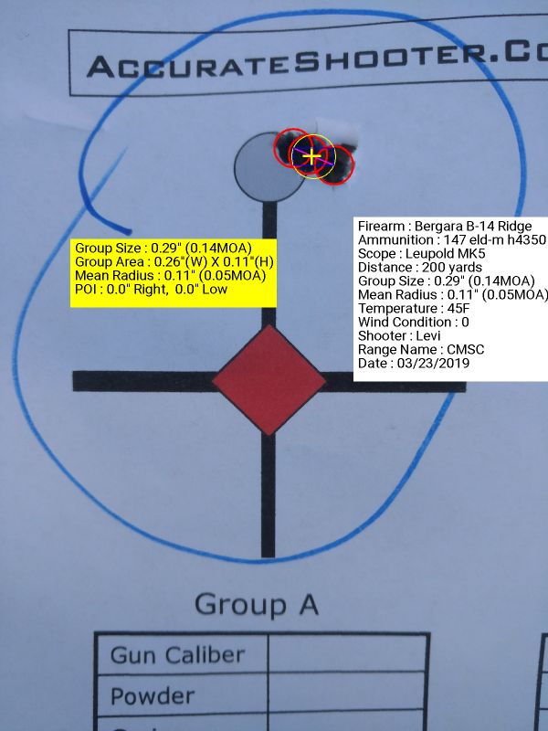

Even the loads it doesn't like it barely breeches 1moa. The ones it does like are stellar. (I know it's 3 shot, load development, I'll get more as the weather gets nicer in MT).
I agree the bergara ridge is a awesome rifle! My 300 wm ridge shoots .5 moa at 100 yards! The action is smooth and has proven to be reliable and the trigger is great!

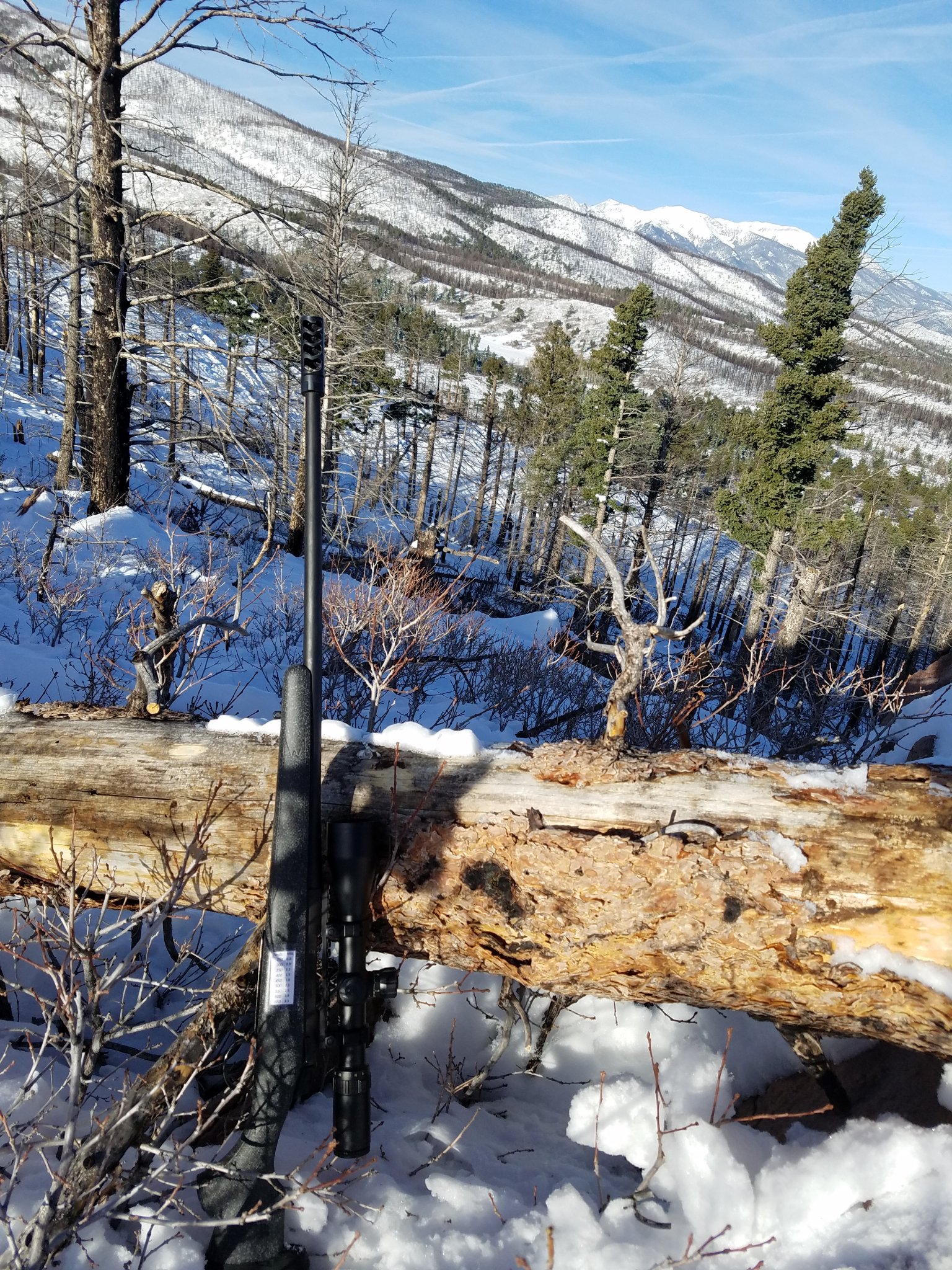

The ridge has been a great gun. And it does what it claims to do quite well. That being said its been a while sinse id bought a dedicated hunting rifle and if i were to do it again I think I would have gone with the hunter.
Let me explain... the load I settled on shot great but only for 3 shots. I did all of my load development with 5 shot groups and the gun just wasnt happy. Although I have been told that despite the "slow" twist rate the gun will handle 180's quite well. My load was using the 162gr eldx and h1000. I did confirm that the barrel was heating and causing my groups to open. Attached is a picture of a group I shot at 489 yards. The squares are 1".
So part of my thought was that if the barrel would heat up enough to cause groups to open in 3 shots then I should have just gone with the hunter and saved my body humping that thing 10 miles a day through the mountains.
I was able to speak to Dan about the design of the stock a bit and they may have worked on it for 2020, we'll see. I used a yoga mat and hockey tape and it worked out just fine.
Im hoping to rework a load for it this summer using 180's in hopes that I can find a more stable load. I felt confident to take game at 600~ but I'd like to extend that a bit futher.
I think if I were to do it over I would stick with a short action caliber for the ridge or go with the hunter. We'll see where this next season takes me! Im willing to give it another fair shot!

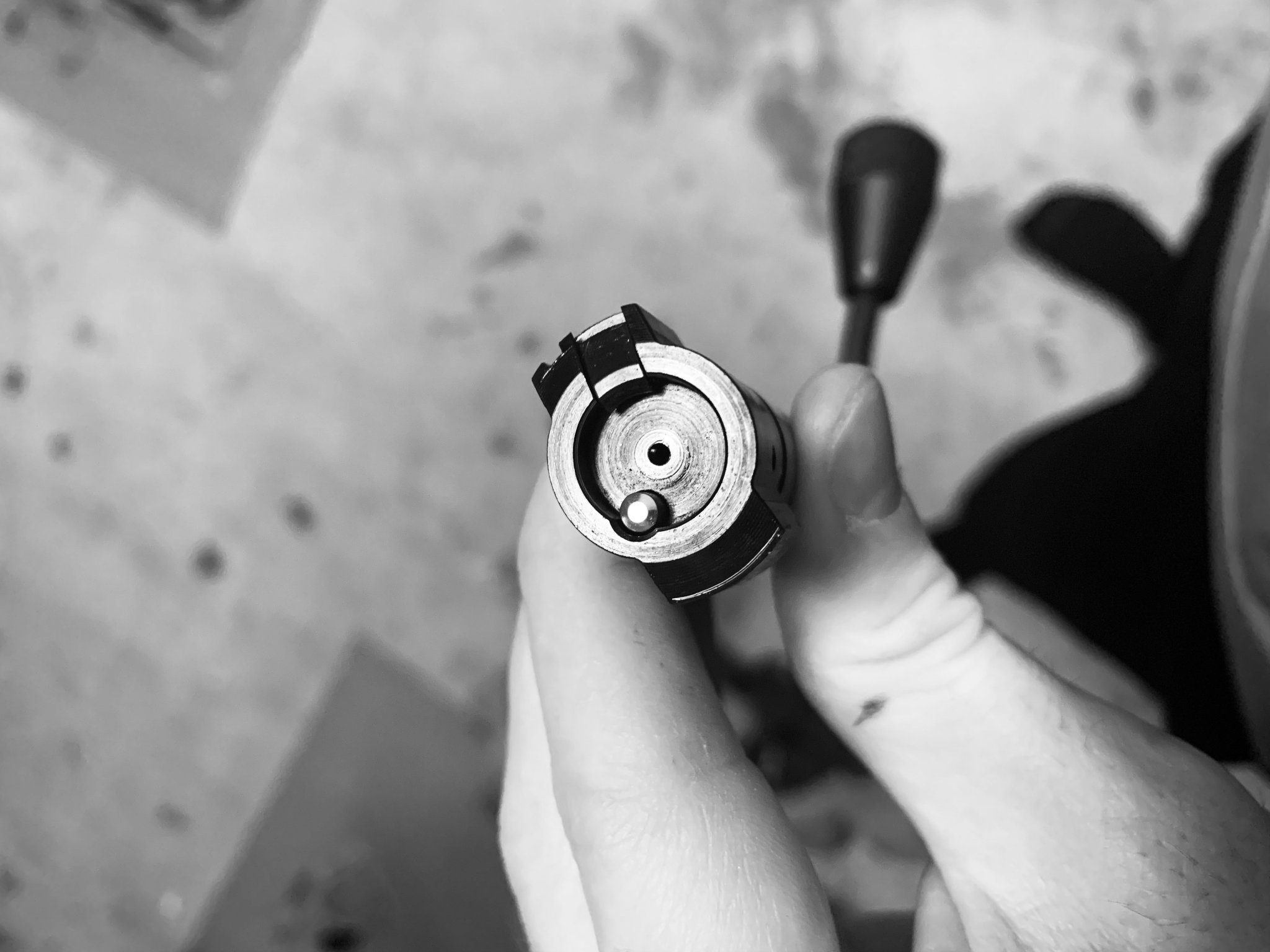

Initial impressions are good, bolt is very slick/smooth. Bolt lift is quite light, bolt close is heavy to me and seems to be a decent amount of cock on close, may get better with an aftermarket trigger may not. I hesitate to have it torn down for timing work as it shouldn’t be an issue for what I bought this rifle for. Remind myself that if I want a custom I have to pay custom money :)
They apparently had some issues with 6.5 creeds using small primer brass blowing primers and breaking bolt shrouds as the bolts had a large firing pin. I talked to bergara and they said new creeds have been switched to a small pin. As they said, mine appears to be bushed to a small pin so that’s very nice to see.
Factory mag box appears to max out at 2.82 COAL. Berger factory 140 match is 2.81 and just barely fits. So far I’m happy with the rifle and I am really digging the short barrel. It ways 7lbs 2ounces with the 5 contour so not a lightweight, but should go well with my suppressor.

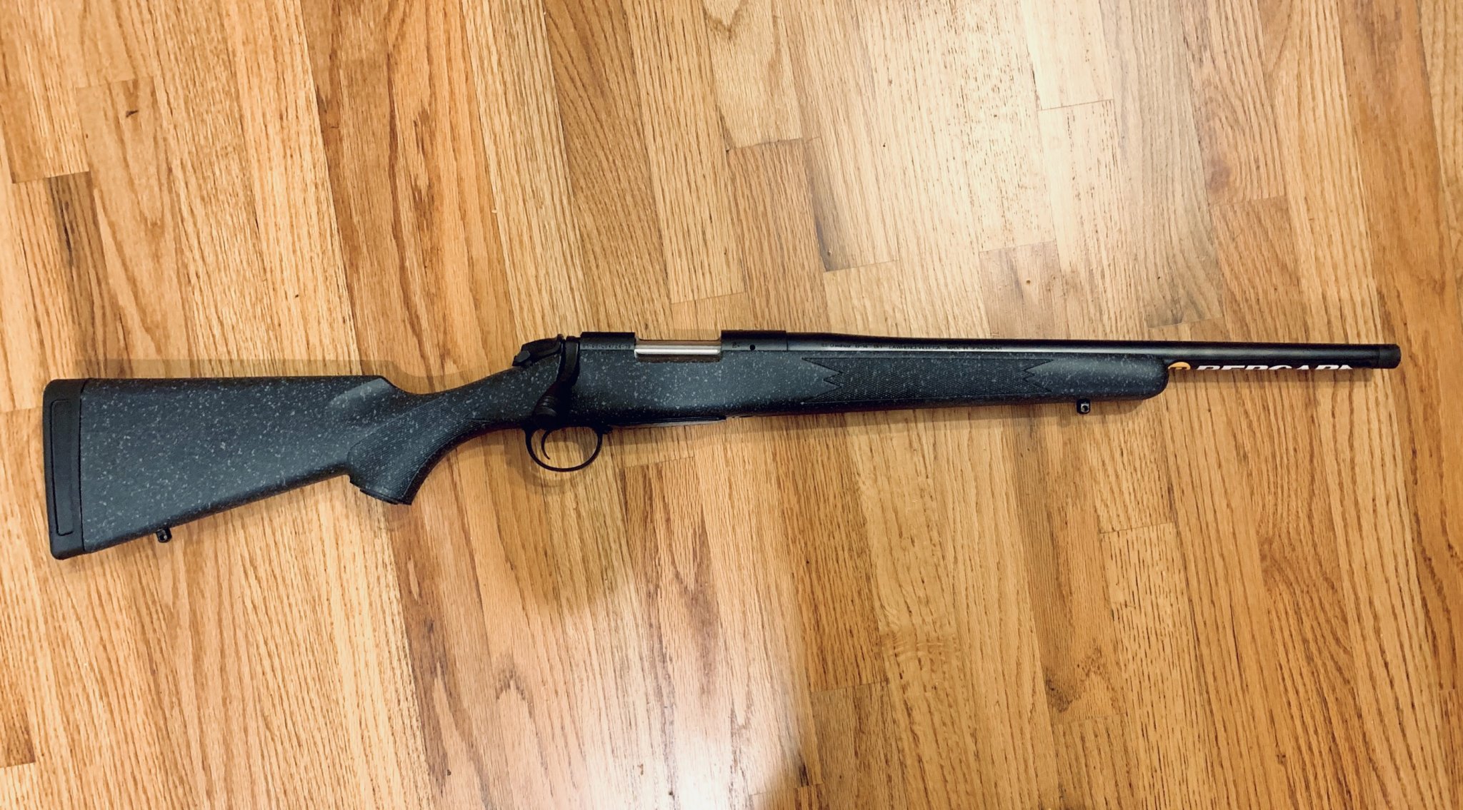

Throwing out my 2 cents on my recent ridge purchase. 6.5CM 24” barrel. Shoots 3/4moa with factory match ammo. The factory stock was surprisingly nice for a hunting gun, but the mag feed lips absolutely mangled brass out of the box. I was in the fence about a chassis anyway, so that pushed me over the edge.
With chassis and VX6HD I am at 11pounds on the nose. I bought it as a “do everything” rifle, and the barrel profile really enables the jack of all trades master of none philosophy.
If I am being perfectly honest with myself: for the coin I have in it and the weight with a chassis, I should have bought the HMR from the factory, but this thing balances perfectly and fits like a glove.
