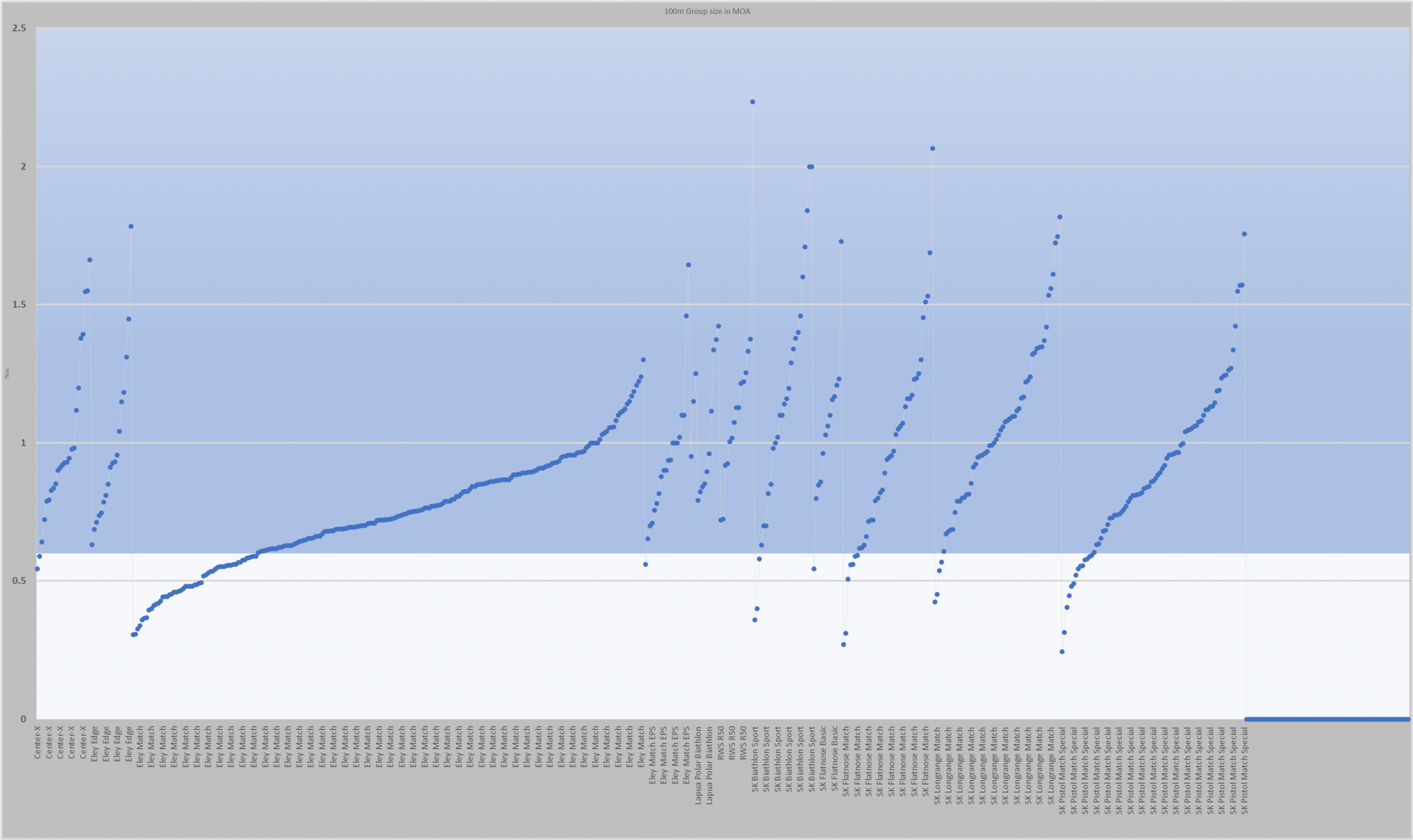

If you like to look at graphs, here are some 100m 5 shot group sizes (in MOA) plotted for several different ammo types. The 50m and velocity plots look similar.
Note i only have data from two guns so there is no guarantee that Pistol Match Special will work well for you, but several batches of it have worked very well for me.
